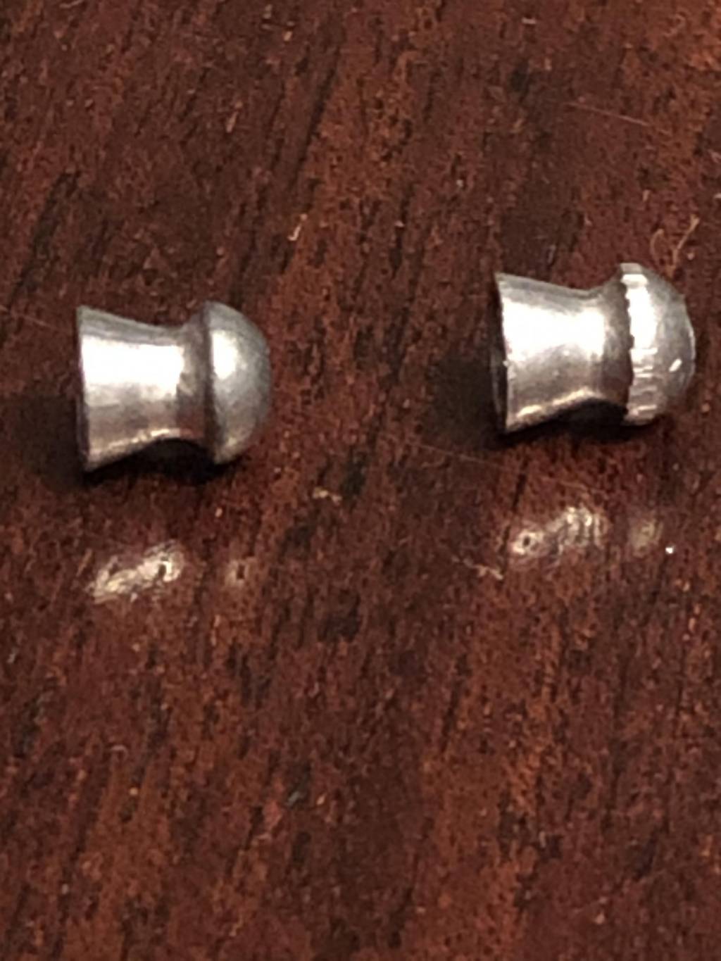

I thought I’d have a look at a loaded pellet from a G2. When I pushed it back out into the breech, I got lead flakes with it. I’m just conflicted on returning it, or recutting that breech chamfer.
