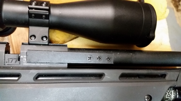

After swabbing the barrel with JB bore compound and heavily increasing the spring tension on the spring that goes between the internal plastic moderator and the barrel, by adding another spring in series with the factory original. Then adding a Jefferson State spring kit to tone down hammer bounce and polishing all trigger internals to get a top shelf single stage trigger pull my 177 Gauntlet is nearly as accurate as the Daystate Wolverine R.
There is no way a cheap barrel, like on the Gauntlet can match the quality of a Lothar Walther barrel, but with the luck of the draw may get it close. I may have just gotten lucky.
The barrel on that thing moves around worse that a fire hose under full pressure and adding that spring tightens things up and puts pressure between the barrel and the shroud keeping them locked fast and straight.
In addition, I also added flat stock from the body of the receiver to the shroud to aid in holding it fast at the end that secures the shroud in place. This mod is not pretty by any means but neither is the gun in general and anything that can be done to make it a better shooter works for me.
The flat stock was JB Welded to the receiver after roughing up both surfaces and it hasn't broken free since being done. The short screws were drilled, tapped and countersunk in place through the shroud as not to touch the barrel.
