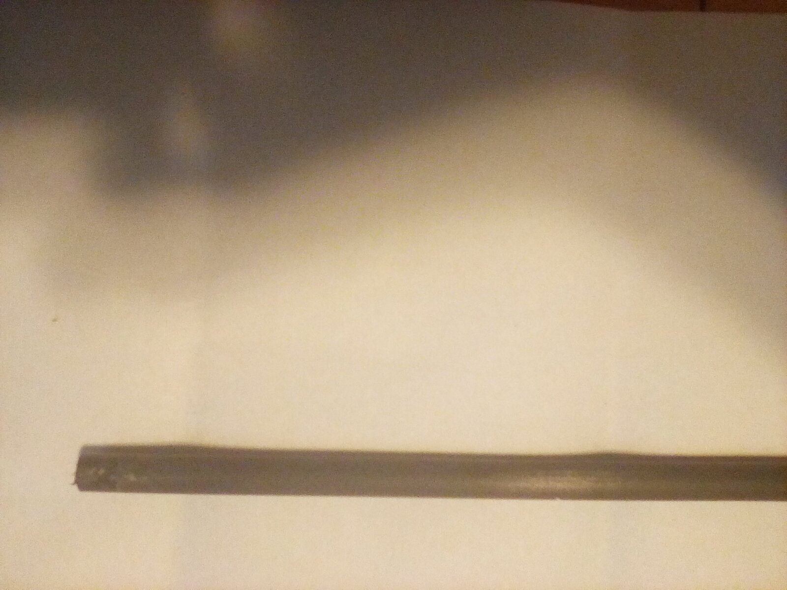

Was shooting my Airsaber at 101yards today and one arrow blew up at about the 50 yard mark....It was very loud.... like a fire cracker.... This happened the other day also at 50 yards when s arrow vanished with a weird puff... Well I wouldn't believe it until I saw it myself...The Umarex arrows are accurate enough for grouping at 100 yards. But have about 3percent fail rate...lol...a buck of a lifetime and arrow explodes before getting to 🦌.... Going to try some Easton Aluminum Arrows...

I'm going to try to recover the arrow. I really can't walk much..Ill try too off of my Quad...The Umarex arrows are accurate enough from the groups I'm getting. But I don't want a arrow faliure when hunting.. The Easton 2219 Aluminum xx75 22 inch arrows will be here tommorrow hopefully... They are rated to 98,000psi so I'm hoping the 3400 psi from the airsaber won't affect them. I shot a Umarex arrow without fletchings at 100 yards... It hit the target... Just about 8 inches higher than the fletched arrow....I never thought a arrow without fletchings would make it accurately to the 100 yard target. But it did...If I could run a arrow with no or very small fletchings....I could run a LDC and quiet things down???? Going to test some more😀

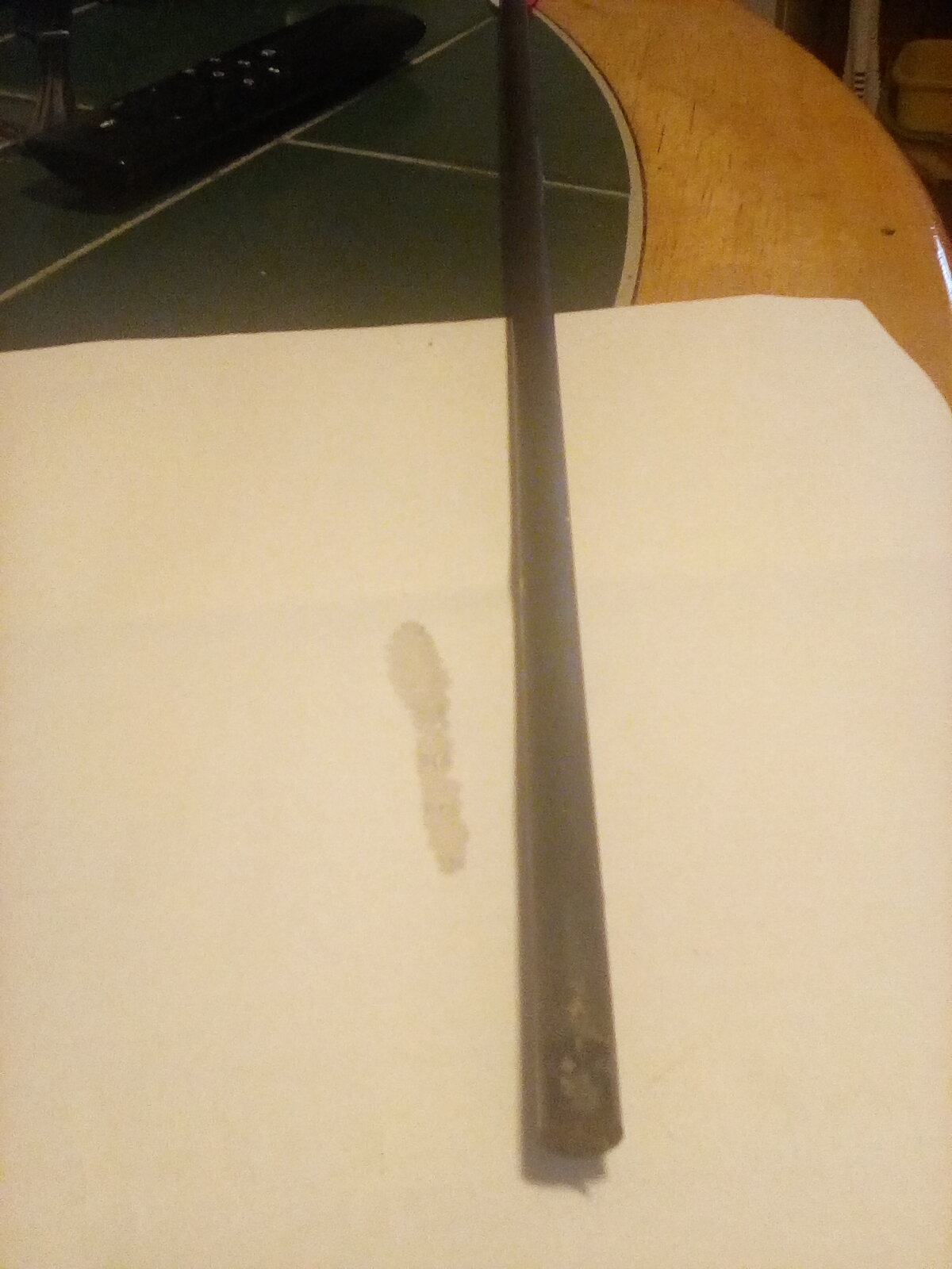

Well Today shooting again. I found the suspect blown up Umarex Arrow... It blew the field.point right out..It was loud like fire cracker...30 yards from muzzle.
every time you shoot that arrow it becomes a pressurized cylinder until the arrow clears the barrel. those appear to be a unidirectional carbon shaft which are not designed for expanding forces. the aluminum should be better, and a multidirectional weave carbon arrow should be ok also. would be cool to see a video of that though.

Yesterday I was shooting on my range and found the other Umarex arrow too....Just the same... field.point and insert cleanly blew out. I don't that the glue between the carbon and aluminum is holding. Air pressure blows them out.. Umarex arrows probably cheap Chinese... For hunting I wouldn't use the Umarex arrows for a chance of failure. The Easton 2219 Aluminum arrows haven't had any failures yet. They are rated to 98,000 psi.so.I'm shooting 3400 psi in my Airsaber .
