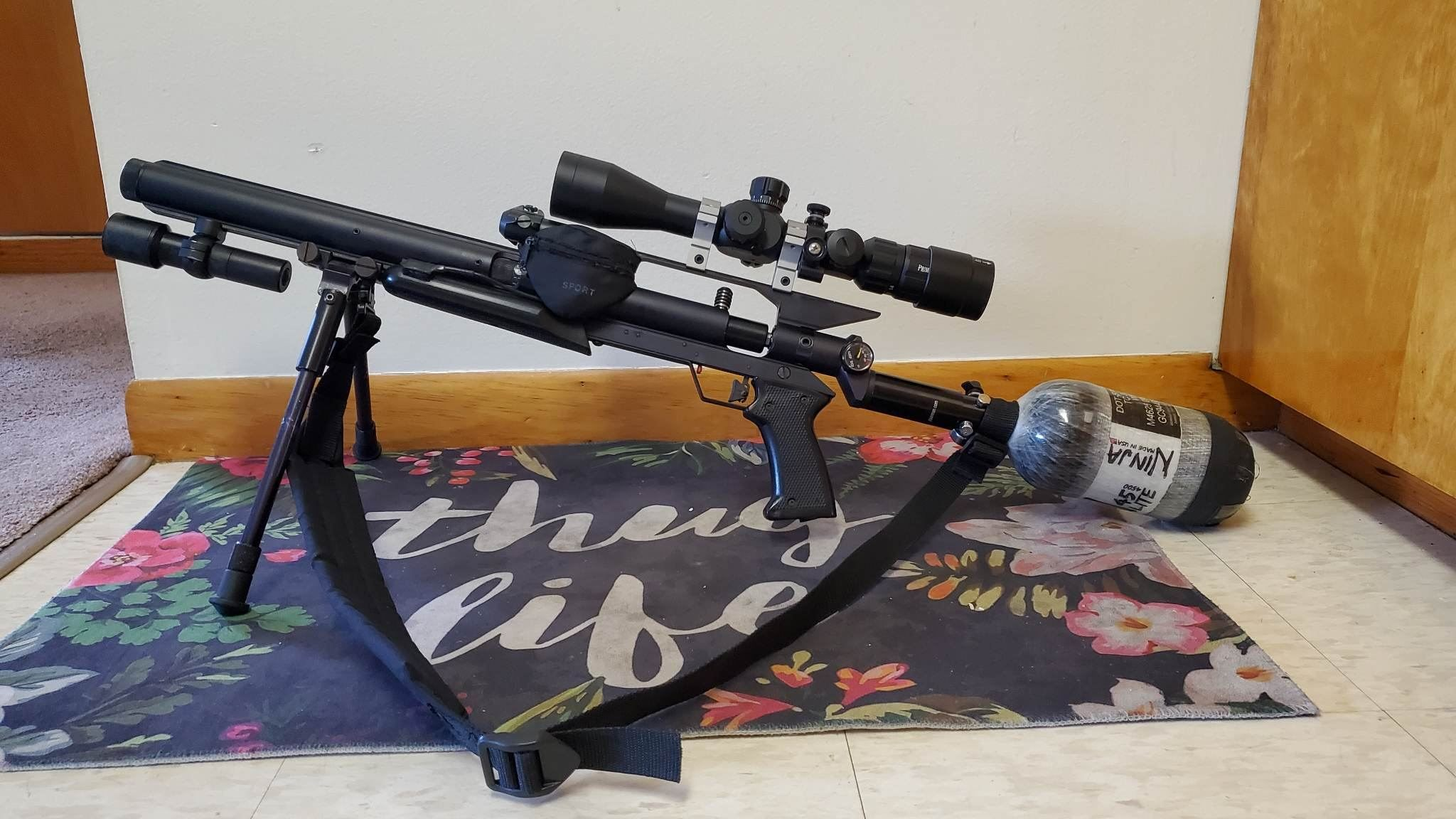

I saw a YouTube video today with a Talon SS and the guy had put a Ninja 45/4500 tank on it behind a regulator. Looked like a sweet set up, and it was as quiet as a church mouse considering he was running .22 16gr pellets at 850. The space between the aftermarket reg and the valve acted as a plenum and my thought, (being a machinist) is to make use of that space with my own external plenum ideas.

Here is the stock in real life from the CAD model and pine prototype I posted above. It's a pretty cool package.
