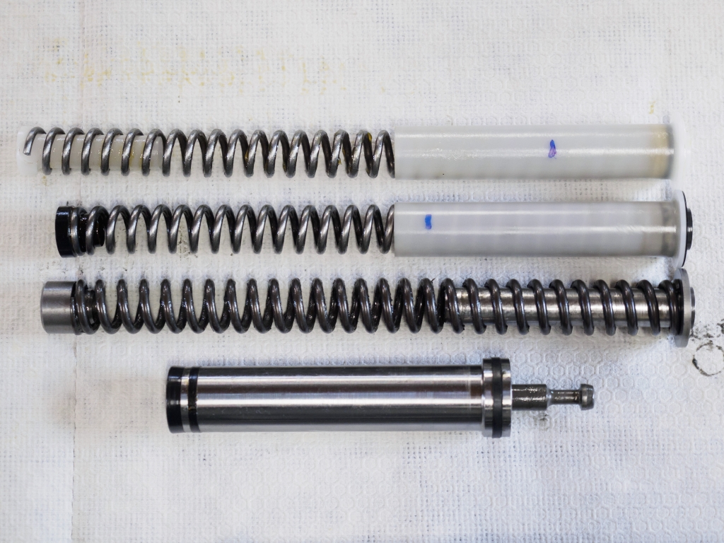

I was not getting the accuracy I wanted from my TX200HC and decided to try to improve things by replacing my Vortek 15 ft-lb PG2 with a 12 ft-lb Vortek PG3. This picture shows the stock components and PG2 compared to the PG3 on top.
The PG3 is a new design that features open coils and a top hat design with multiple notches for the spring end that allow about an 1/8" adjustment for fine tuning power. The kit also has a longer top hat, but a shorter guide as shown by the position of the blue marks. As pictured the kit has 30 coils, but to dial in the power that had to be reduced to 27 1/2 coils, which was easily done with the open coil design. Average velocity with JSB 7.87 pellets was 821 fps giving 11.8 ft-lb energy. As usual with the Vortek kits cocking and firing behavior was very smooth. The reduction in power made cocking much more pleasant, and I did find the gun easier to shoot accurately. Here are a couple groups from my sighting in session that show the potential. These were shot from sitting at 35 yards in a very light wind.
