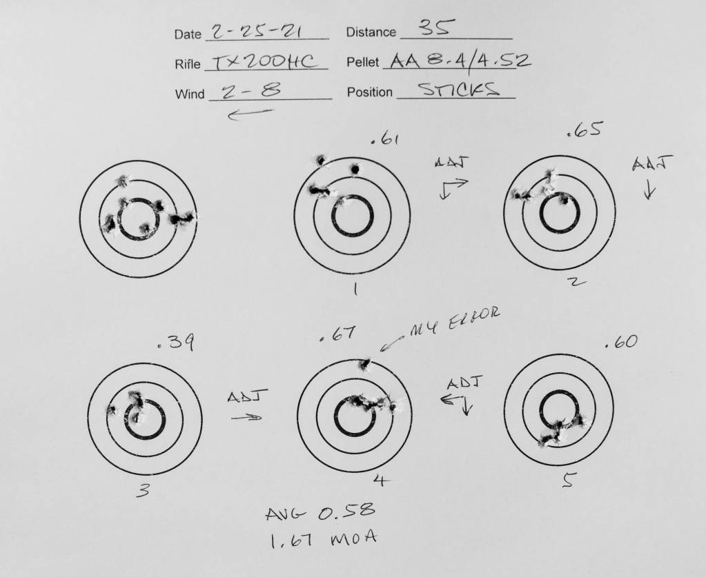

Here are today's groups from a sighting in session. Wind was still variable, but the gusts were infrequent enough I could just wait them out.
I did note an error, but it is included in the group size. I apparently have a problem with throwing shots high. I hope at least some of you found this helpful, especially if you are thinking performing some kind of tune on your own springer.
