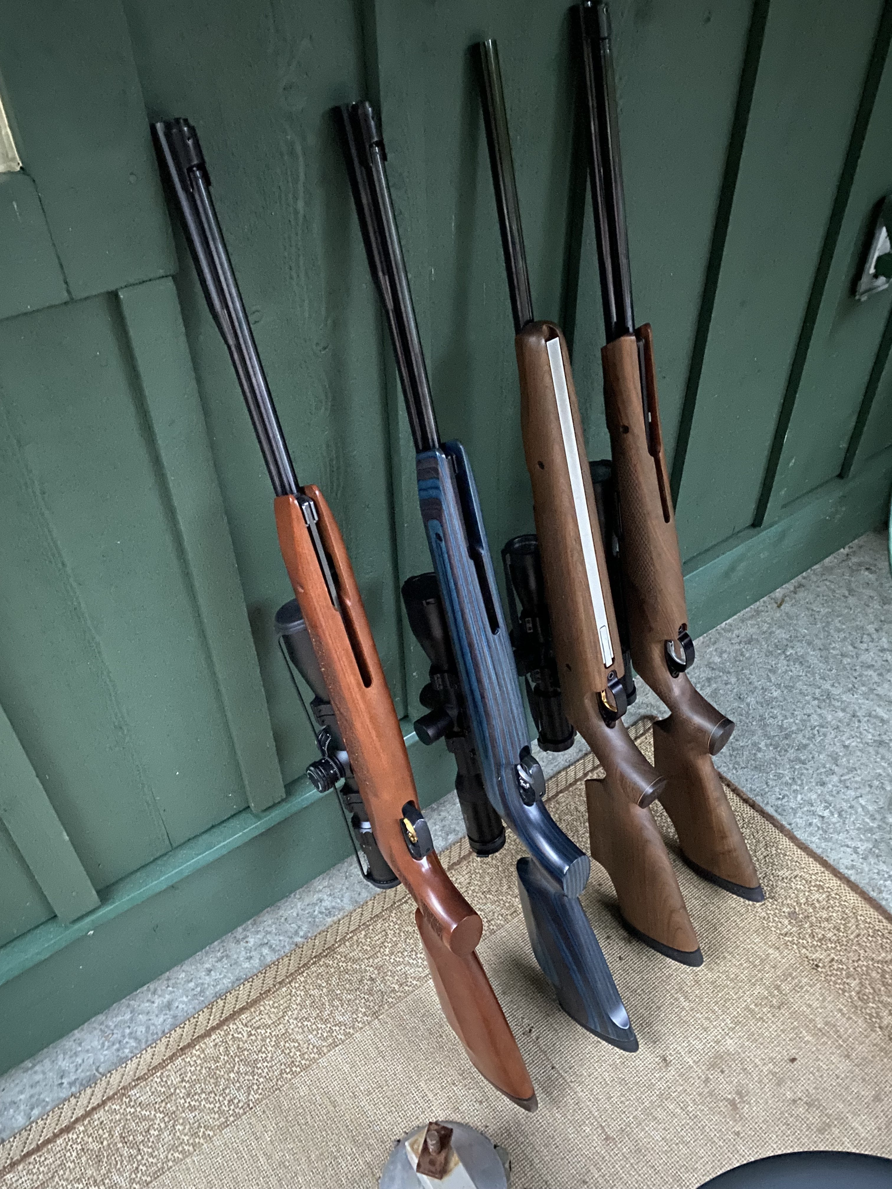

I’ve got a fairly even stable. 35A4E497-9A94-4064-A9BB-ED670549ABF9.jpeg202206BA-6545-4BA6-91E1-F01807A1F05F.jpeg. I was going out shooting just when you put in this post up, helped me which rifles to shoot tonite. These are the four I grabbed. F9CE30AC-3E8D-433D-9A54-541092F31C2E.jpegF9CE30AC-3E8D-433D-9A54-541092F31C2E.jpeg.First shot HW97KL.177. Dirty accurate. An absolute pleasure to shoot. The 97 is the perfect underlever. My range is up to 35 yds.
Next was TX200 .177. No scope adjustment, go, laser. Very nice. Sweet looking. My only gripe is lack of Breach space for loading. And bear trap.
HW97k .22 was next my first 97. Laser, nothing negative. All positive.
Last was my Pro Sport .22. Had to throw in. This gun feels so good to hold. In my opinion the nicest looking Air gun of all Air guns as well. I pounded my targets. Couldn’t put this one down.
Right now I would pick. Tomorrow this could change, their that close.
1-PS
2-HW97 over the 200 because of loading
3 TX200
You wouldn’t go wrong with either. Crow

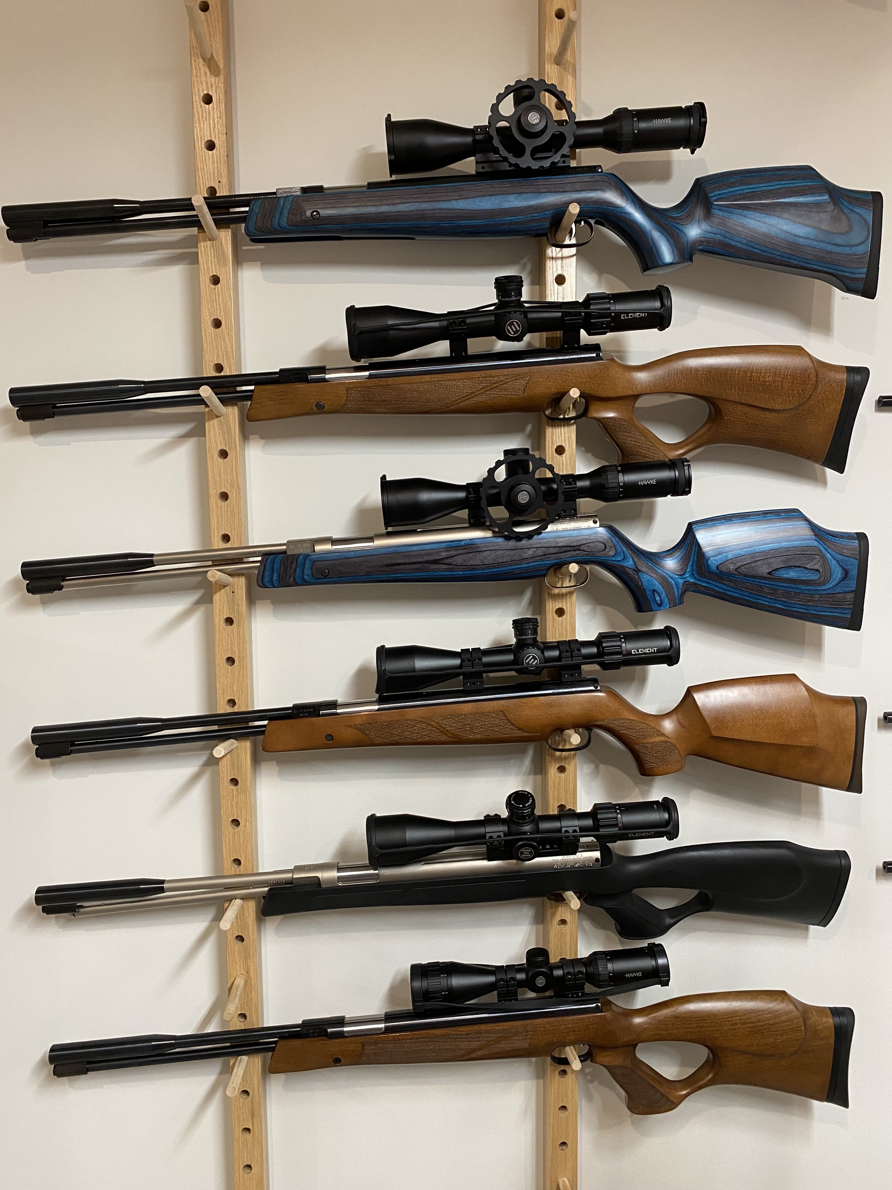

Own both in various calibers and furniture:
TX200:
+ Better finish
+ Super Easy to disassemble
+ Stock Hex screws that don’t get marked up when tightened
+ Available in walnut
+ Available in left hand version
+ Centered barrel for theoretically better efficiency
+ Light trigger out of the box
+ Can take screw on moderator in HC version
- Smaller loading port
- Walnut stocks are mate finish, need oil
- Baffles in standard version make barrel cleaning trickier
- Scope rail doesn’t play nice with all scope rings
- Rare occasions barrel shroud reported to come loose
HW97K:
+ Cheaper
+ Built like a tank
+ Bigger loading port
+ Less complicated bear trap
+ Available in laminate
+ Available in thumbhole
+ Available with sights as HW77 version
+ Available in .20
+/- Ambidextrous stock
- Brutal to take apart compared to TX200
- No walnut stock
- Standard stock screws tend to come lose and get marked up by screw driver
- No carbine version as far as I’ve seen, but available in extra long version
- Trigger usually set to heavy out of the box
- Under lever wobbles more than TX200 and does not compare to Walther LGU
- Typically comes with horrible spring twang due to lose spring guides
I prefer the TX because it’s pretty and easy to dissemble. But they are all equally accurate.
-Marty
