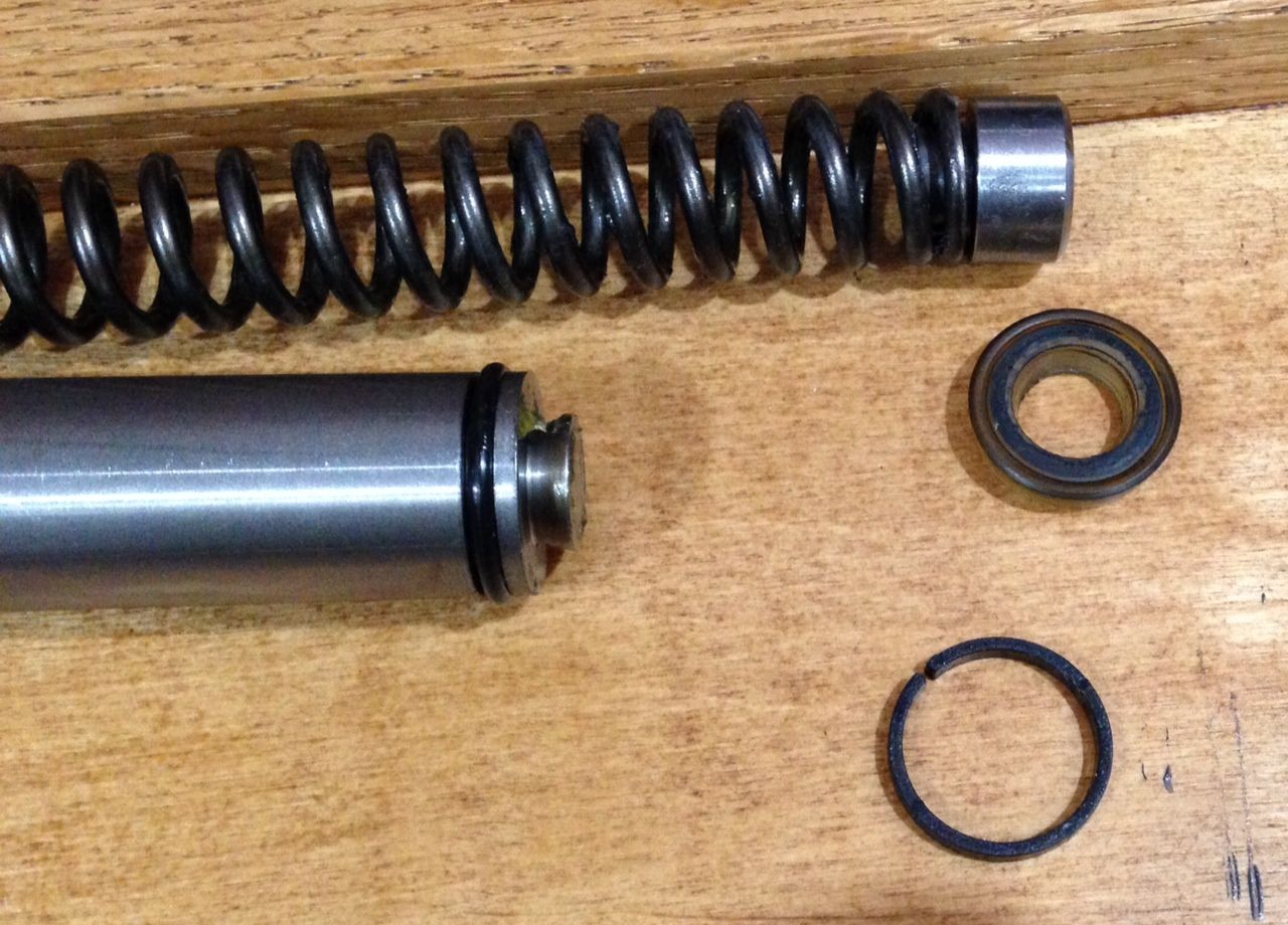

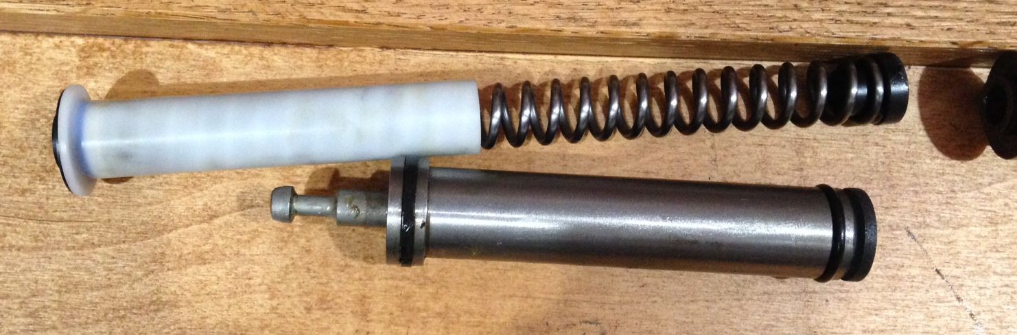

So I bought the 12 FPE Vortek kit and put it in there. The instruction sheet, in my opinion is barely adequate. It has a rudimentary diagram that is probably applicable to all of their kits. But I think at $70 for a spring, an O-ring, a few washers and such, they should have custom installation sheets for each rifle. It's probably well under $10 worth of hardware, once the tooling is paid for. It wouldn't take them long to do. Maybe it is their way of discouraging those who aren't handy to take it on themselves? Here's the specific shortfall areas:
- Preload washers (for more power) are included, but it is not said or shown where to put them. I knew this from watching another YouTube video, but it should be in the instruction sheet.
- It doesn't say or show to replace the piston seal, and the Vortek seal looks pretty different than stock
- It doesn't say where the O-ring goes. It could either go on the outside of the piston, to replace one of the split plastic rings, or below the piston seal. Luckily, it won't go back together if it replaces the plastic split ring, so it was a process of elimination for me. But I worry a bit that I may have damaged that O-ring while trying to put it back together! In the end, I don't think it matters, because the purpose of that O-ring seems to be vibration dampening, rather than sealing anything.
- Although the kit is specific to the TX200, there are no instructions provided on how to take apart the TX200. I found a great and simple YouTube video on it. It shouldn't be necessary.
