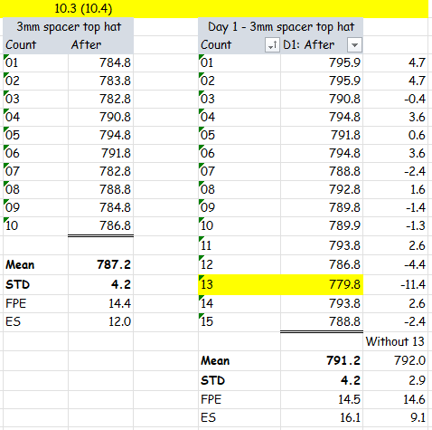

After day 1 it is starting to stabilize. There was one bizarre chrony reading but it was otherwise pretty stable. I was running AA 10.3 for the most part today. Though it was the 13th round so would not have been within the 10-shots I usually have done. Left is after the rebuild and D1: After is after today.
