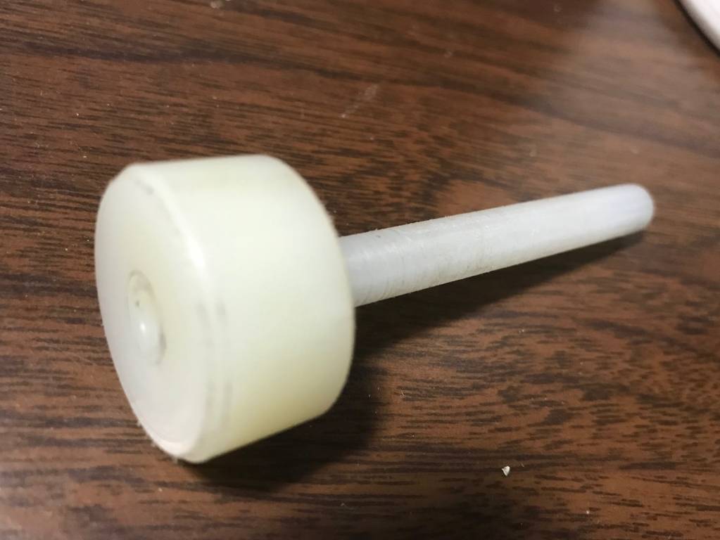

Made from delron or similar and is a slight friction fit in shroud. Goes right in to the end of the barrel. The crown saver goes in without issue and once cleaning is done, pull it out.
Tim
