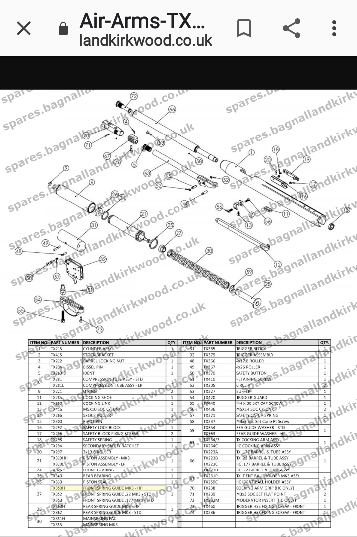

https://spares.bagnallandkirkwood.co.uk/air-arms-tx200/
