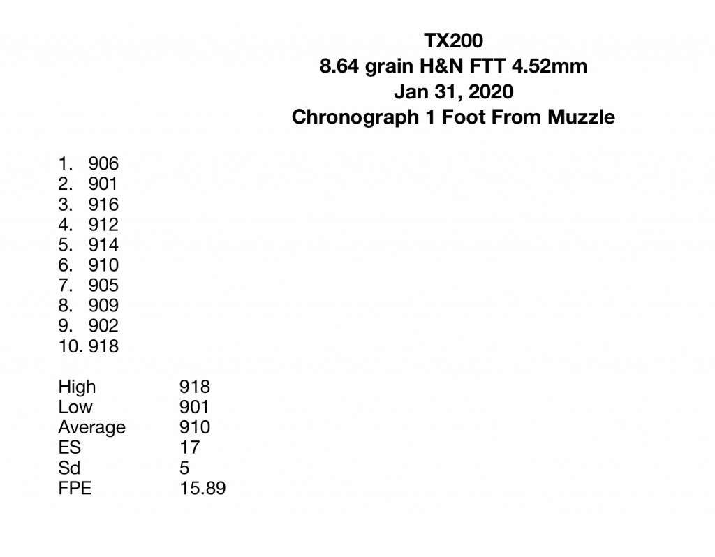

It shoots H&N Baracuda Match10.65's 799 fps average for 10 shots. IIRC the 8.64's were in the high 890's.
How were the ES and SD on the chronograph numbers?
Baracuda Match, ES: 18fps, SD: 6fps. The H&N FTT, ES: 25fps, SD: 8fps.
Those numbers will improve when it settles in. Although those are fairly high ES's I don't think that explains your inconsistent increases in group size.
I worked out off night this AM and finished a little mowing when I got home, then shot the TX some. It's up to 417 shots through it, 147 today, the last 60 through the chrono. I shot 6 10 shot groups alternating between H&N Baracuda Match 10.65's and H&N FTT 8.64's.
Groups 1, 3 and 5, 10.65gr.
Vel. H. 832 -- 826 -- 827
Vel. L. 821 -- 819 -- 827
Avg. 826 -- 822 -- 824
ES. 11 -- 7 -- 6
SD. 3 -- 2 -- 2
Groups 2, 4 and 6, 8.64gr.
Vel. H. 881 -- 878 -- 876
Vel. L 844 -- 851 -- 843
Avg. 865 -- 865 -- 862
ES. 37 -- 27 -- 33
SD. 11 -- 8 -- 9
