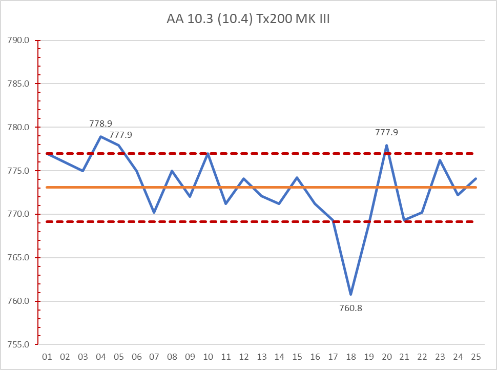

I finally picked up a chrony to try and see how the TX was doing. I also figured it might help someone out if they are searching for data.
I decided to try it with the weight sorted and lubricated AA 10.3 Field Heavy pellets that the gun seems to like. They are really 10.4 grains. It is a VIKKA Premium Precision Ballistic Chronograph from Amazon. I put 25 rounds down range.
I am not sure what happened on shot 18. All the others seem pretty reasonable. Pull shot 18 and ES drops to 10.1 fps. All but 4 shots are withing 1 SD (16%). So it is more consistent that a normal distribution (~68%) would predict.
25 Shots
Mean 773.07
Std 3.93
ES 18.9
count fps
01 777.0
02 776.0
03 775.0
04 778.9
05 777.9
06 775.0
07 770.2
08 775.0
09 772.0
10 777.0
11 771.2
12 774.1
13 772.1
14 771.2
15 774.2
16 771.2
17 769.3
18 760.8
19 768.8
20 777.9
21 769.3
22 770.2
23 776.2
24 772.2
25 774.1
