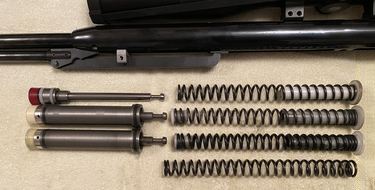

I have a couple of TXs, and changed the internals for a sleeveless piston from a guy called Tony Leech in the UK. I have run both 21mm and 22mm versions and they are superb at about 10.5 ft.lbs.
The top piston is his work, the bottom two have TBT nose extensions. All have delrin guides replacing the AA metal stuff.

Sweet rifles! I really like the TL piston
