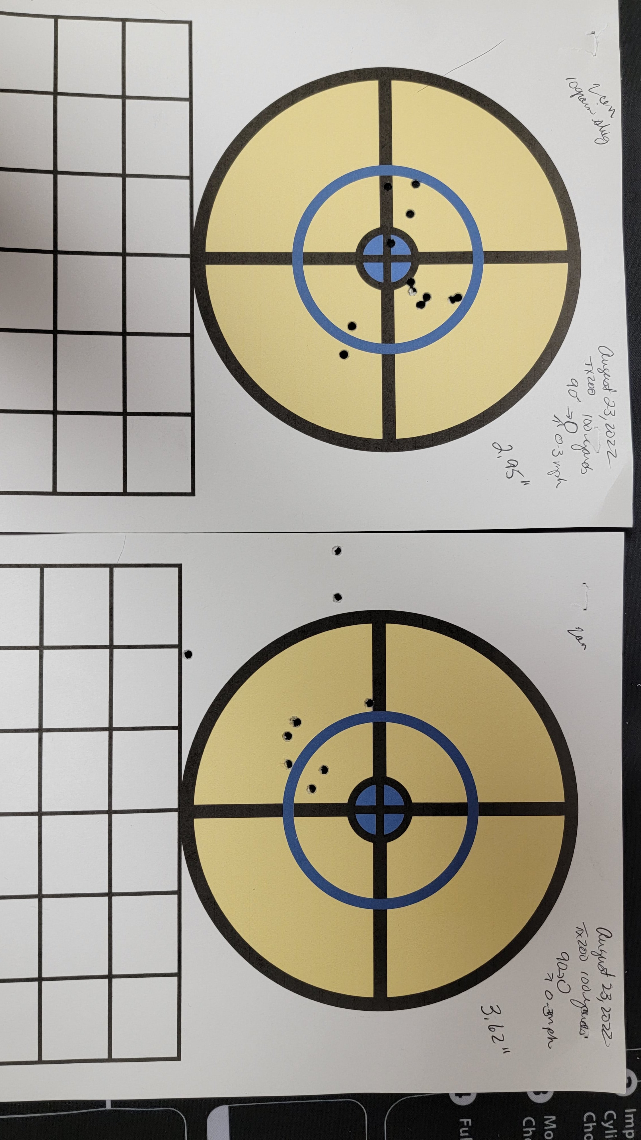

Zan 10 gr wins again. At least it is consistent.
I was able to get some time on the 100 yard range tonight.
The AA TX200 in .177 was again going for it at 100 yardsbwith various pellet competitors. The competition was heated between JSB Exact Heavies 10.34, AA Field at 8.4gr in 4.51 and 4.52, AA Field Heavies 10.3 and Zan slugs in 10 grain. Each target saw about 10 shots. It ran from 9 to 12 shots as I can't count and shoot the same time.
Temp was 90F with a 6 o'clock to 9 o'clock wind at 0 to 5 mph. It was blowing harder at the start than at the end.

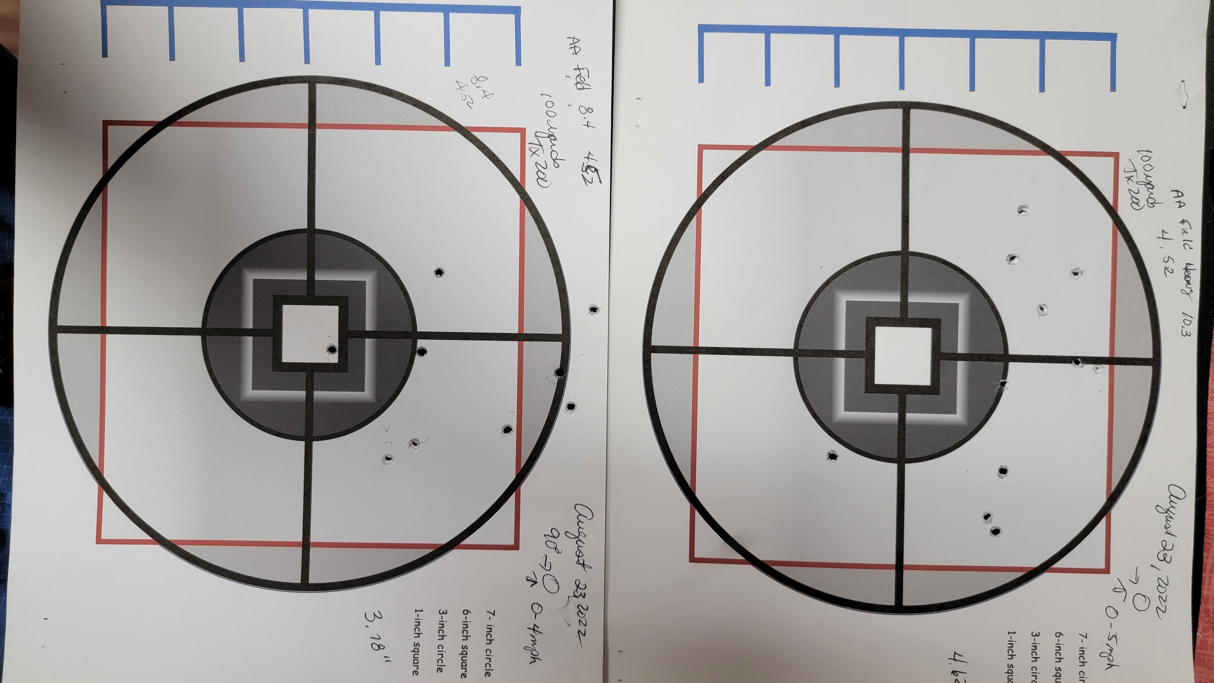

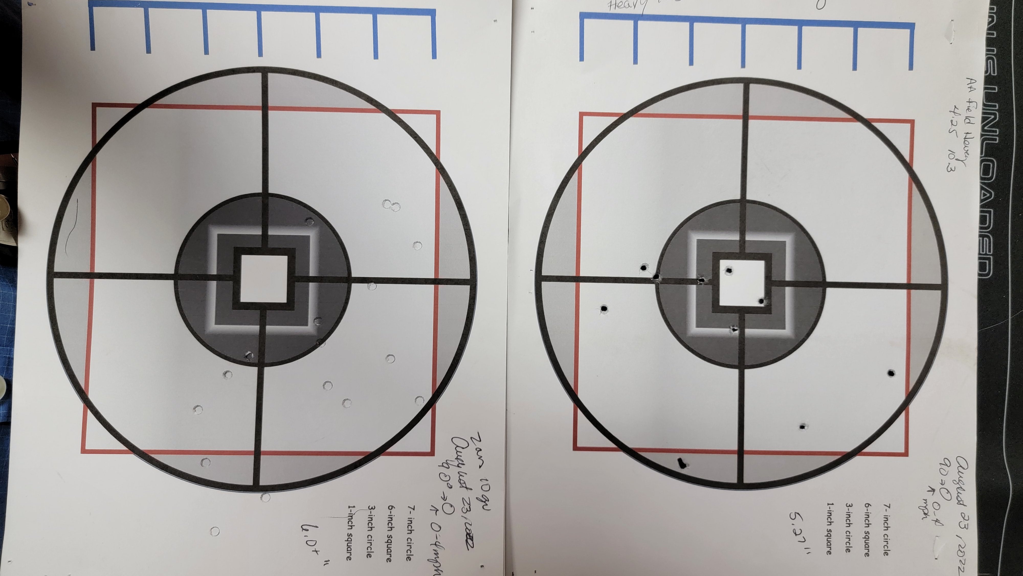

From best to worst at 100 yards were:
1st Zan 10 gr with a 2.95" group.
2nd found Zan again at 3.62"
3rd place was AA Field 8.4gr with 4.52 head at 3.78"
4th was taken by AA Field Heavies in 10.3gr with 4.62"
5th was AA Field Heavies in 10.3 gr at 5.27"
6th saw a tie with Zan 10gr and JSB Exact Heavies 10.34 with 6.0+" groups.
