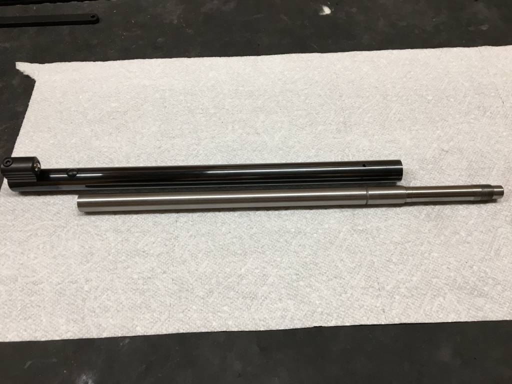

I wanted to post this with my reply above. Here is one of my TX200 “rifle” barrels. Breech to muzzle on internal barrel is 13”+
I’ve also had both PS and HC barrel assemblies apart, but can’t seem to locate my pictures. But the barrels on both of them are identical at about 9.5” from breech to muzzle of barrel only. Some of the info posted on the specs online have been incorrect.
