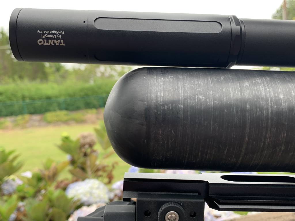

Koi or Tanto, both 1.22" OD, will work with a 480cc, even 580cc bottle on a compact. I was thinking of going down the dual bottle route but in the end decided the added girth would defeat the purpose of having bought the compact. Also storage and transport becomes an issue since it will no longer fit in the case. If you do go dual 480cc bottle though, the Sumo might still work in that setup if the adapter has enough spread between the bottles to allow the Sumo to fit in the "valley" between the 2 bottles. The Sumo for sure will work dual 300cc bottles. Here’s the clearance you can expect with a Tanto, the Koi should be the same.
