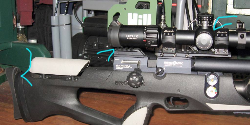

Really like the Helix SFP on on my Bantam HR Magnum. Only complaint is eye relief. Solved that by placing the scope as far forward as possible and adding a 1/2 spacer to the recoil pad. Made the spacer from 1/2 balsa with black electrical tape glued to it. Near perfect color match. The extra 1/2 inch also helped with my trigger pull length.
Notice the front ring is very close to the turrets. Tried that with a cheap scope and it locked up the parallax turret - this one works fine.
I had no issues with mounting and eye relief but was a bit surprised on how far forward I ended up mounting it.
