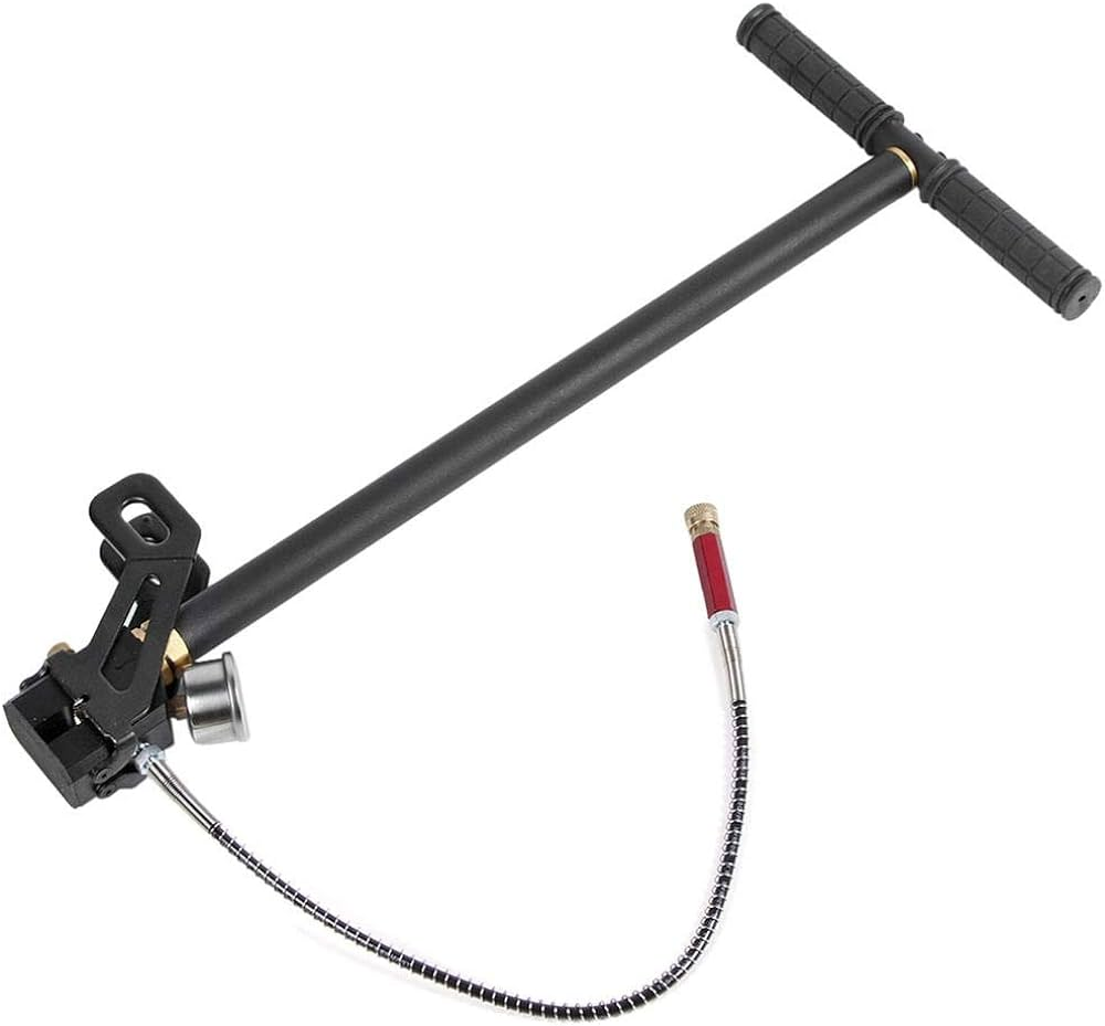

Second question: see this pump image -

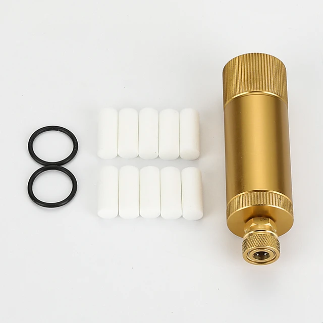

Notice, how there is a red colored piece at the end of the hose. This is a filter for oil/water. Should the hose be installed with the filter towards the air tank, as it is on this picture? Shouldn't this end be connected to the pump? What about the bigger size pump filters, like this one:
Should this filter also be connected on the air tank side (to the quick attach probe)?
