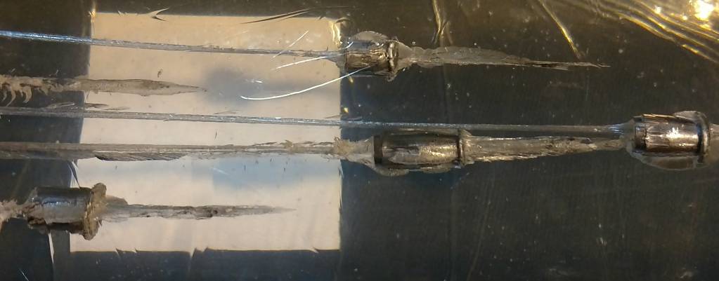

I too feel that two holes are better than one in big game, especially given airgun power and velocities. Well placed shots and two bleeding holes rule here so they bleed out and don't run into the next county from a single lung penetrating shot. I have tested a few different styles in .357 with respect to swaged speer shaped hollow points and cast large meplat and deep hollow points, shooting into ballistics gel at the lower power (simulating the velocity at the end of my effective shooting distance). The speer type bullets obviously outperformed the large meplat cast bullets as far as penetration goes, and the cast opened up like a flying ashtray. Because of the energy dump the cast bullet didn't look like they would exit the hide. I also liked the long range accuracy and down range BC of the speer shaped bullet.

I like the speer shaped, small meplat of the NSA 357 HP-BT 142 grain swaged slug as it gives good penetration and retains it's momentum because it doesn't turn itself inside out and is super accurate. These can be had in a .45 caliber 350 grain slug as well. Now, if it would expand like it does and produce three or four petals that cut as they go through (instead of just mushrooming and ballooning tissue out if the way as it travels), and also completely passes through with it's momentum, then it would be the the perfect projectile for deer and hogs.
For reference in regards to the difference in grain weight and penetration, here is some .357 in HP-FB 120 grain, and speer shaped HP-BT 142 grain. All testing was done at around 800 fps, which was what my ballistics show my speed is at 200 yards.
