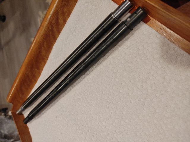

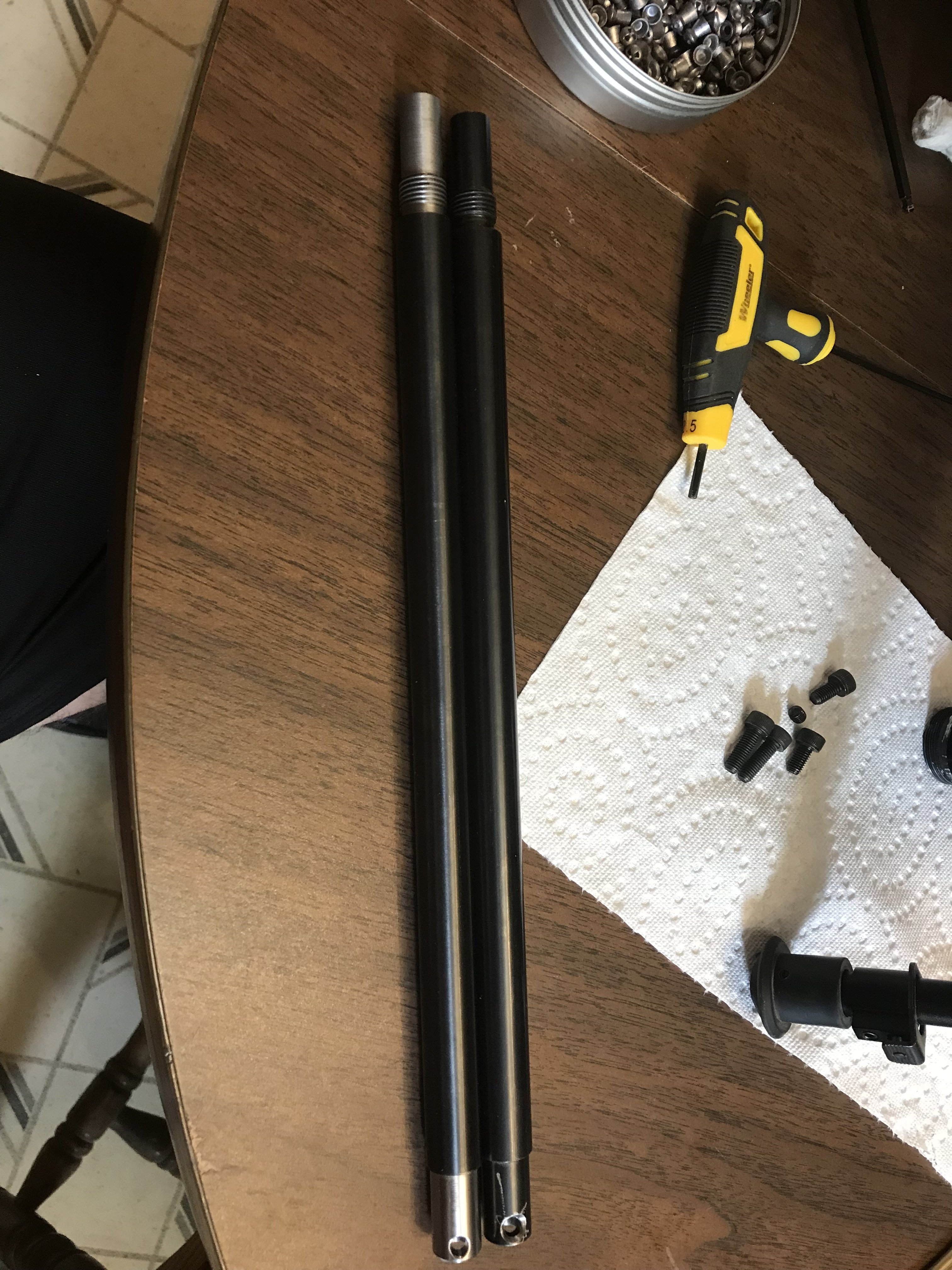

Ok this is the barrels one is just a slight longer than the other, Set them side by side and pushed pellets through, about 2/1/2 inches from the excite or as the pellet leaves the barrel there is some drag on the pellet, But thats just the last 2/1/2 inches before the pellet leaves the barrel, Is this the choke? There were marks on the skirt but just very slight marks,, I did some work on the black barrel as the edges were very sharp, I took some metal off too.
Ok this is the barrels one is just a slight longer than the other, Set them side by side and pushed pellets through, about 2/1/2 inches from the excite or as the pellet leaves the barrel there is some drag on the pellet, But thats just the last 2/1/2 inches before the pellet leaves the barrel, Is this the choke? There were marks on the skirt but just very slight marks,, I did some work on the black barrel as the edges were very sharp, I took some metal off too. View attachment 284801View attachment 284804

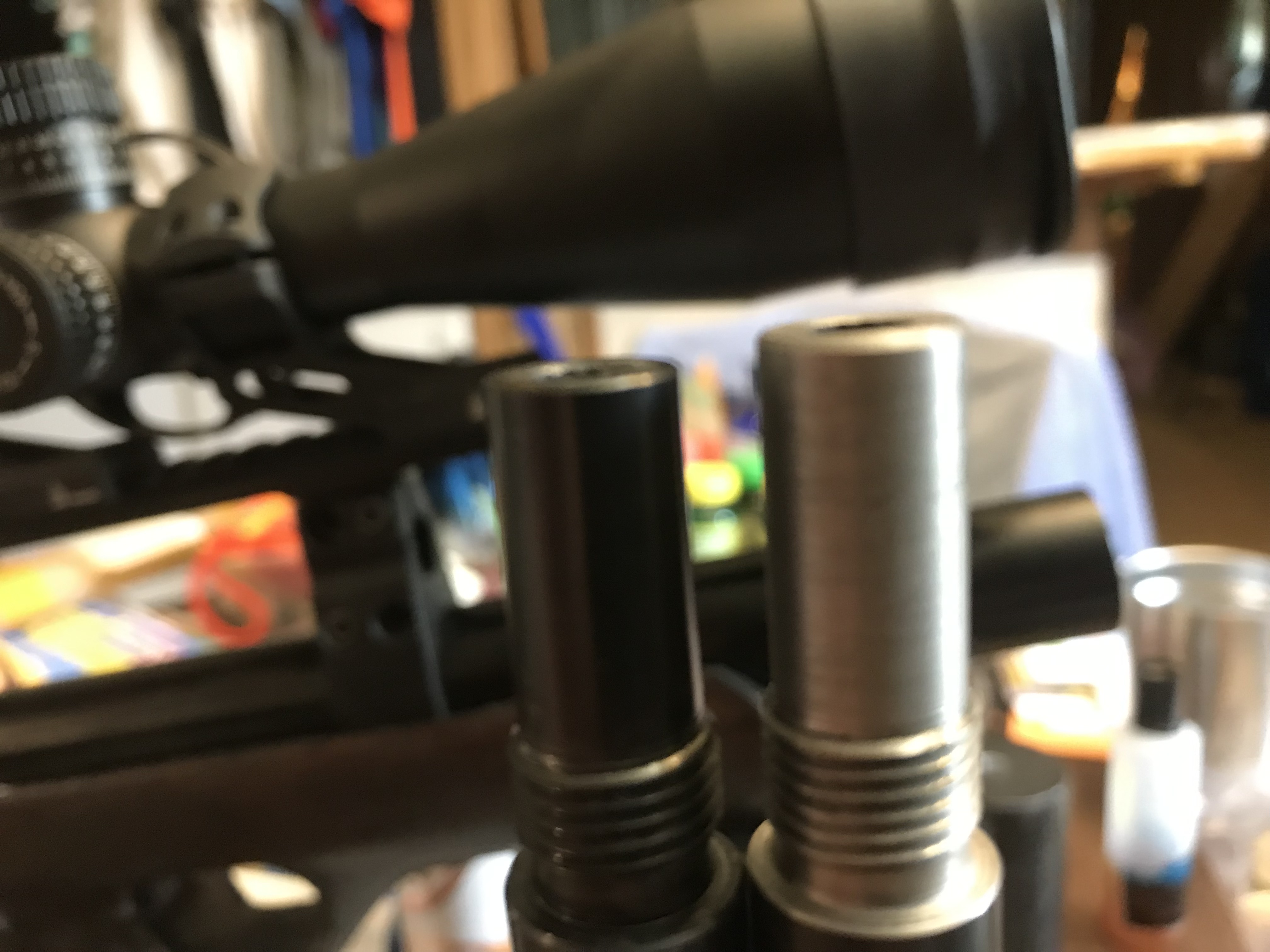

The black barrel looks like it’s the listone. the whole barrel is black. The other has been machined at both ends no bluing on the ends. All new CZ barrels I’ve bought are blued finish like the listone is black at the ends just like the rest of the barrel. No doubt in my mind that the black barrel is the listone.
I've seen enough authentic and counterfeit 12-groove CZ airgun barrels that I can easily distinguish between them. Just need to look with a good borescope, the lands are tall / grooves are deep on the CZs, but most importantly they should look perfect. The cheap chinese clones will have rust patches and beat up looking lands.
So just talked to my buddy Darryl one of the barrel he wash out the rifling on was a listone and it was black. I’ll check my long cz Barrel and see where the choke starts. Darryl bought his gun from Peter. Do you remember Peter Mike? Any way pixs of Darryl’s Listone and a low barrel Darryl had Peter make up. Oh and the choke on my .22 CZ barrel starts bout 2” from the muzzle. So sounds like your good on other barrel fingers crossed lol.
