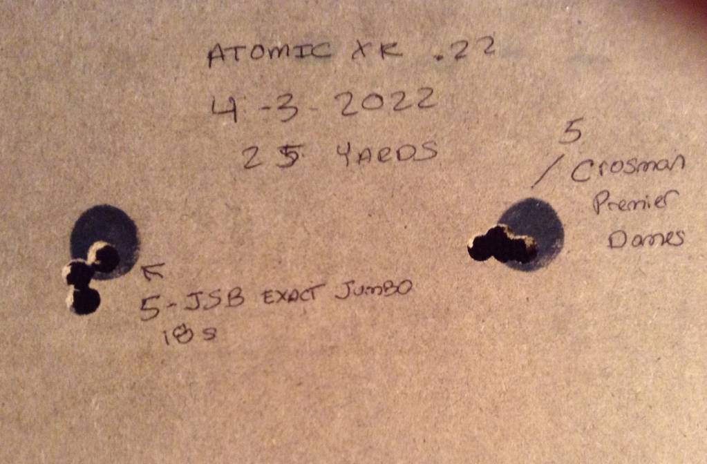

On rainy Sunday I sent at least 200 pellets down range. The gun is very, very accurate, me? Not so much, as I always manage to blow a shot. Also, I expect a flyer or two with the Crosman Premiers. I'll be working on some 40 yard groups to see what's the best I can do in good conditions.
Wind was from the right at 3-5 mph, I held same POA for both groups, the Atomic is currently zeroed with the Premiers. Bipod front, fist as rear bag.
