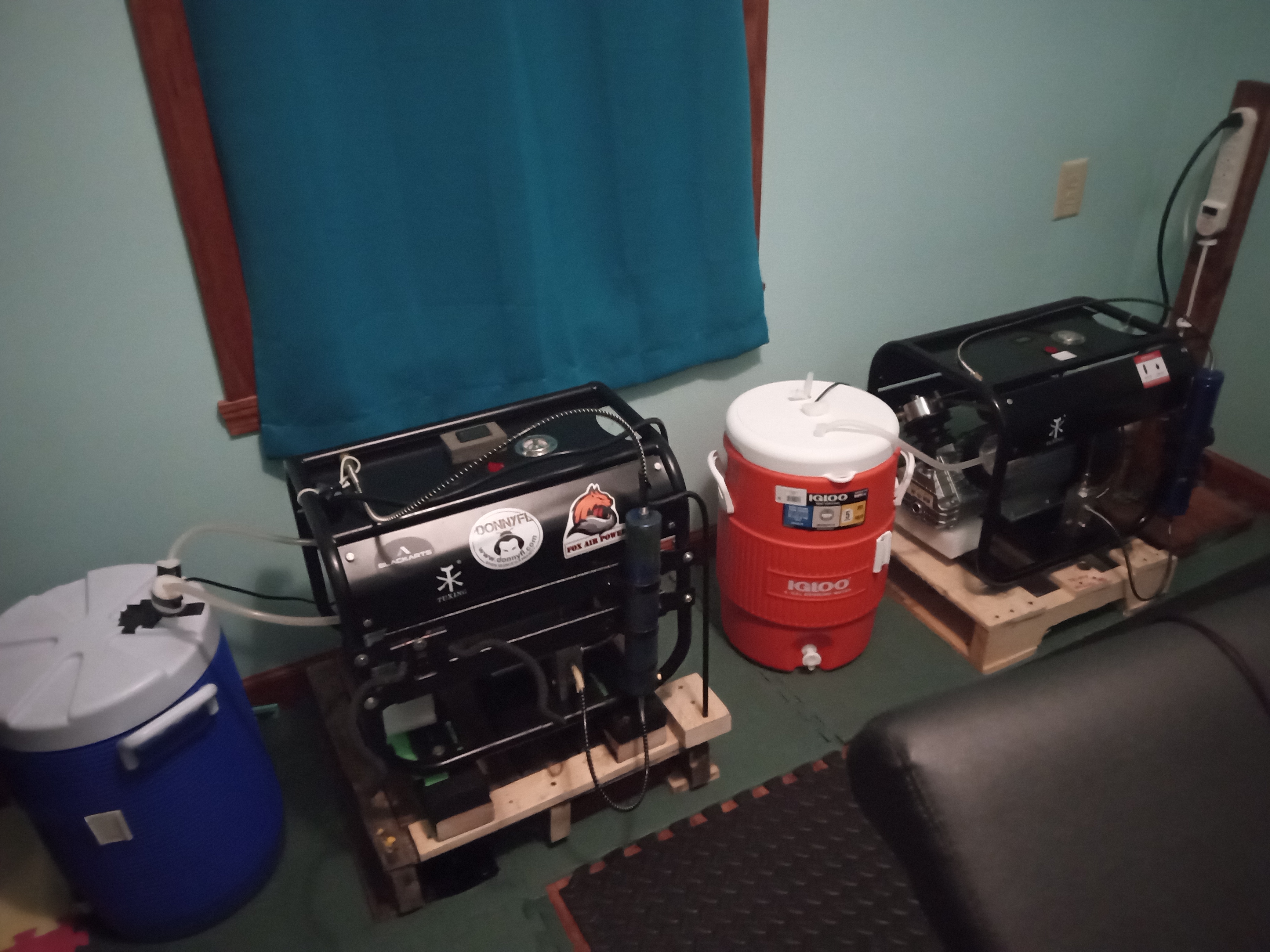

I've owned three Tuxing twin cylinder compressors. The first one, ordered on July 14, 2021, was a TUXING 4500Psi PCP Air Compressor with a double cylinder high-pressure pump and adjustable pressure for air rifles and paintball tanks (TXED012). I installed a simple rebuild kit in it early last fall, and it's still going strong! Then, I purchased another as a backup on January 8, 2023 – the TUXING 4500PSI High Pressure PCP Air Compressor with a built-in water cooling system and auto purge for diving and PCP air rifles (TXEDT031). This model, which had additional features, lasted only 3-4 months. I wouldn't recommend the more expensive model. So, I still needed a backup and ordered on April 5, 2024, the TUXING 4500Psi PCP Compressor, a double cylinder scuba air compressor with a manual stop version and high-pressure air pump for air rifle guns and 6.8L scuba tanks (TXED011). It has been performing excellently; I fill two CF bottles from 3000 psi to 4500 psi at least once a week 45 min and 6.8 liter. I use high-quality oil, TRIAX Kompressor MV 100 Full Synthetic ISO 100 (SAE 30) Air Compressor Oil, which is non-detergent and suitable for rotary, vane, screw, and reciprocal compressors with high temperature tolerance and a 20,000-hour lifespan. Additionally, I use coolers with three-quarters water and blocks of ice. The key to keeping them running well is preventing overheating and using good oil. Never let the oil get to broken down and i don't let the temps get to 140%.
