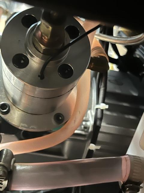

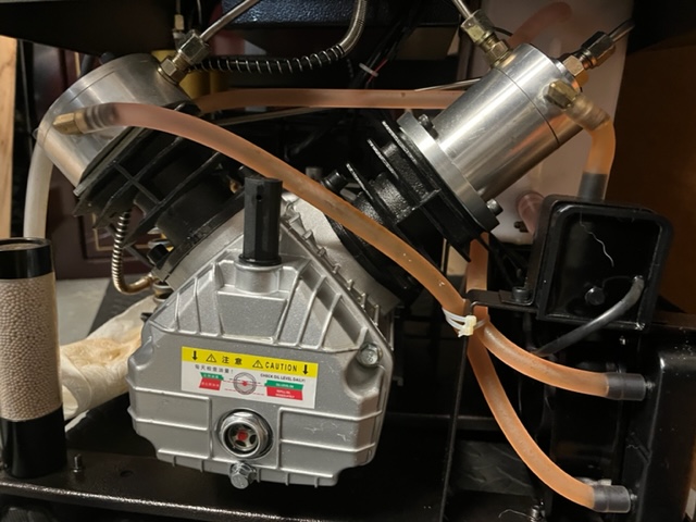

first photo is from the front and the high pressure cylinder is on the right....The next photo shows a black wire that goes into the high pressure cylinder this is the temp probe. Mine was hanging outside the hole. It just sits inside nothing to hold it in.

MAN! Thanks again Tony. You were right, it was hanging outside of it. Placed it back in there. Now I know!
