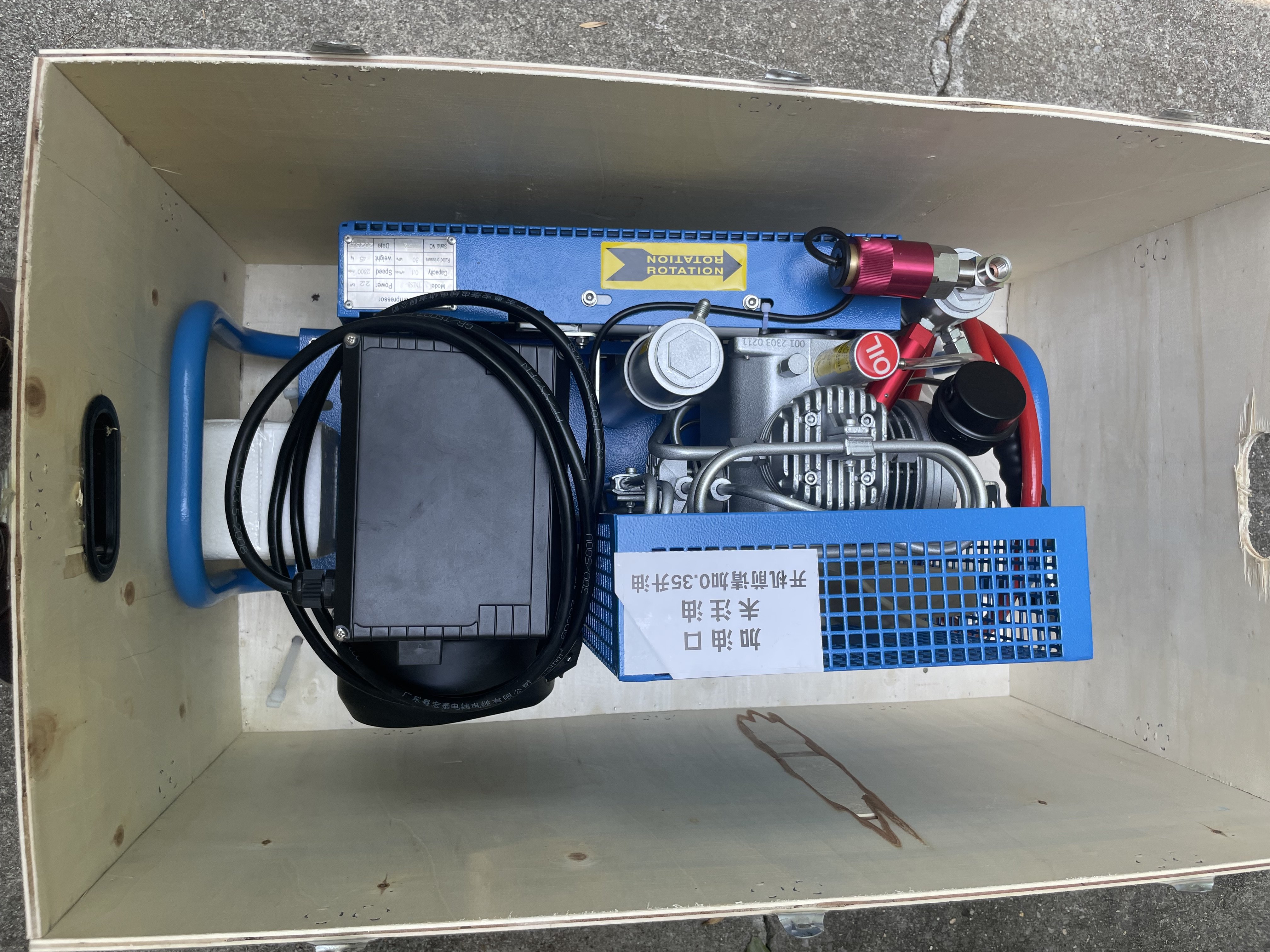

I had a similar problem with my compressor. The motor cover was bent. Contacted Amazon They said to return it. Tuxing asked me not to return it. They would send out replacement parts. The air compressor has been working for about seven months now and has been great. Here is a picture where you can see the motor cover is bent I took it off, straightened it out and used it till the new part came in. It is not the delivery people where the problem is. It is the way Tuxing box the thing. Two tie straps to hold this heavy air compressor in the box not good, I would have to say if you order one, you are going to expect some kind of damage to it
WOW, my Tuxing came packaged like it could be dropped from a plane with no parachute and survive. I still have the box.
