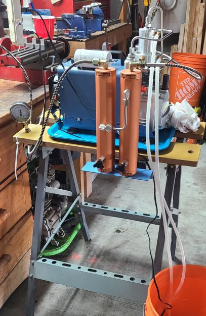

Here's my fill station set-up for a humid Florida garage. The $125 copper-colored coalescing filter is great for removing moisture but might not be needed in a lower humidity environment. The $60 gold filter came with two (3-media filled) plastic cartridges. The black filter (cotton-filled) came with my Yong Heng and I check frequently for moisture. After a year of use, no moisture detected in the black, gold or blue (cotton) filters. Biohazardman once said if your gold filter has evidence of frequent moisture, you need to upgrade your moisture-removal program. I can't say which media is best for the gold filter since mine is still like brand new after a year of use. Hope this helps, WM

That’s incredibly helpful, thanks. So really with the copper colored filter, and a tuxino gold, I really shouldn’t need to worry about the quality of my air ever!
