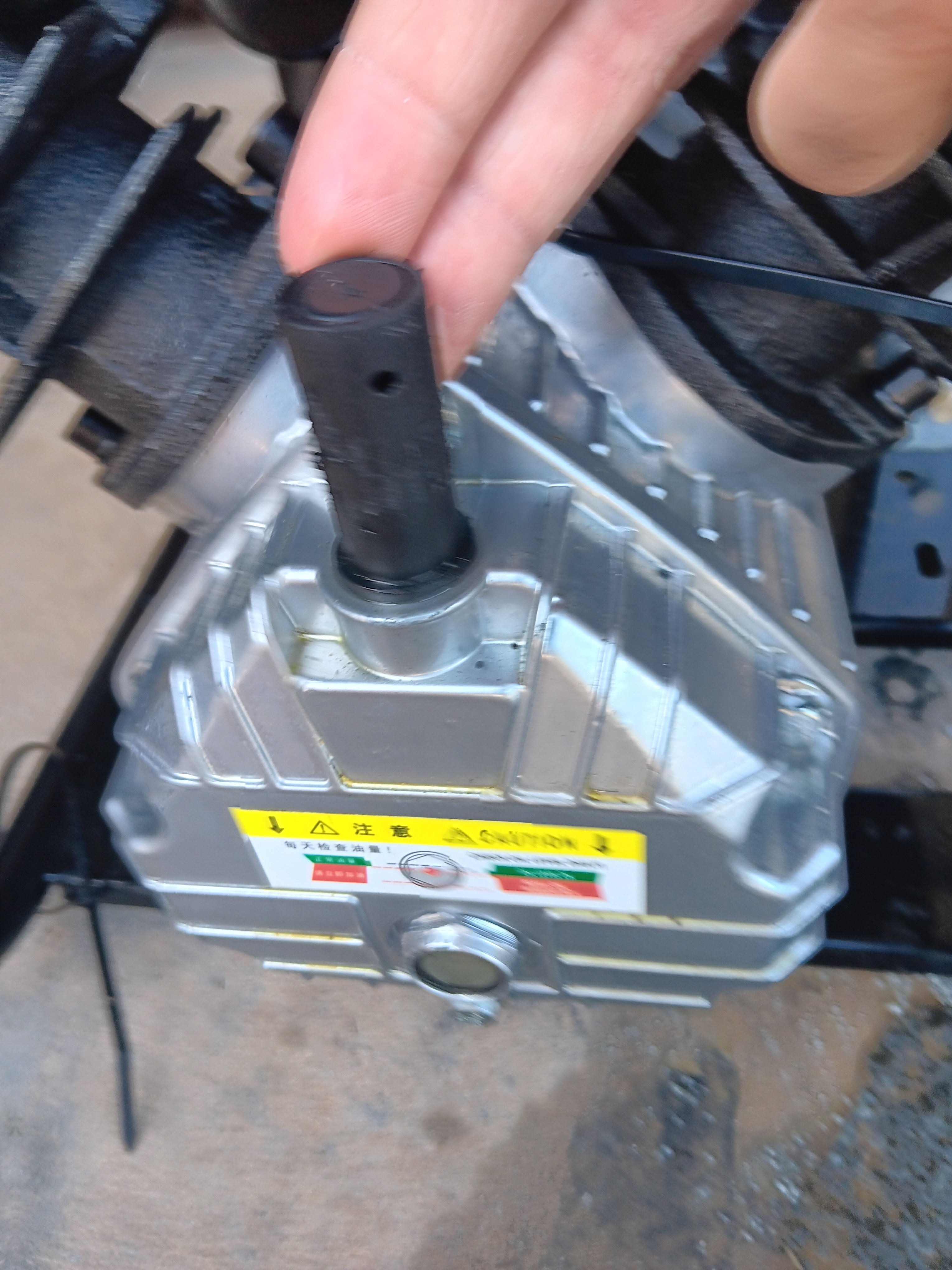

Hello, I have a tuxing double cylinder and the oil looks white there's no water in the oil no water leaks anywhere I'm using husky 100% full synthetic air compressor oil. The oil is very clear when it comes out the bottle and stays clear when I run the compressor under no load but when I go to fill a tank or gun it changes to this white color.
To me the picture looks like the oil is whitish and an air bubble at the top of the sight window . could it be air mixed in the oil ? causing the whitish look ?
MY opinion is what ever is the cause it is not letting the oil do its job to the proper extent .
Ya, sadly so many threads on this oil issue and not one real solid answer. A lot of answers all over the place to throw darts at ..
True. I'm thinking it's either air or Mostuire. I let the compressor sit for a little bit and the oil cleared up a little bit just a little bit it's still white though
Reactions: Hateful McNasty
maybe drain the oil into a glass jar so we can actually see the oil ? I sure would not keep using it .
