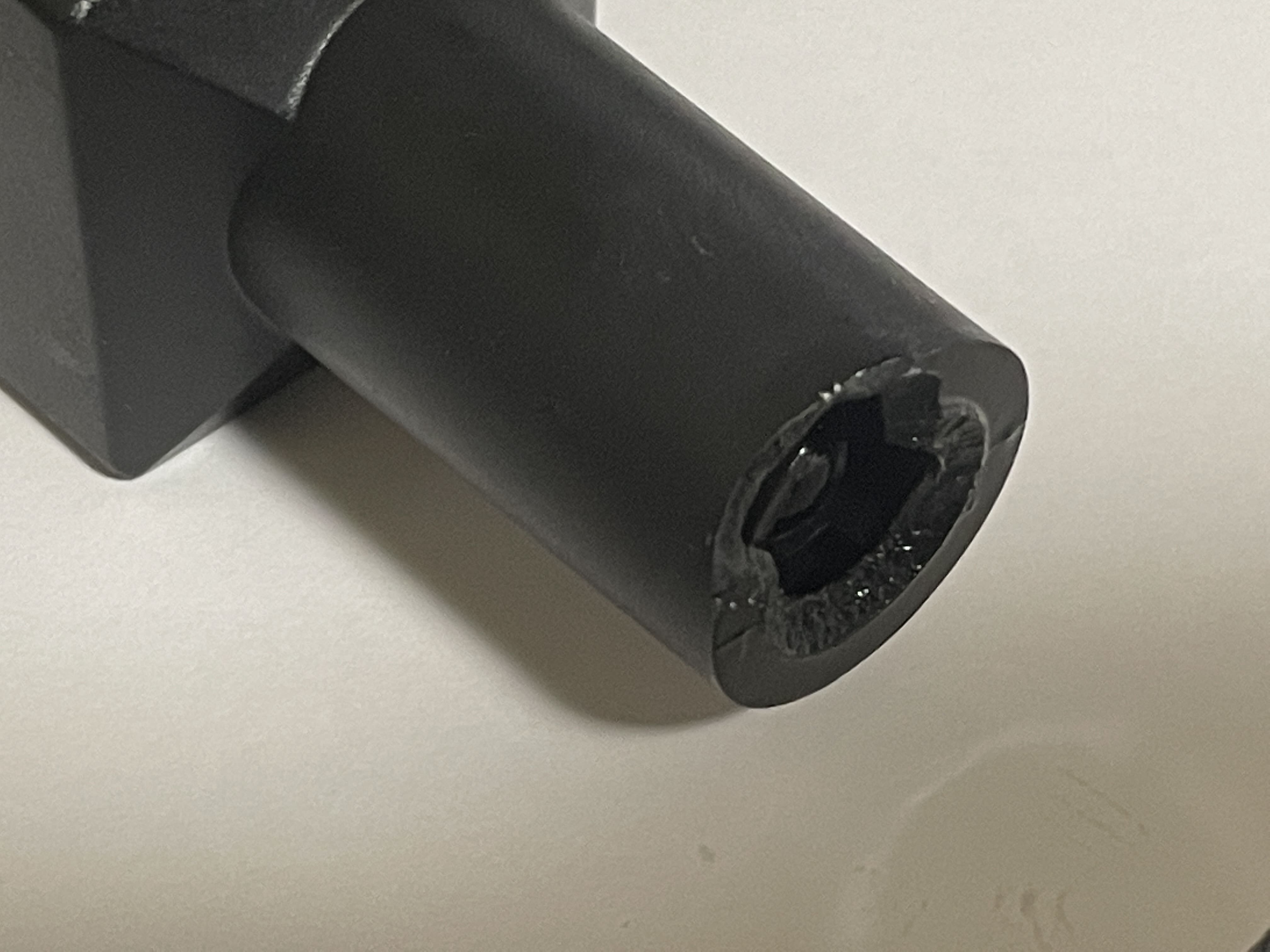

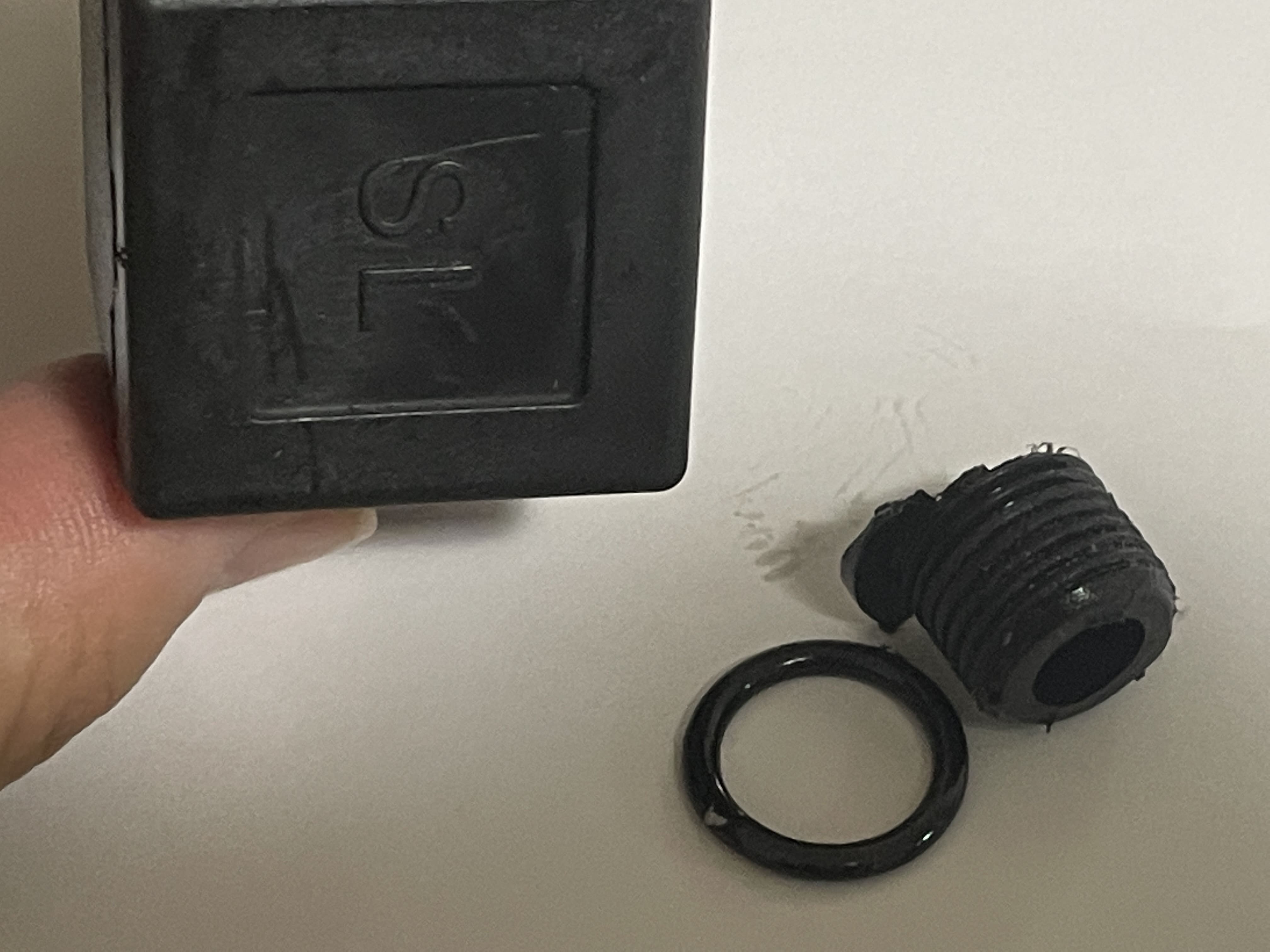

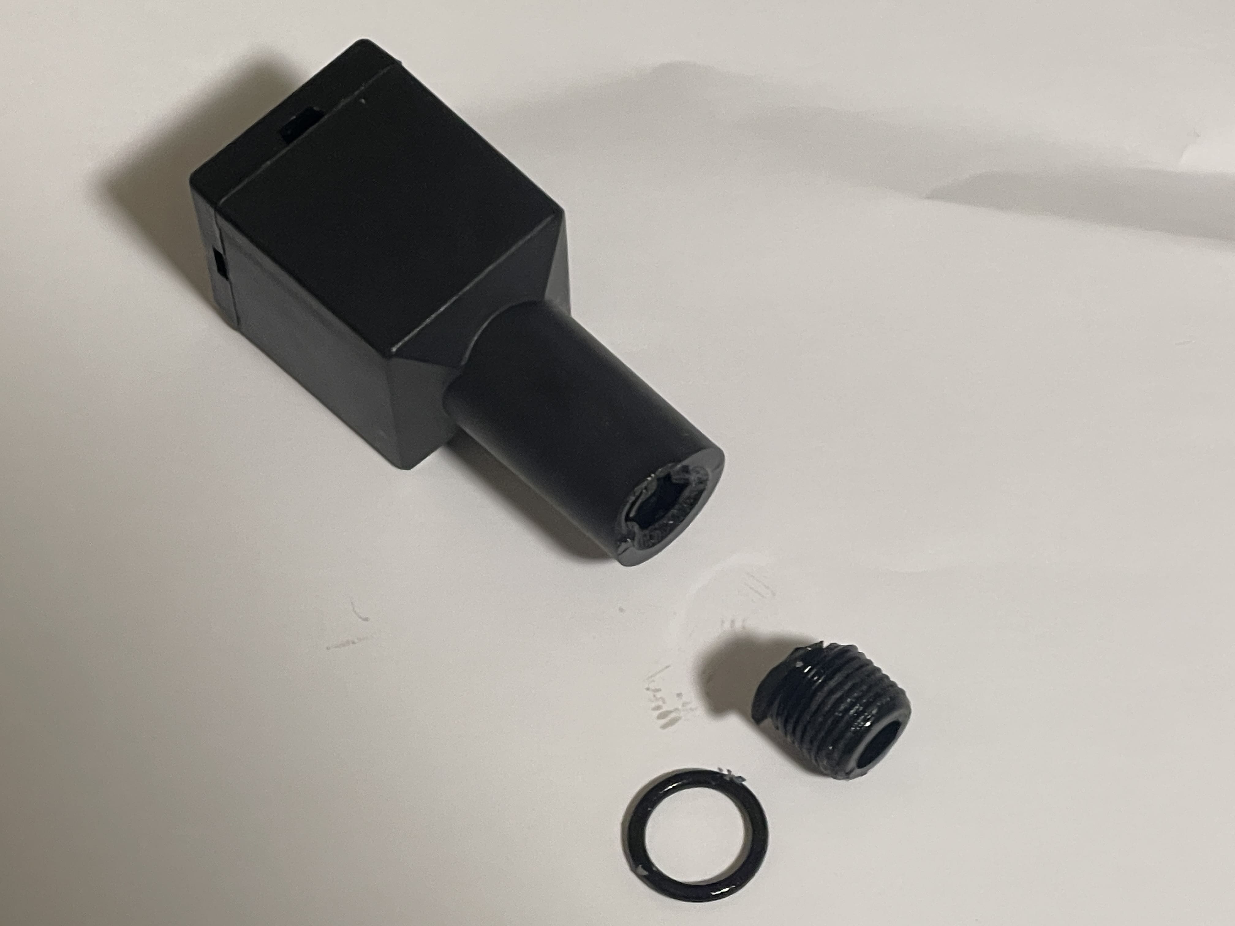

It broke after the third oil change.
TUXING staff said this was a consumable item and not covered under warranty.
I paid 7.9USD.
Also oil is leaking from the oil drain bolt.
I purchased this on 5/22/2022.
This air compressor may explode in the not too distant future.

Looks like just the crank case breather box? The manufacturing quality is still chinese, and so is the customer service.

Rebuild it now. That's a symptom. Either too tight, vibration, or air leak into the crankcase. The biggest issue with this compressor is assembly. If you rebuild it. You will know it's assembled right. Use good oil. I use the Bauer oil from Nuvair but any of the good oils in this thread will work.
The oil drain bolt is because the screw head hits a rib on the cover. Either seal with silicone or make a gasket.

A broken crankcase vent cap on Chinese compressors is common. It is an indication of the cheap plastic used to make them. Most Chinese compressor manufacturers source these caps from third party manufacturers in China. The square ones have failed for many owners of different brands of Chinese compressors. It doesn't mean anything regarding the compressor itself. I had the same experience on an old compressor and merely epoxied the two broken halves together and the vent cap never failed again. It is a cheap item to replace. Your other issues are unrelated to the cap failure.

Yeah, I had to replace mine as well a few months ago. About the same cost. I bought two!
Seems like this will be the most often part replaced (fingers crossed). I've been quite happy with the Tuxing compressor. I use a lot of air monthly, so this was quite the good investment last year.
