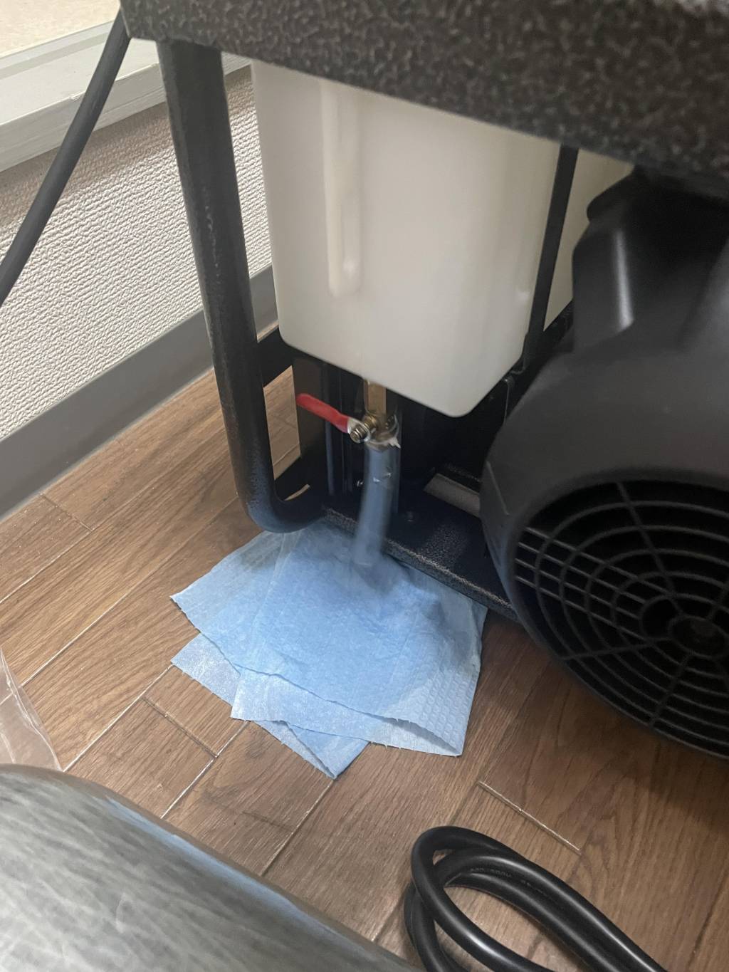

Check/fix water tank leak at inlet hose connection

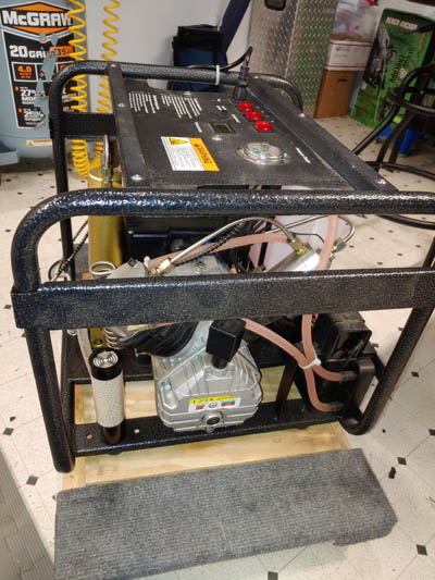

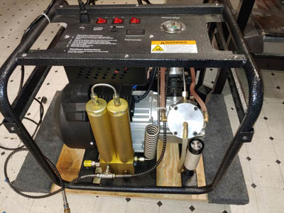

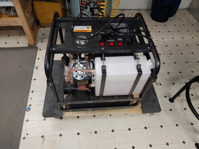

I got my Tuxing 032 today. I did the once over. The Temperature sender was in the head but not fully seated. The hose that goes from the water pump to the first cylinder was cut about 2” too short so was not connected. Concerning but an easy fix with some new hose cut to correct length. There is a small O ring on the oil drain bolt that was visibly pinched. I removed the bolt and notices some very dark gray oil came out. Looked exactly like machine cutting oil so that is also concerning. It may also be some kind of assembly lube? Was only about a half a tablespoon so I just let it drip out. There is no grove to receive an O ring so I’m sure a replacement would also pinch so I used some gray silicone instead which is probably a better seal solution anyway. Topped it off with SECO 500 per Brian’s recommendation. Filled the tank with distilled water and about 4 oz of Redline water wetter.
Ran the water pump for a few minutes and saw no leaks. Ran the compressor open with no load for about 10-15 minutes per Brian’s break in recommendation. This compressor has a nice quality sound to it by the way. Not too loud at all. Plugged the hose, set the gauge to 250 BAR and the compressor got there in just a few minutes and shut off fine. No leaks. Set the gauge to 300 BAR and repeated with same results. Purged the canisters with only the first having a little moisture and the second was mostly dry.
Hooked it up to my 92 cu ft tank and it went from 200 BAR to 300 BAR in about 15 minutes with one purge (again only moisture in first canister). The gauge on the compressor and the gauge on the tank both had the exact same 300 BAR reading so I don’t think mine has the gauge accuracy problem some of you have had. I probably will not reroute the pressure gauge line if this remains the case.
The hottest IR reading on was about 157F (@ cylinder just below the head). The temp indicator on the compressor got to around 127. Time will tell but it seems like a really nice compressor. It will only see a couple of uses per month so should last a lifetime?

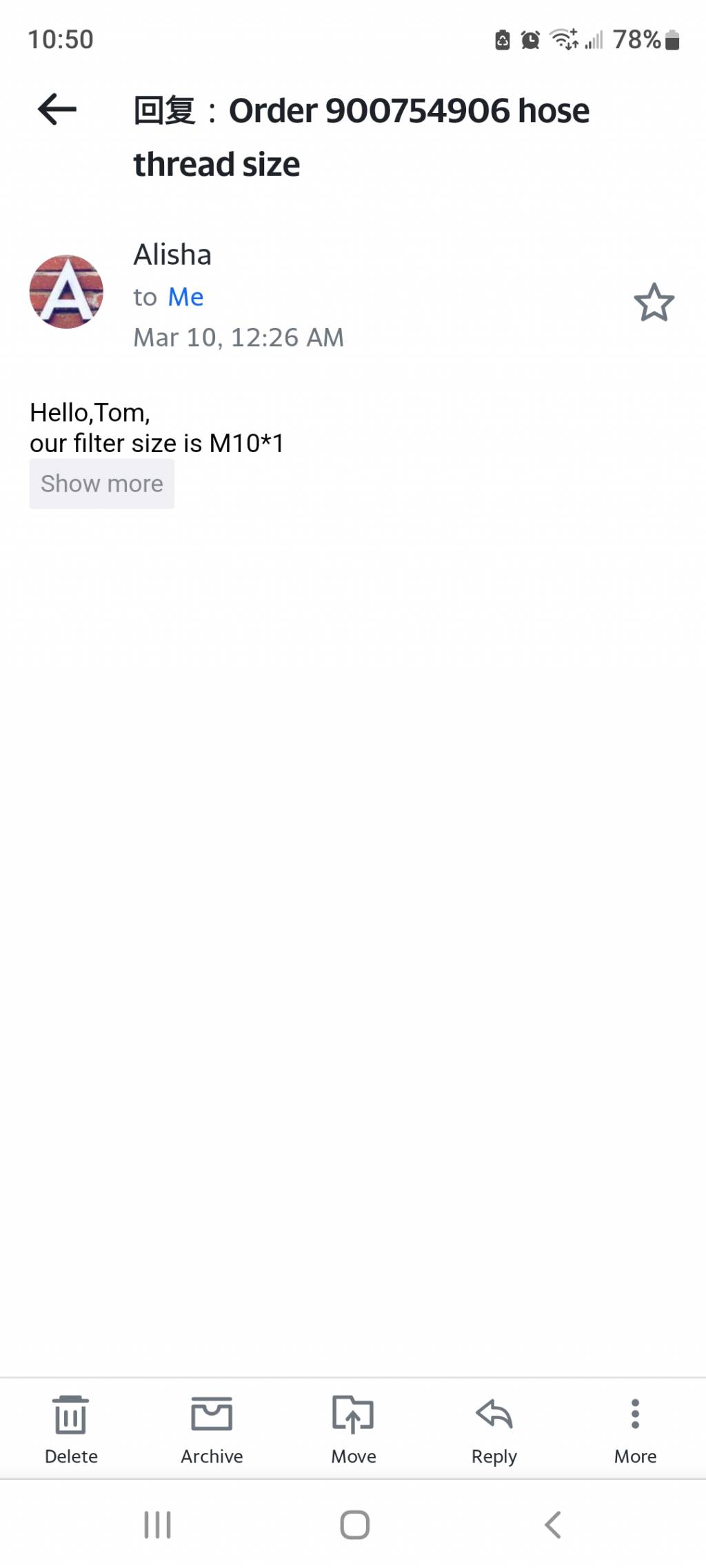

The threads are all metric size...M10x1 and not NPT. You can get an NPT to thread into a metric port but it will cut and modify the thread.
poop...
I just opened a link to a previous post that showed Titan fittings and they were 1/8” NPT.
Brian says these are 1/8 BSP ?

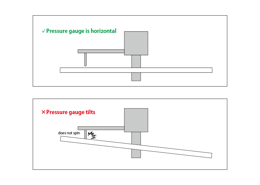

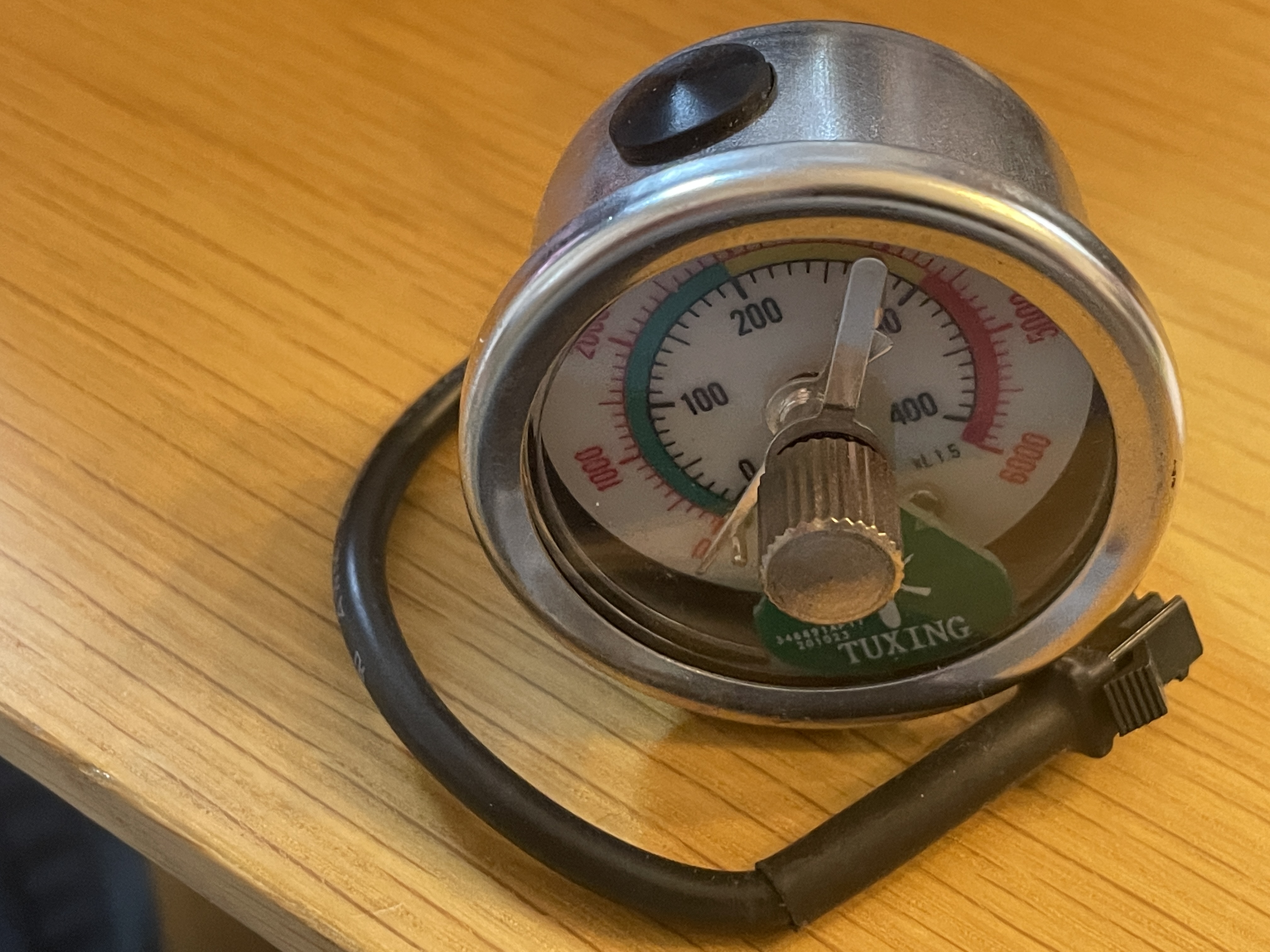

I bought "TUXING TXEDT032 : Auto Purge version" on Aliexpress.

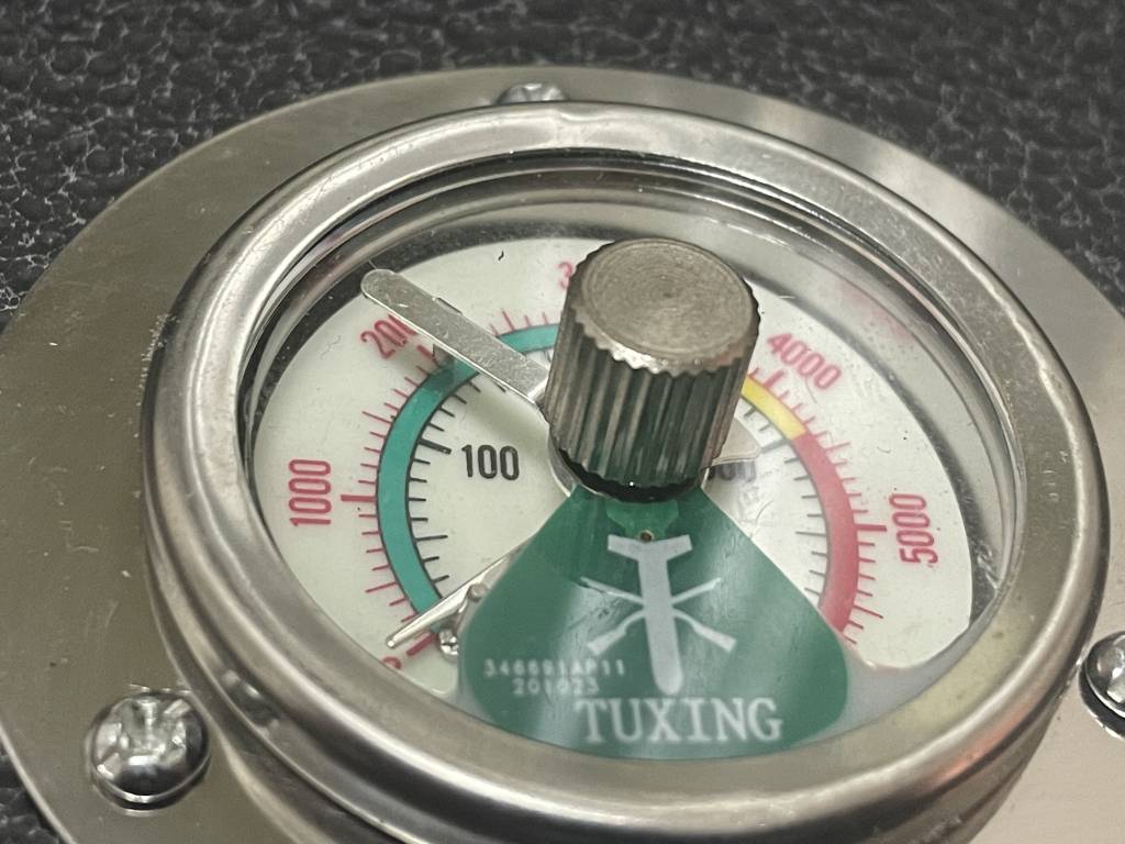

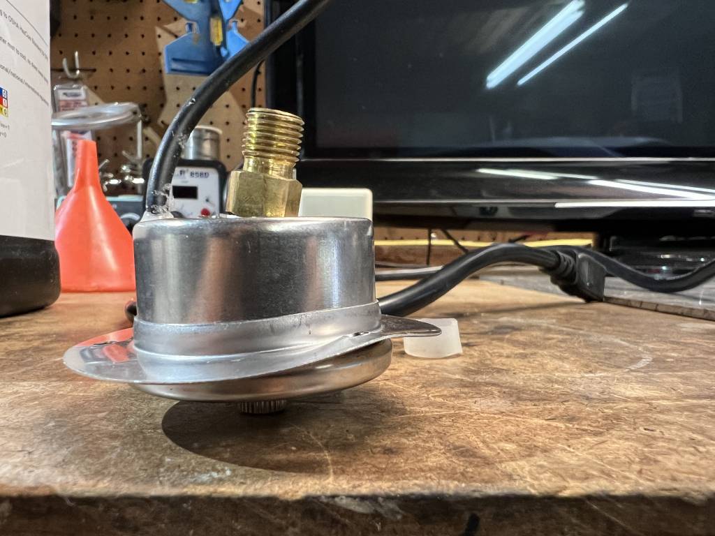

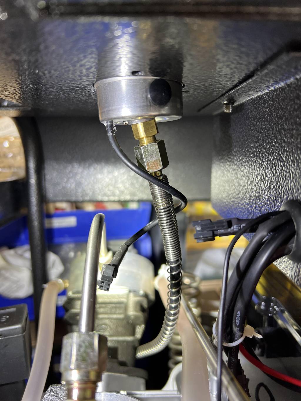

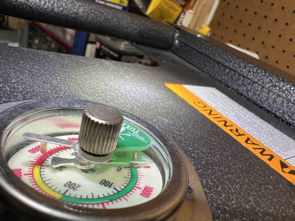

The pressure gauge is tilted and cannot be adjusted.
TUXING said it will ship a replacement soon.
TUXING support is great.
But I want great QC rather than great support.
I also participate in forums because there are few reviews. I will answer any questions.
Unfortunately, I too read this forum and have encountered the same issues as others in regards to leaking water container, and the same issue with the auto shutoff gauge being damaged on arrival. I have sent two emails and have zero responses so far.
6/7 Update: Tuxing will be sending new gauge. Hope it comes soon!
