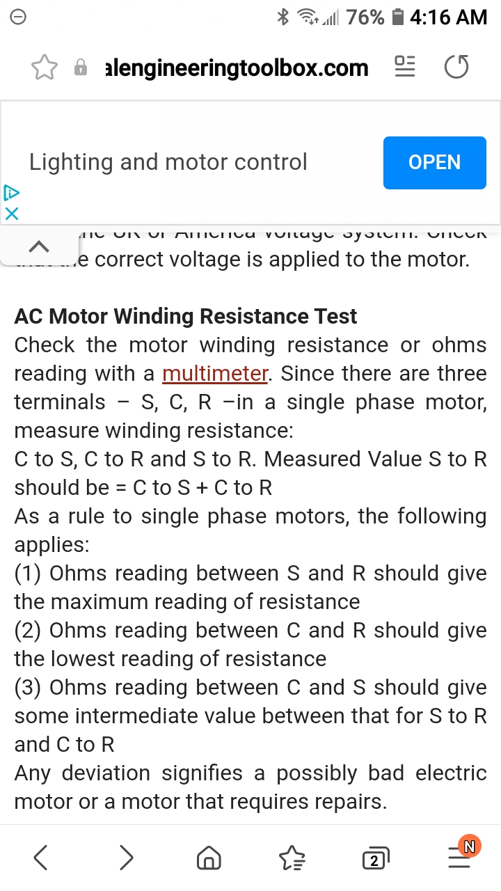

110volt wall socket. I,m a gear head not a sparky but know a little on that side. But I know burnt winding when I see then. There were just 3or4 winding wires burned into
Were they touched breaker switch wires . is there a way to maybe solder them back together and paint some kind of sealing over them. Or do those winding get to hot?
Just asking? I mean it will start up for a few sec,s before it trips again. I would love to fix this if there a chance weather than messing around with Tuxing. It is not worth

Test the windings.
Well that brings me to the question what would it cost to have that motor repaired by what I have told you? I,m trying to figure out should I just use this compressor for spare parts or
would it be worth repairing the motor if indeed Tuxing won't warranty it?
