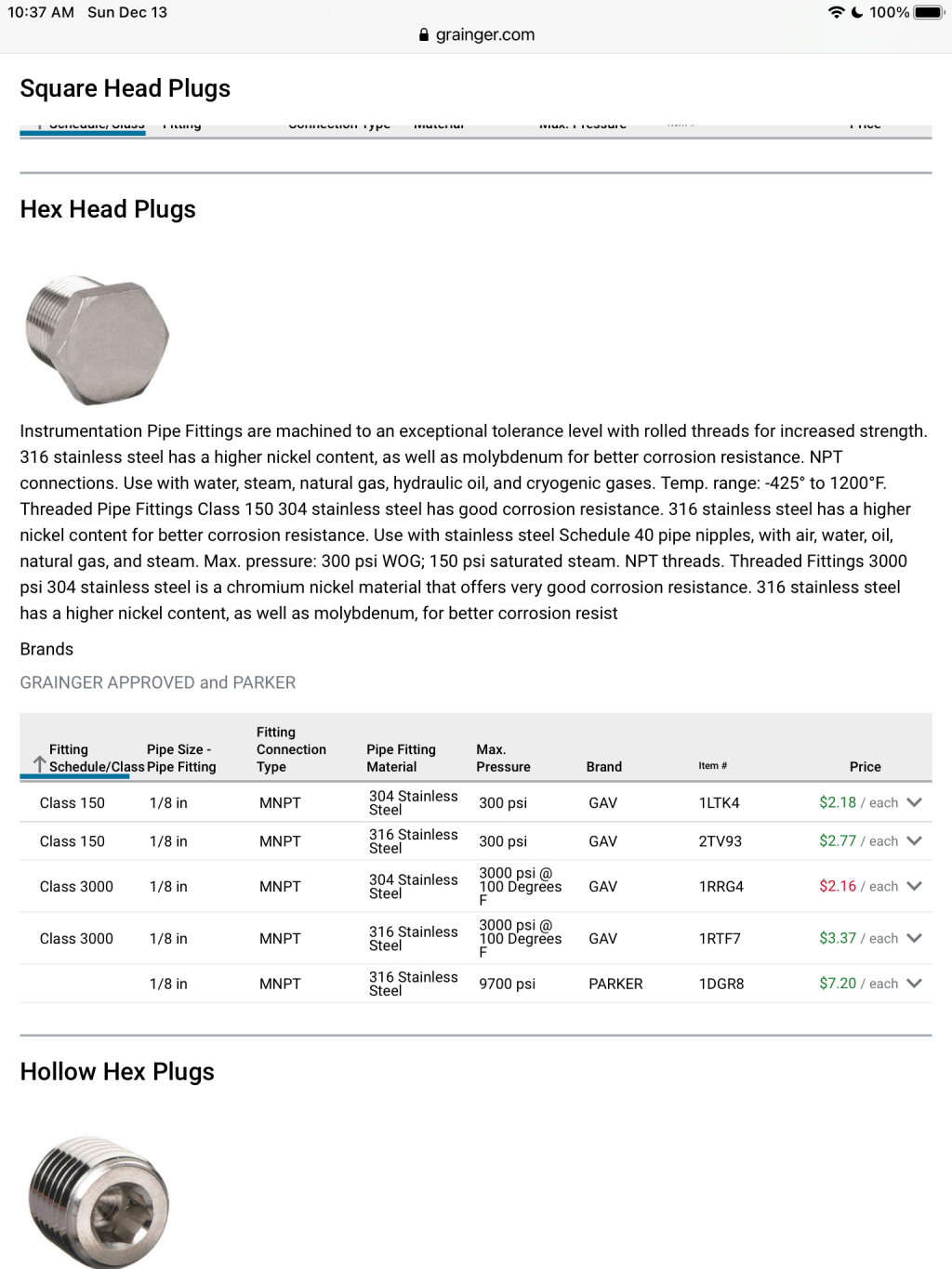

Would this work?
I assume I need the 5000PSI model since the compress can output 4500PSI? They are available in 300, 2750, 3000, and 5000 PSI versions. The 5000 PSI model is substantially more expensive. I have no issues spending the money if needed.
Looks like you have the SCI (Smith-Cooper) 304 2750 PSI model?
Same question here?
I used a female tee with the short pipe nipple to connect the tee to the compressor filter, then the gauge line and outlet line to the others to keep them inline with each other. 304 was all they had in stock at the time I have 316 coming in from parker pnuematics but I have had no issues with the 304 fittings. And the pipe plusg you show will work fine. Also when yo go to remove the gauge line. You must loosen and remove the gauge line from the back of the air pressure gauge first, be sure to use a open end wrench to hold the square back of the fiting on gauge and then use another to loosen the compression nut on the gauge line from the back of the gauge. There is an oring that sits in the fitting on nut side in a small recess make sure not to loose it. When I ran my initial breakin I left all as it comes from the factory after breakin then I made the changes to the lines and other items in my post. If you have any questions you can reach me directly I have PM you with contact info.

I purchased the pipe fittings bthurman suggested in his other post. Grainger didn't have them in stock locally, I couldn't find any local retails of stainless pipe fittings. Which I found odd in a city this size.I should say I couldn't find any relatively close to me. I wasn't going to drive all town looking for them either. The prices were about the same so I ordered them on amazon. I went with the Parker 316 high pressure fittings. Should be here today and I will install and update if needed.
Parker Tee
Hex nipple (304, but still high pressure. Couldn't find a 316 one. I'll keep looking)
Parker hex cap

I bought high quality steel 5000 psi tees on Ebay from seller faspartsusa. The tee was $10.88 but mine was 1/4 NPT for my Alkin W31. They probably sell 1/8 NPT fittings as well. Anyone buying parts needs to be mindful that they get high pressure rated fittings.

I’m going to return the Amazon Parker parts and order the titan stuff. Obviously Parker is top quality but the titan parts are about half the price of the Parker parts.
Not looking to cut corners, I see it the same way I see the oil, a couple bucks more for the right parts is worth it. I’m also open to paying less for the right parts :) if I could find the right oil for less money of course I would buy it.
I will trust you that they are high quality, high pressure, 316 stainless. Thanks for the heads up on the titan products. Wish you would have told me a week ago! :)
