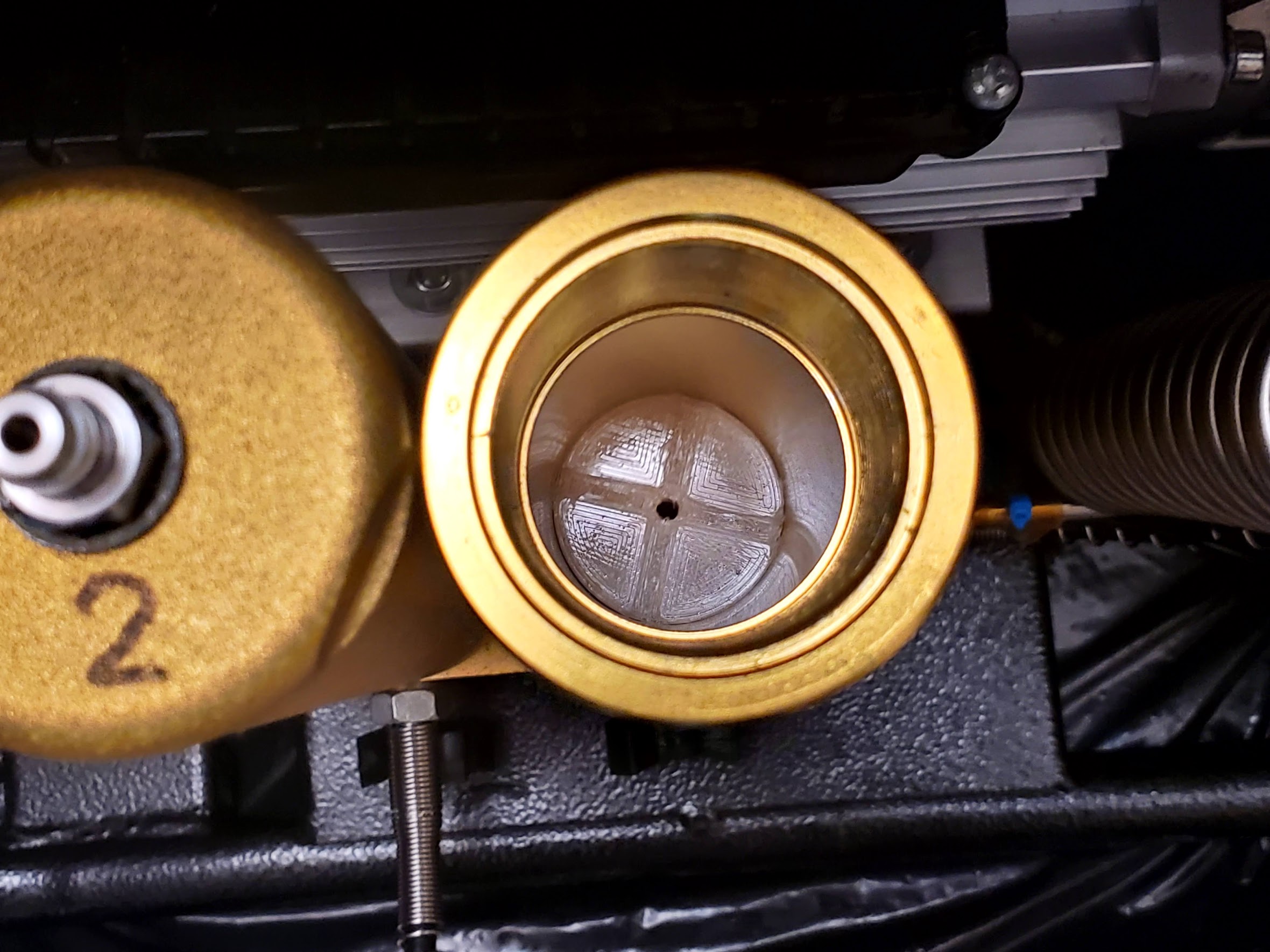

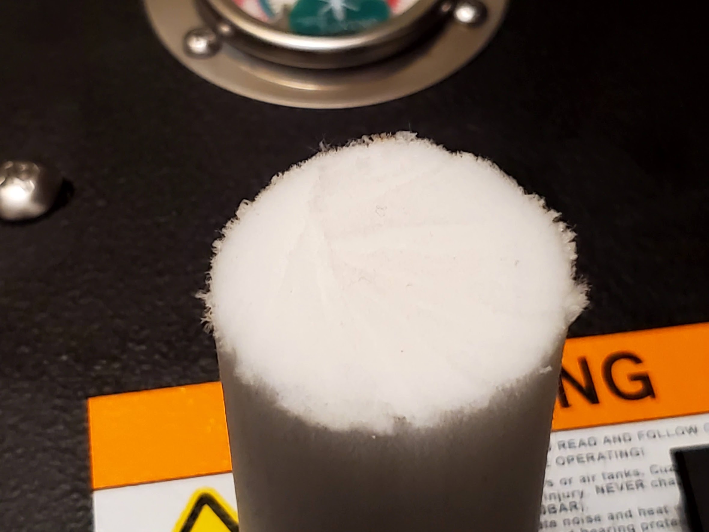

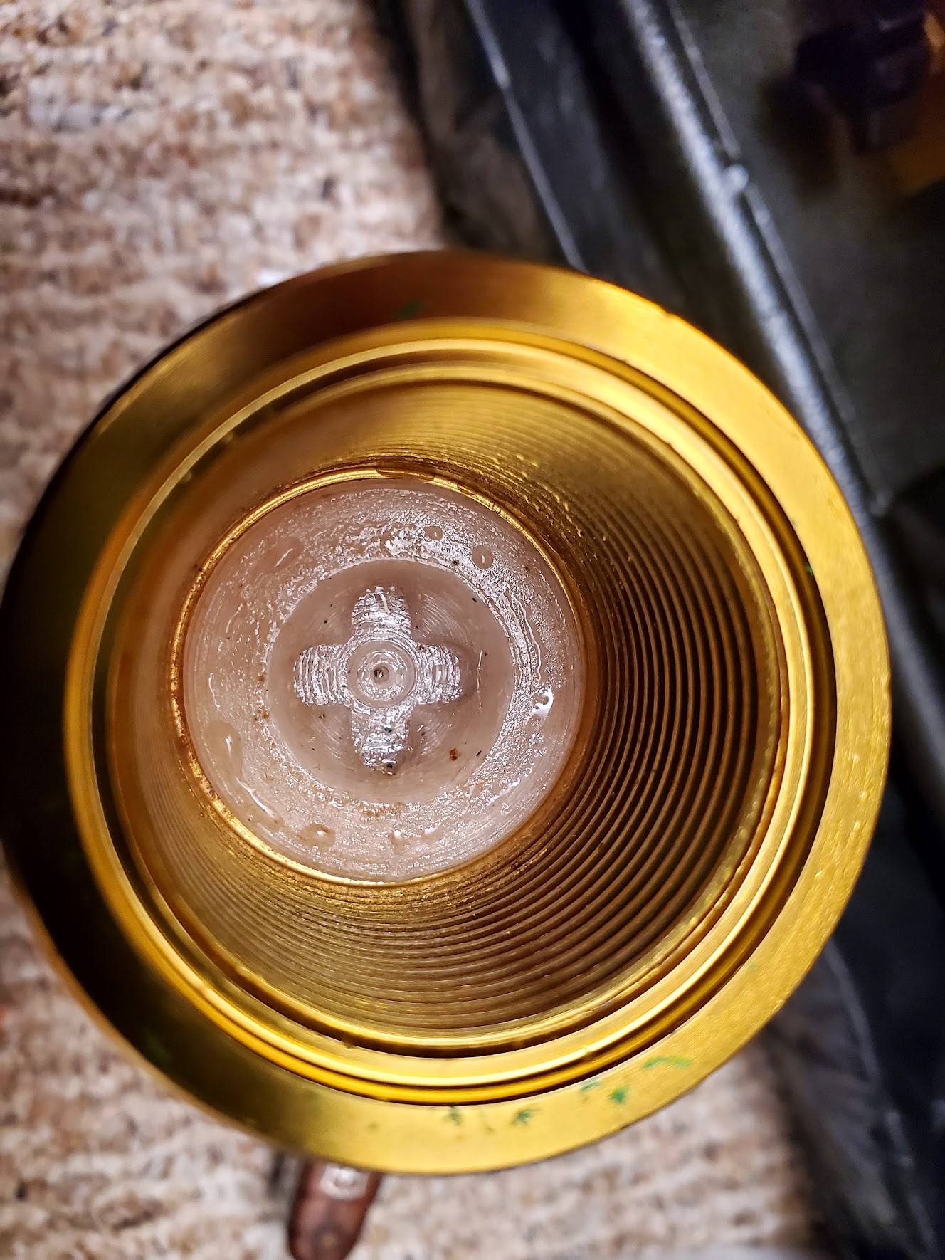

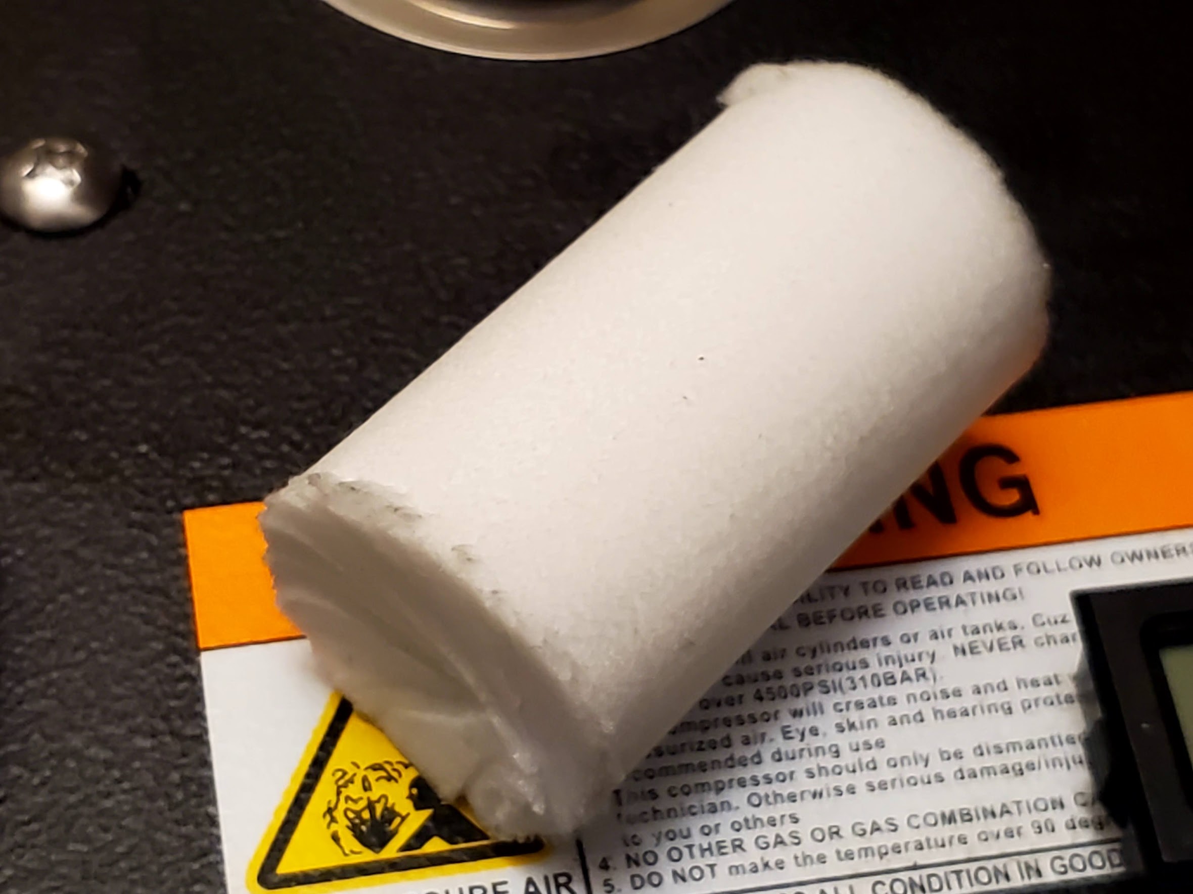

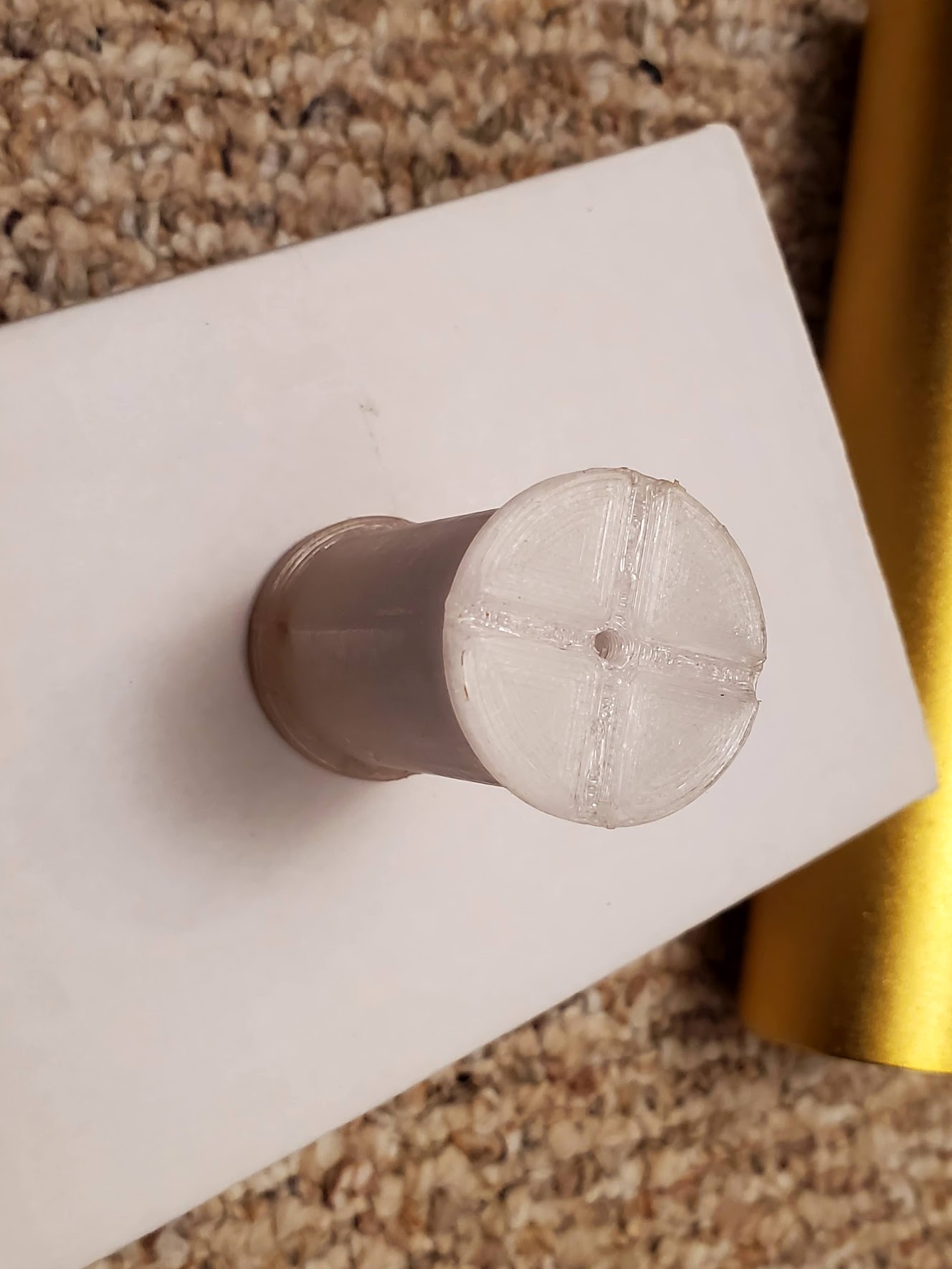

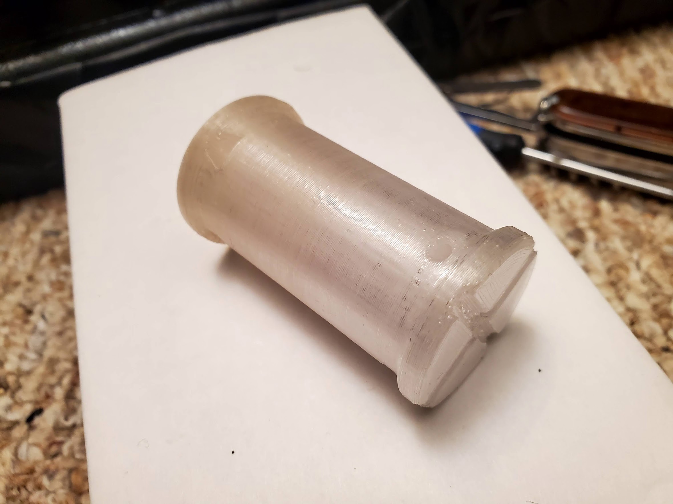

So now that I am able to get easy access to the inside of the towers, I tend to service the filters more often. What I've been seeing with this compressor is that the cotton filter in the first stage does absorb quite a lot of moisture and oil during normal operation, and simply purging the tower does not let all the moisture out. You really need to change the cotton tampon often, swap it with a new one and let the original dry. If you let it sit there soaked between fills, then you're basically humidifying the air that goes into the molecular sieve filter on on your next fill, which is kinda counterproductive.
I am not huge fan of this design anyway, a huge tube filled with cotton, and I've been considering replacing it with that orange Chinese coalescing filter, but I figured I'd try something else first.
I've designed a 3D printed baffle to put at the bottom of the first stage tower, with the shorter cotton filter on top of it (i simply cut the original tampon in half). The idea is to provide an additional stage of filtration before the hot humid oily air coming out of the compressor hits the cotton filter. I've tried a couple of things, this is the one that seems to work best so far and does not self destruct when you purge the tower. First the airflow is forced closer to the walls of the filter tube, giving the moisture an additional opportunity to condense there, then it enters a small cyclone chamber inside before it exits and hits the cotton filter. I was very surprised to see that it actually worked! All the garbage now stays south of the baffle, keeping the cotton filter dry and clean. I just just did a run filling up my Mini Wingman from empty to 300bar plus topping off two guns with 500 cc and 350cc reservoirs from 100 to 300bar. Immediately pulled the cotton filter, totally dry, not even a spot of oil.
This is how the baffle and filter look with 1 hour of runtime or so.
The main limitation is that you still need to purge the 1st stage every 5 minutes or so to release the moisture, there's not a lot of room inside to hold it. Not a big deal.
A work in progress, dimensions are not ideal, this is simply a tight press fit inside the tube. Will probably add o-rings to the design and reprint in a more suitable material...
Thoughts?
Thoughts?

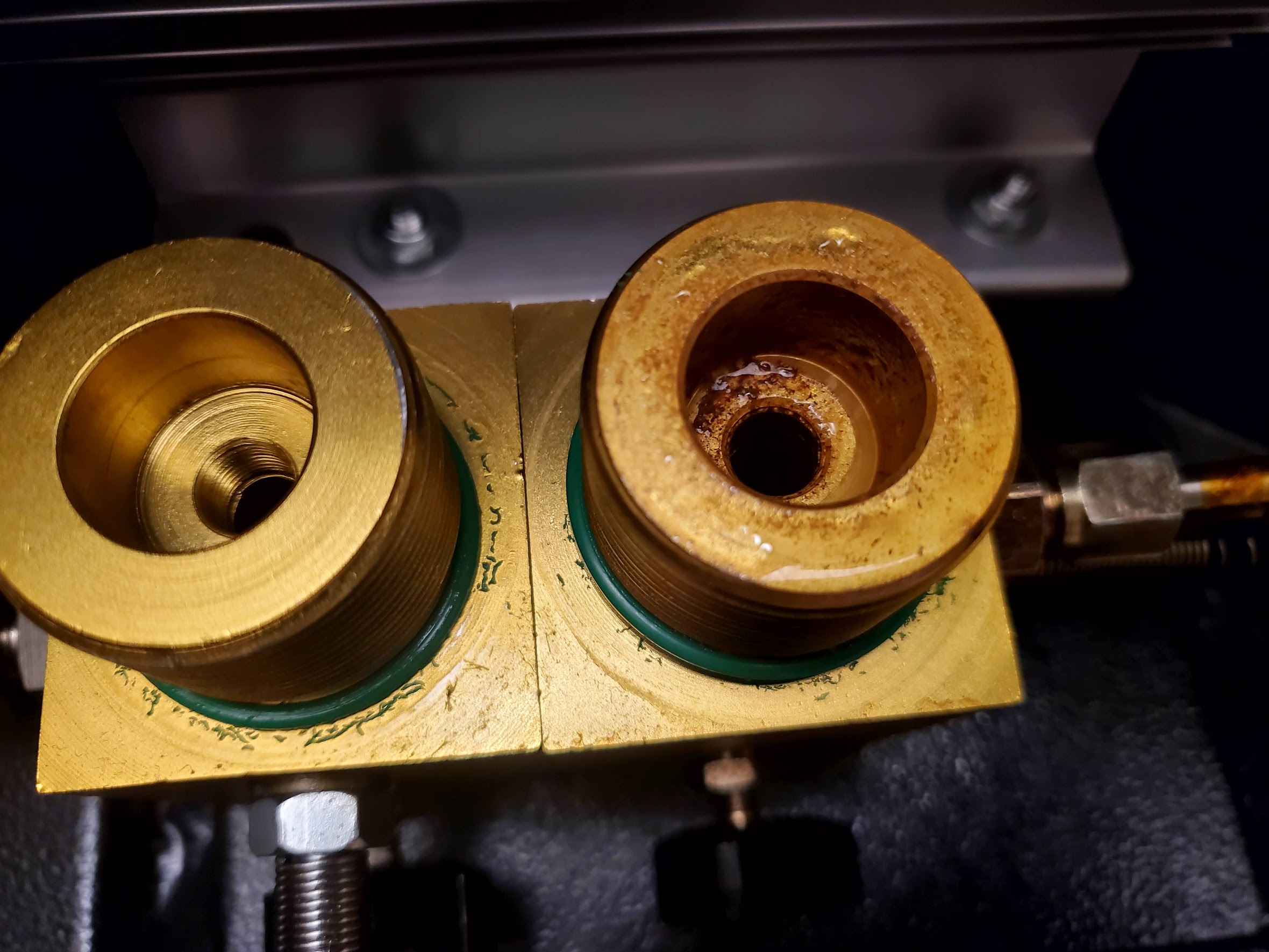

If you can create a vortex and slow the air down it'll condensate on the Alum walls, I'd imagine the best thing is to chill the snot out of the first filter. I'm still trying to get the darn things off, I'm going to have to get brutal or use a bit of heat to expand the tube and hope for the best.

The baffle works great. With it in place, there is no need to open the first tower too often. The cotton just stays dry and clean. Should I release the stl?
I would not go too crazy with heat on the aluminum tube that contains 300 bar... I got mines off using a pipe wrench. Marred the finish on one tube a little, oh well.
Yeah I'm thinking of adding a fan to cool the fist tower and the coiled stainless tube that feeds it. Can't hurt.
Yeah, the pipe wrench was going to be almost my last resort, , it wouldn't take too much heat to expand the tube, a quick blast with a propane torch should, in theory do it, only need a few ten thousands of an inch, unless they locktite'd the sucker. I put a Molecular sieve as my 3rd filter, luckily I live in a low humidity area anyway so it helps. Well it was, today it's 52%.

Thats where a strap wrench comes in play .less chance of marring things up
Strap wrench slipped.
It's just a bad design to have the o-rings placed at the very end of the pressurized tube, allowing moisture and crud to accumulate in the threads. Not to mention that the threaded portions are thinner and therefore weaker. Looks like the tube is beefy enough for this not to be a problem, but still.
When you reassemble, put LOTS of silicone grease on the threads. Makes it much easier next time.

Yeah, I tried a strap wrench and it just wasn't happening, I wasn't horribly worried about it, I did check #1 AFTER I FINALLY got the caps off and only the first 3/4" had any sign of moisture and it wasn't bad for 5 hours. I drain every 10 min, just crack the drain a tiny bit until the moisture stops. I never did get the cap off of #2, I needed a much larger hammer on my 12" wrench and 3 hands. i didn't want to screw it up too badly. Now that I think about it, I may, when I get them open, take out the filters and squirt a TINY bit of Tai-Flow down there and let it do it's thing for a few days.
