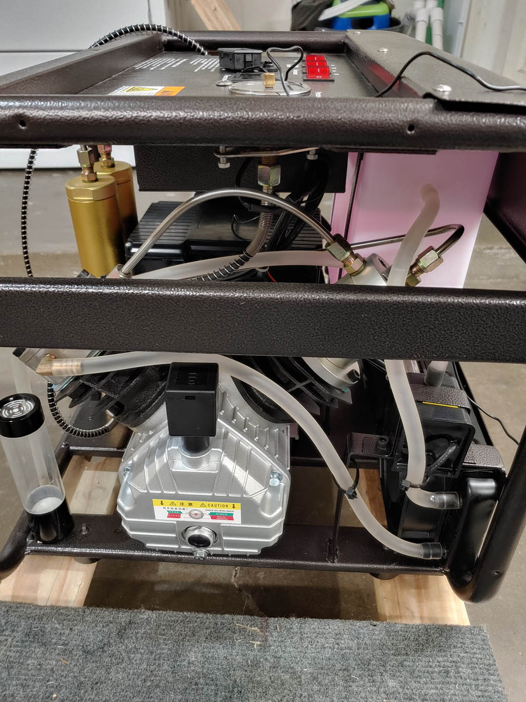

I did reroute the 2 water lines going to and from the cooling radiator to get them away from the cylinders, there is plenty of water line just bring them forward of the cylinder.
(see pic 3 above.)
Also the ouput air line cooling coil, I removed the tie wrap because they had it right up against the water fitting. I added a tie wrap to allow it to spring away from the water connector but still hold and stop the coil line from vibrating. I added a second tie wrap to hold the air pressure gauge line to the connector so it was not free floating around.
(see pic 1 above)

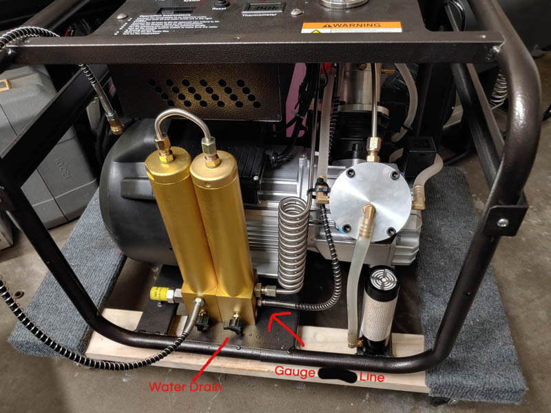

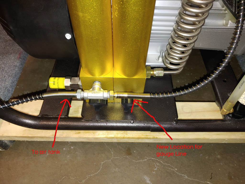

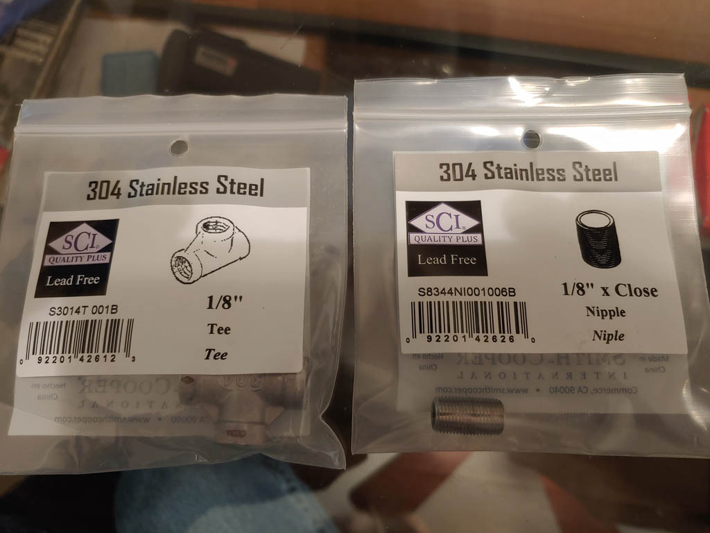

TIme for an update: After running for a couple weeks I noticed on the longer run times the compressor would shut off and the tanks would be about 200 pounds liter on air than the compressor gauge. I also noticed that they had installed the airline for the compressor gauge at the bottom of the water trap by the water drain ( see first image). This allows water to be pushed into gauge line affecting reading IMHO and possible future issues. I decided to make a change and removed the line from original position and plugged then installed a SS tee into the outlet pressure line, and installed the pressure gauge line there (see second image). Now the compressor gauge and tank match no matter the run time. This will also stop any future issues of water possibly damaging the compressor gauge. I also changed out there 3 part internal silca and charcoal for 13x Molecular Sieve beads (see image 3).The compressor continues to run very good I use it to top off my two 100Cuft drager tanks I use in the shop. From 3000psi to 4500psi it does its work in 11 minutes. I will post shortly filling a 74 Cu ft tank from empty to give a update on times and temps for a bottle from scratch. So far very pleased with operation.

Where did you pick up the T adapter to move the air gauge line, what is the threading? What did you plug the hole with where you removed the original gauge line?

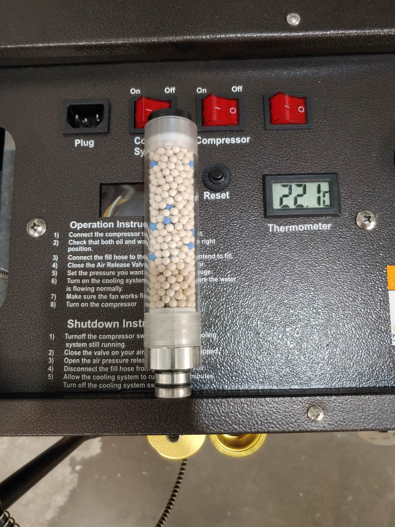

Did you just remove the silica and put sieve in its place or did you buy a new insert to put it into the canister? Where do you get the sieve from?

iflysky: They are 304 stainless Tee and a close nipple I plugged the original gauge opening with a stainless plug, they are 1/8 inch threading. (see image) Each of the ports have a delrin seal disk but I also wrap the threads a couple times with Oatey fast tape thread sealer. I purchased my stainless fittings locally at a supply house here, just call around in your area some one will probly have them just make sure they are stainless steel to be able to handle the high pressure. I removed the silica from the original plexi tube that come with the compressor and placed one filter disk in the bottom of tube and one on top with the 13x molecular sieve in between. (there is no need to replace the exisiting internal tube). I purchased the sieve from www.shopbvv.com

One thing I wanted to verify reference the Tee. I couldn’t exactly tell from the pictures, but it looked like in the pictures the Tee was a female to the compressor and male on both hose ends. But in the picture you just sent it looks like the Tee is female all the way around, is that correct?
