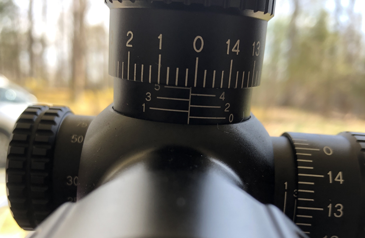

Turret alignment issue on my Athlon Argos BTR Gen2 6-24x50
Now that I looked at the photo, I see the indicator sleeve is offset to the right, that sleeve is the part on the housing with numbers on it indicating which revolution you are on, and it's glued on.
I've seen the marks not line up perfectly on other brands including Vortex, it's not uncommon, especially on cheaper scopes. I had a $1500 Bushnell LRHS that was off a little bit.
Anyway maybe try the acetone thing if you want or send it back.
