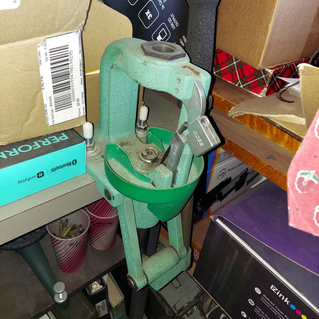

Does anyone use their Rock Chucker for a press. I noticed Corbin doesn't offer the dies anymore. Any alternatives.
It's not really necessary to alter the press (though some do) - it's just the dies. I can't recall his name, but there's a (powder burner) benchrest guy that mods presses, but it's all about increasing their longevity - boring open the pin holes and bushing them with bronze bushings and perhaps larger pins - stuff like that. Just to get one to swage, you need nothing of the sort, and unless you're loading many thousands of slugs you'll probably never wear down an off the shelf 'Chucker. Another possible mod is an ejector. You need to pop the finished slug from the die, and that's usually done with pressure from above. In my simple setup it's just a post that I rap with a mallet. You can get die springs and set one up to eject automatically though (the Corbin presses do this).@GeneT I too am interested in learning how to alter this type of press to accommodate airgun slug swaging dies. Any more insight in this regard would be appreciated.
@Motorhead I thought we were about to strike gold here with your answer. We gotta figure this out. I gotta revisit some old threads I read a while back. I like some what @GeneT is saying about modding the dies.No .. but would if I could![]()
Agreed, it's a solid press with the ram being supported with about 4" of bearing surface.The Rock Chucker (in all 3 (4?) of its incarnations) is more than capable of swaging pellets. I have swaged 9mm and 40 cal bullets with one, and know several (powder burner) benchrest guys that routinely make 6mm jacketed bullets on them. Dies are the issue. I've been meaning to try to make some, but that's not an option for all. Nonetheless, the press is not the obstacle...
