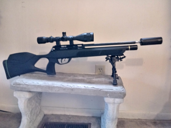

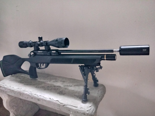

Came up with a spacer of my own to give a slightly more finished/complete look.
So the sleeve you made basically covers a little bit of the threads and the mess left behind from removing the original. The pictures are a little blurry but looks good from here. Hows it sound? How does it shoot now? I'm particularly interested because I'm considering not using the shroud on my Marauder and just using a v2 Emperor.
I am not sure if the bare barrel alone can take the weight of the Emperor. Let us know how it shoots after you do it.
Its about the same sound level as stock but its shorter and looks Much better (to me) than stock,which looked rather cheap and toy-like. It shoots as though it has a BSA hammer forged barrel,which is to say..Excellent! No pellet clipping or related issues. Quite a nice little well built rifle. ESPECIALLY when the low price is factored in!
