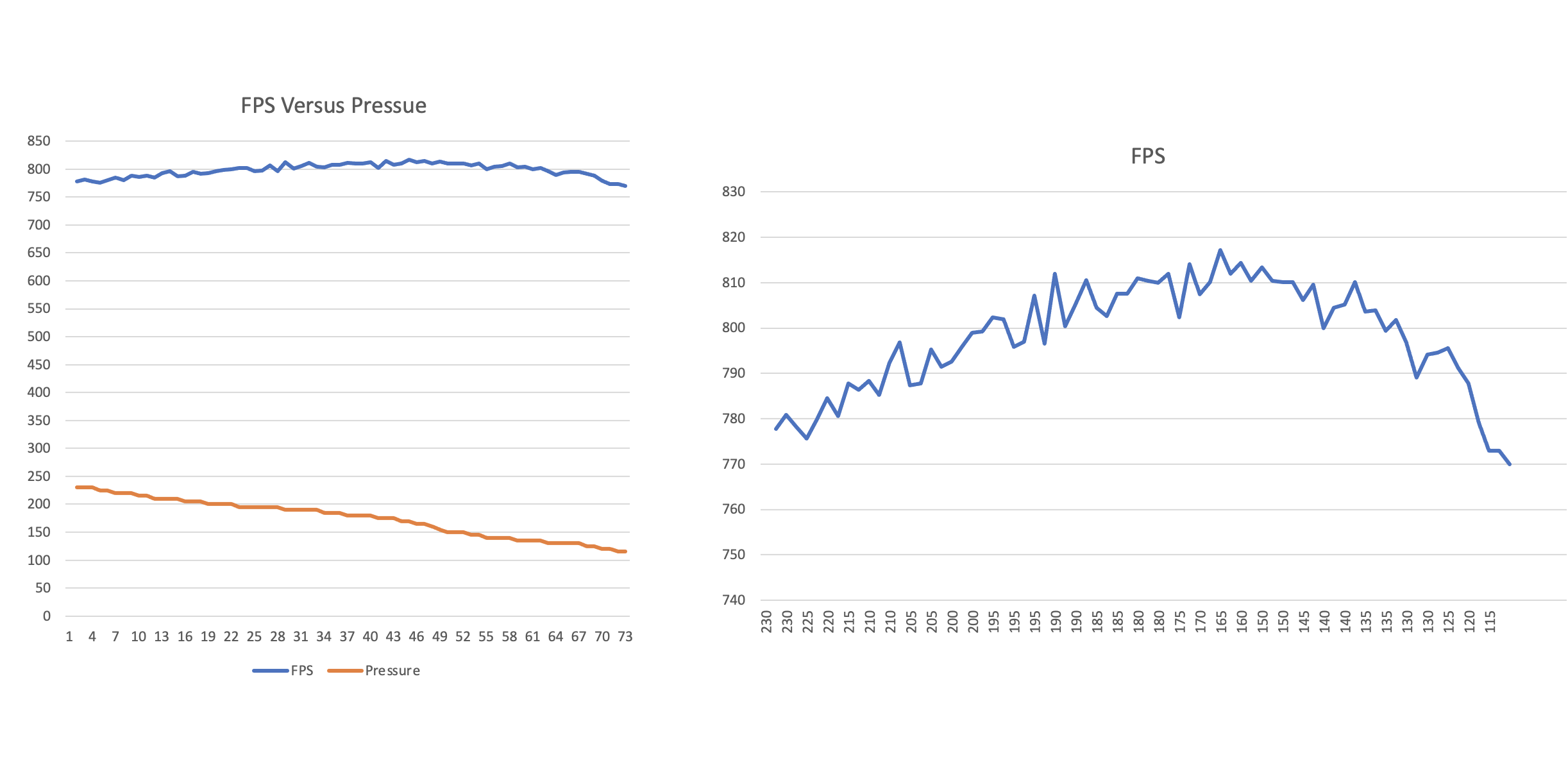

Okay Got my son out and we recorded the shot string.. Kinda fun.. I managed to maintain a 1" vertical through the whole range pretty much at 30 yards.
I started at 230 BAR and seems about 210 we start a flattish curve all the way out to 130ish.. Gives about 50 shots in that range.
Let me know what you guys think..
Also this was with hammer spring mostly fully in.
Mike
