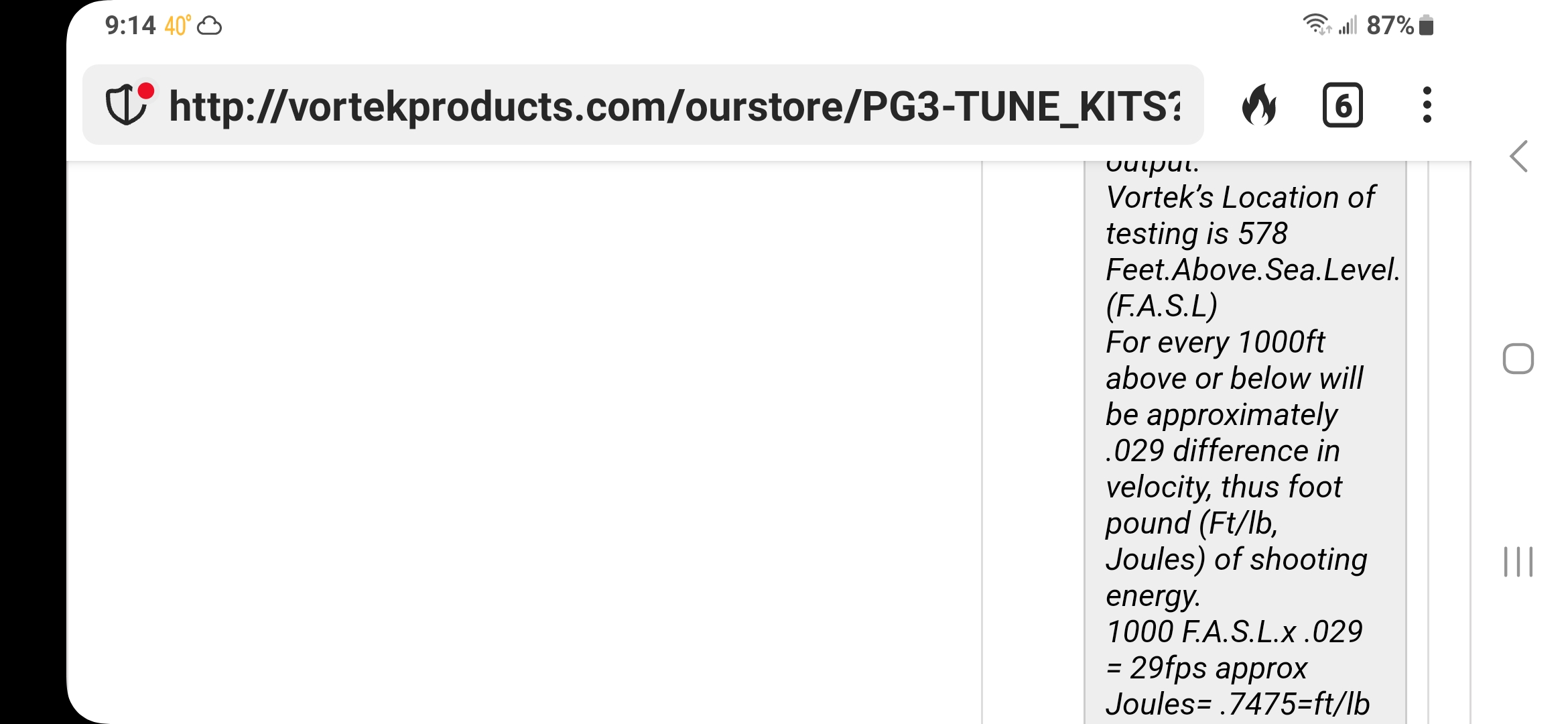

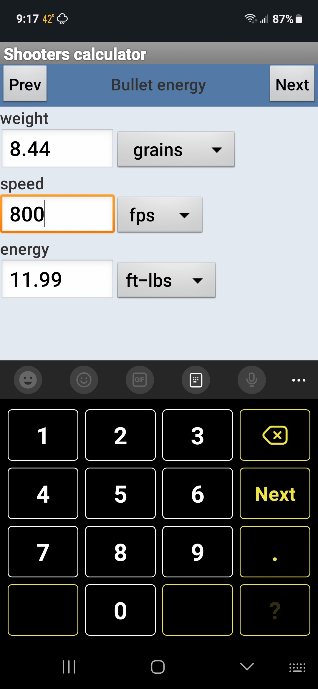

1000 feet of elevation makes a significant difference. At least according to this formula found on Vortek's website. When practically applied my HW50 which makes 11.99 fpe at sea level would only make 11.28 fpe at 1000' above sea level. That's a significant difference.
