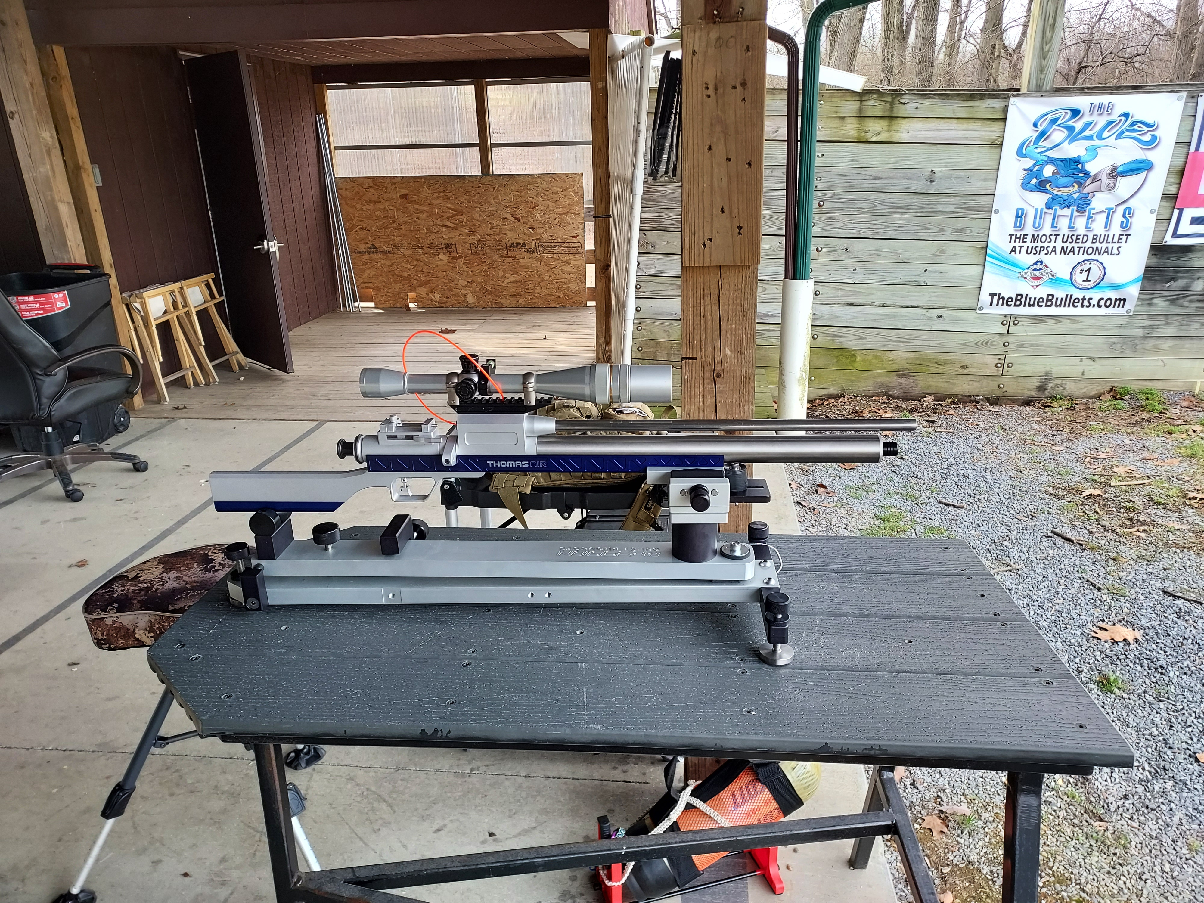

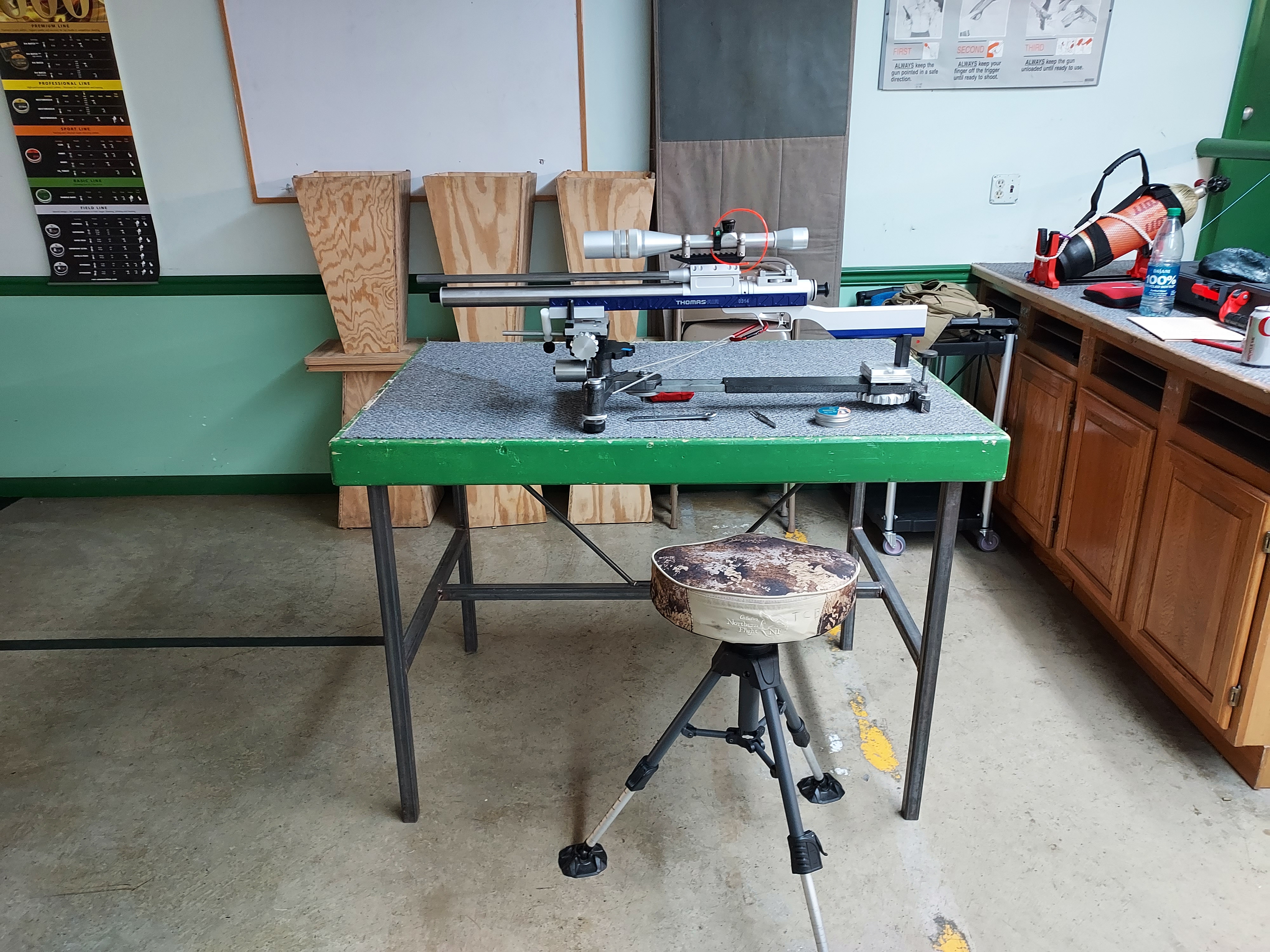

I combined the setup procedures listed above. I executed the hammer spring adjustment optimization process as part of the procedure and when finished all settings - jet screw length, jet screw taper, hammer spring adjustment knob position - were the same.
The greatest effect on accuracy was changing to a one piece pendulum rest with a mechanical top ( no sand bag).

What is a “pendulum rest”? Are you using a bungee on the new rest?
I found bungee cord is a bit too springy.
I use two strands of 40 mil Spectra as the core of a 23.015 meter cobra braided parachute cord that is knotted into a 9 foot diameter monkey's foot with a 1.6 ton pure cobalt 60 ball bearing core having a 75.0173 micron thick Zirconium surface layer.
The Cherenkov radiation burns like a bitch but once you get the gun duc taped tightly to the monkey's foot, your POA will never shift.
At least while you are still breathing.
