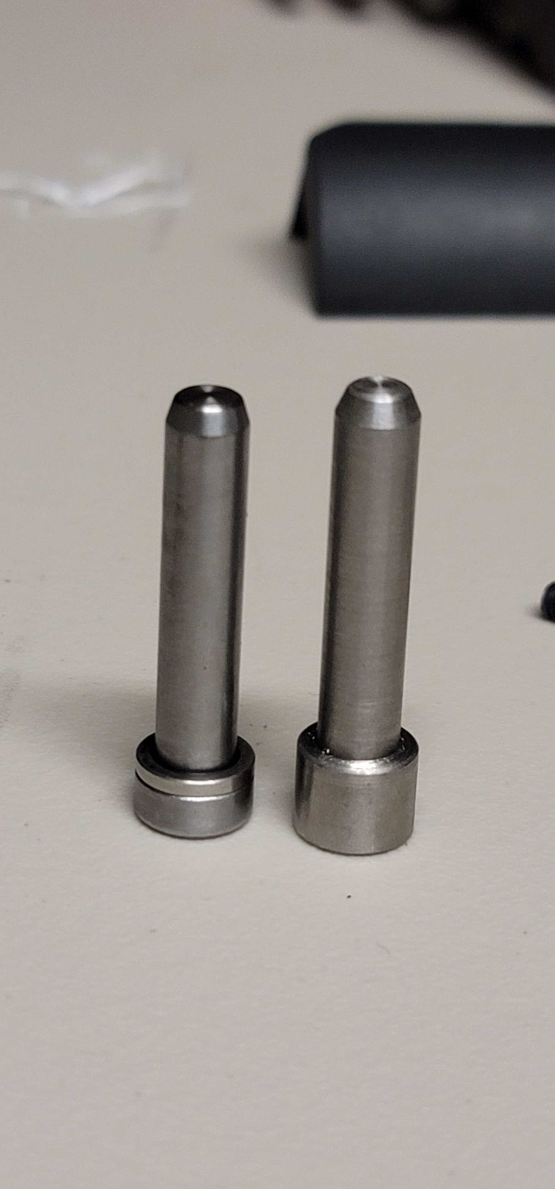

You probably have the same issue I had with my Maverick .30cal, and that is the hammer weight that they sent with the airgun is too light.
Remove the hammer weight by removing the stock (just 2 screws). Then you will remove the power wheel, but you have to be careful, as there is a small ball bearing that is used so the power wheel moves to the detents. It should stay in place by being held in place by silicone grease.
After that, peeking down the exposed shaft, you will see you can turn the gun over and shake the hammer weight out.
There are 4 types of hammer weights for the Maverick/Wildcat BT (3 standard and 1 tungsten), and you need the 3rd heaviest (the heaviest standard one), and it looks like the one on the right. This is the 14 gram hammer weight. My airgun arrived with a lighter weight on the left, and because of this, there was not enough force to open the valve fully.
After getting the heavier weight from FX, everything worked as expected.
Most likely a hammer weight issue. I use the 8mm hammer on my WC BT when I crank the reg up to shoot slugs out of my 600mm 22 barrel kit. So, I'm guessing with that 500mm 30 cal, the reg would have to be up there to get a 44 grain pellet in the 850-900 range.
Not certain, but I think Rick, aka shooter 1721 on youtube was getting in the mid 900's with a 150 bar reg on his 30 cal compact bt. My guess is with that kind of reg pressure, it's the 8mm hammer weight. I would call FX-USA and order one.

My maverick arrived with the wrong hammer weight also. I think the issue is they use different hammer weights for different calibers because different calibers use different reg pressures. I think this issue is so common, FX just sends out a heavier hammer weight upon request.
The stock hammer will not open the valve adequately at 150bar. If you reduce the reg to 130, you will find that the speed increases to around 870-920 on level 7, depending on the hammer screw setting, as mentioned above.

Checking my notes, my silver (stock/came with the gun) FX hammer weighs 12.5 grams. It’s the one on the right on N15s post above (time stamped 3.15). The Huma hammers are 13.2 and 14.5 grams. I also have an FX tungsten hammer, which is around 20 grams but I’ve never used it and can’t imagine a scenario where it’s needed, given that the larger Huma will work up to 160bar!
