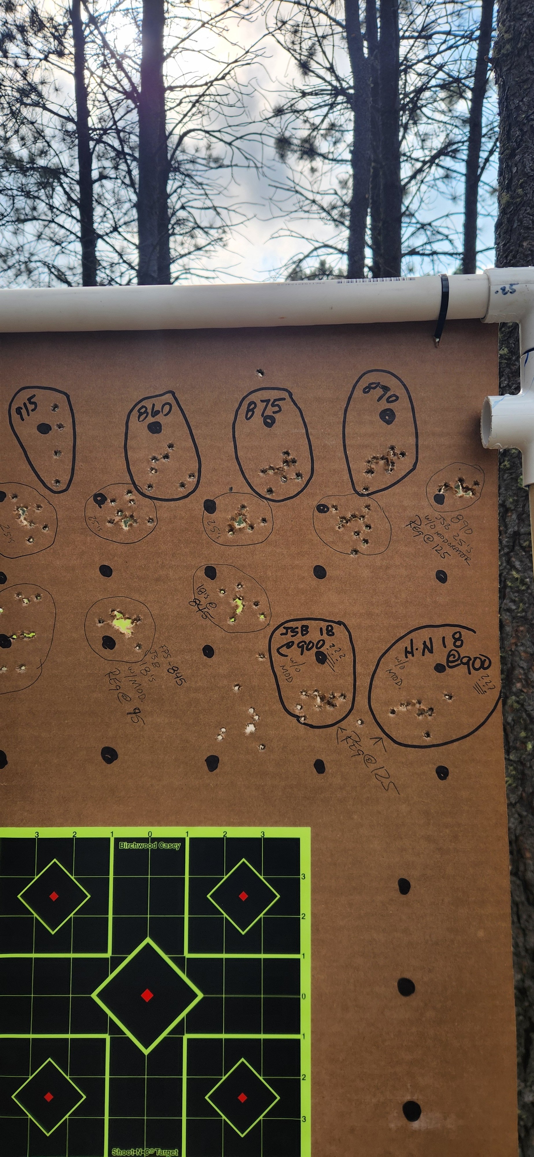

I'll try to post a picture of the target but unsure it will load as our internet hasn't been installed yet. So here's my first dilemma, clean chrony and barrel.

So I start playing with speeds even went so far as to dump the air and start over from 85 bar on the reg. The rifle seems to want to shoot 844ish and 914ish. Really nothing in-between. Not yet anyhoo. Letting her charge overnight, wishful thinking? And maybe tomorrow afternoon I'll get another chance at it.
