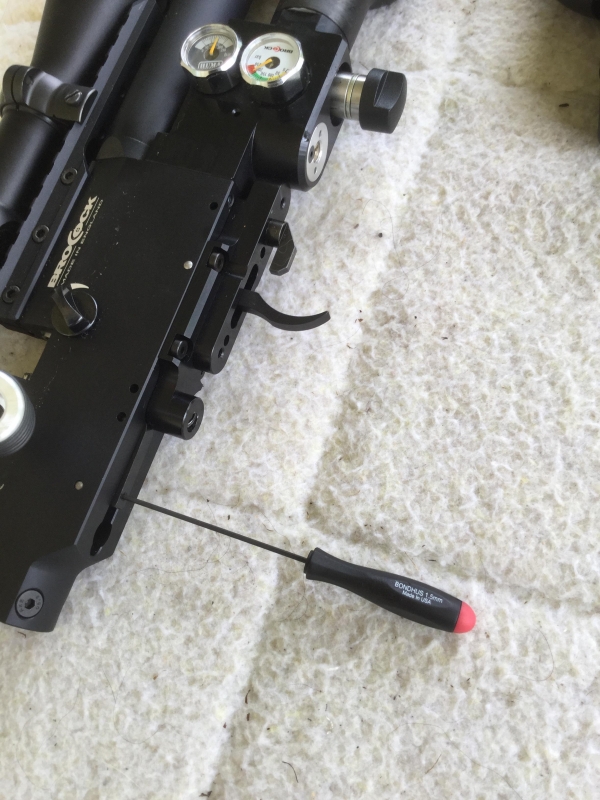

Trigger pull adjustment

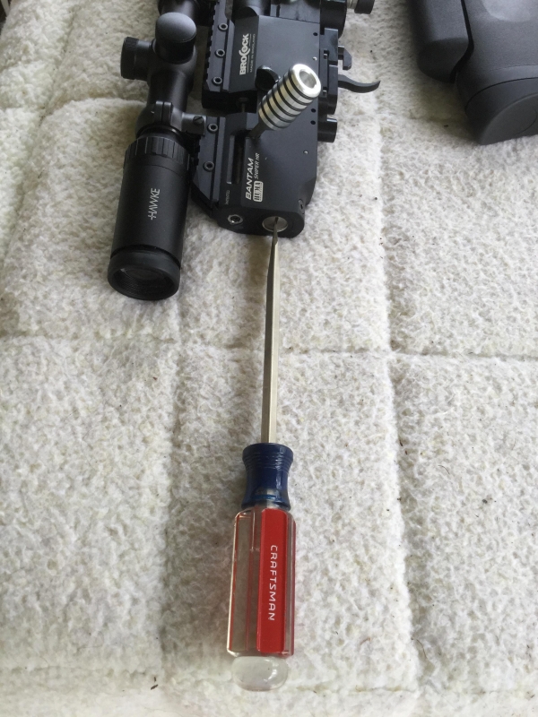

Hammer Tension Adjustment and where to put threadlock

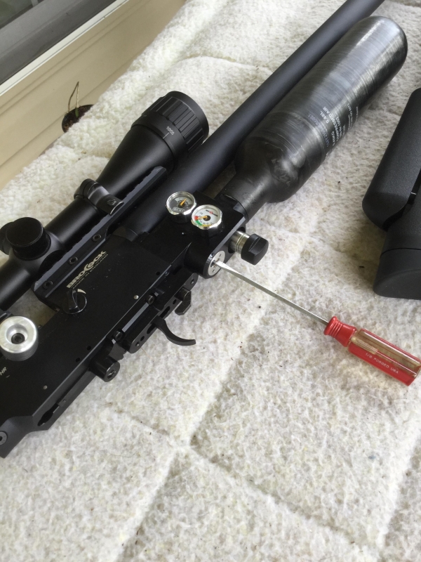

Regulator Adjust screw

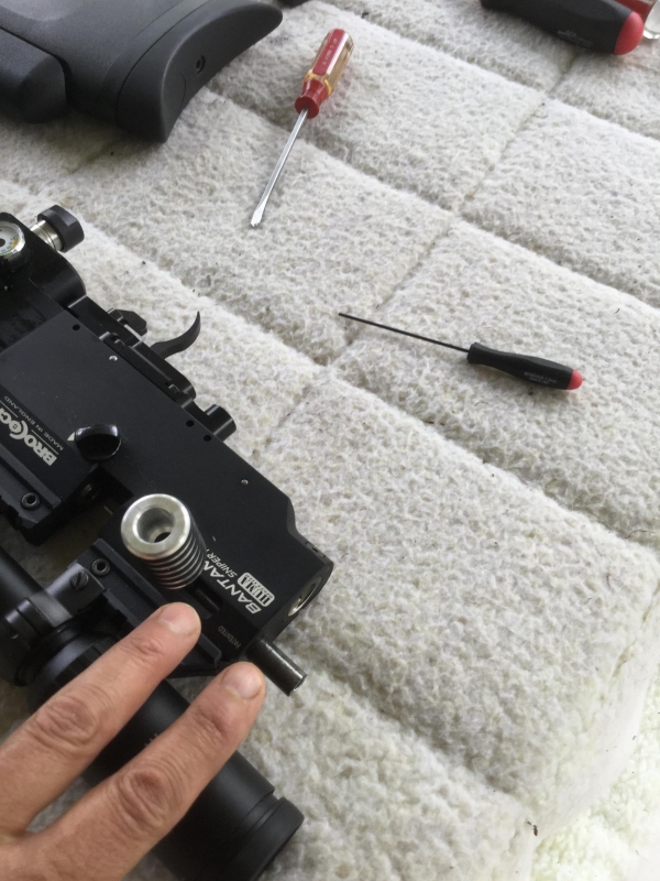

Where to Lube bolt with Moly

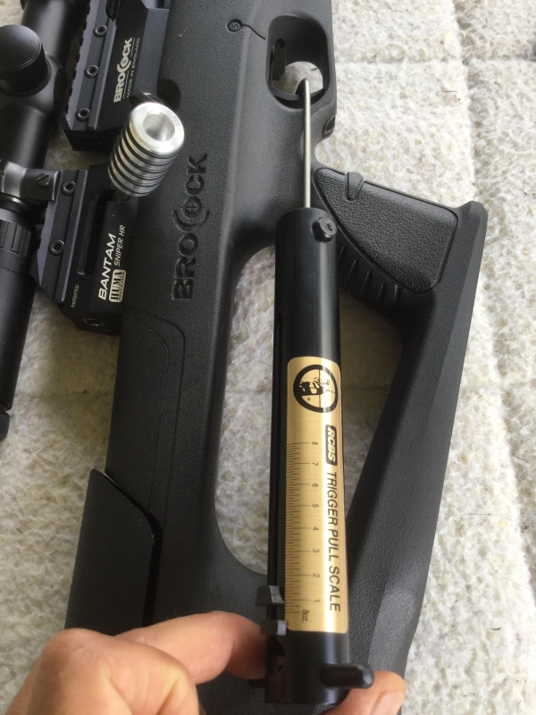

My trigger pull weight post adjusting
