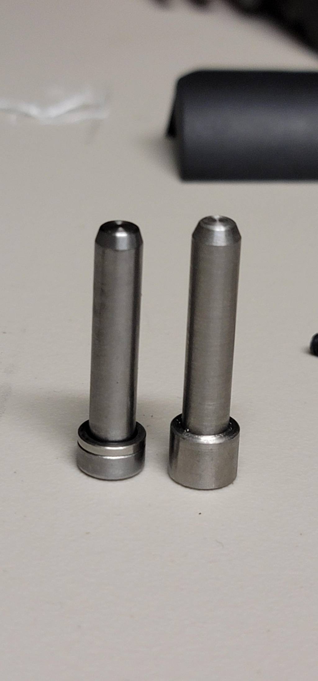

I got in the slug kit, and it came with a heavier hammer:
It was already difficult to clamp down the barrel to remove the retainer, but once I finally got that out, nothing on earth would get that barrel liner out of the barrel housing! I even clamped the end of the liner in a vise and pulled with all my might, and it wouldn't budge! After messing with it for over an hour, I gave up, after I almost messed up the STX Superior Liner crown, so I'll run it without the carbon fiber sleeve for now. I already got another barrel in my shopping cart just in case I damaged this one. 😔
I'm about to retune the regs with the new hammer and try to get some groundhog pesting in before dark.

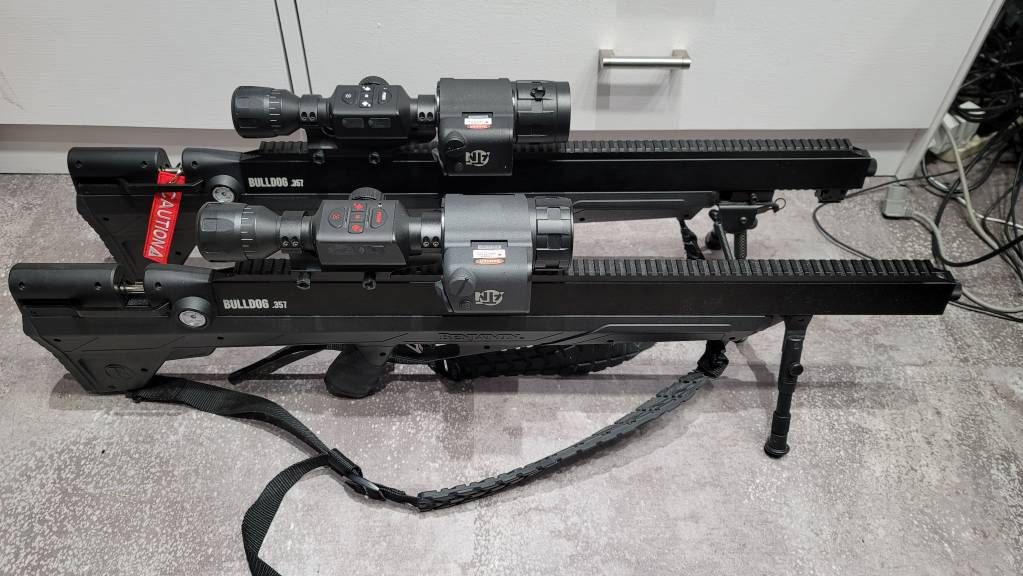

I meant to ask you about the rail alignment. When I sighted in my scope, I had to add a significant amount of horizontal adjustment to get the scope to zero. For instance, my Bulldog needed 31 units of horizontal alignment, but my Maverick needed 181!
Is this because of some cant in the pic rail? I've seen some people complain about this, but I don't know what I'd have to do to fix it if that's the case.

I had the exact same issue. I'm set at 170 140 and 7 on the power wheel and I was getting low to mid 700's weird thing is when my tank gets down to about 130 bar I start getting more power in the 840 to 870 range, but I'm getting no where close to even 900 so I asked the shop I got it from and he said my gun had the lighter 11gram hammer instead of the 13 gram hammer. He's having FX send me the correct hammer. Anyone else have issues with the gun being weak at the top of the fill and more powerful at the bottom ?
I know exactly why that is!
Your hammer isn't heavy enough to overcome the second regulator pressure, so it can't open the valve fully. When your bottle starts to drop in pressure, the first regulator is out of the picture, and when the bottle drops past the second regulator, the pressure is low enough so your current hammer is heavy enough to open the valve more.
I just bought the slug kit for the Maverick for .22 and .25 cal, and it had the heavier hammer weight in it and just used the hammer, and now I'm running great. I'm running around 155/135 and get a consistent 930 fps with FX Hybrid Slugs on 7, and 880 with NSA 54.5 gr slugs.
My 6 shot group has a spread of 4 and standard deviation of 1.8. Velocities gradually come down as I go to from 7 to 1, which is exactly the tune I need.

Your hammer isn't heavy enough to overcome the second regulator pressure. When your bottle starts to drop in pressure, the first regulator is out of the picture. When the bottle drops past the second regulator, they pressure is low enough so your current hammer is heavy enough to open the valve more.
I just bought the slug kit for the Maverick for .22 and .25 cal, and it had the heavier hammer weight in it, and now I'm running great. I'm running around 155/135 and get a consistent 930 fps with FX Hybrid Slugs on 7, and 880 with NSA 54.5 gr slugs. with 3 turns counter clockwise.
I'm currently very happy with room to spare!
