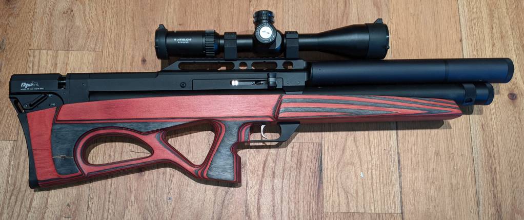

Tuning my .177 R5M Edgun to high speed w/ heavy slugs
I know I've seen along the way threads where folks talk about 20gr slugs at 950fps from a .177 R5M Edgun long.
I think I want to do this to mine. Right now it's tuned for field target 20fpe and is accurate to 50yds.
Can anyone aide me in doing this? I've never needed to take my edgun apart and am not familiar with the procedure.
