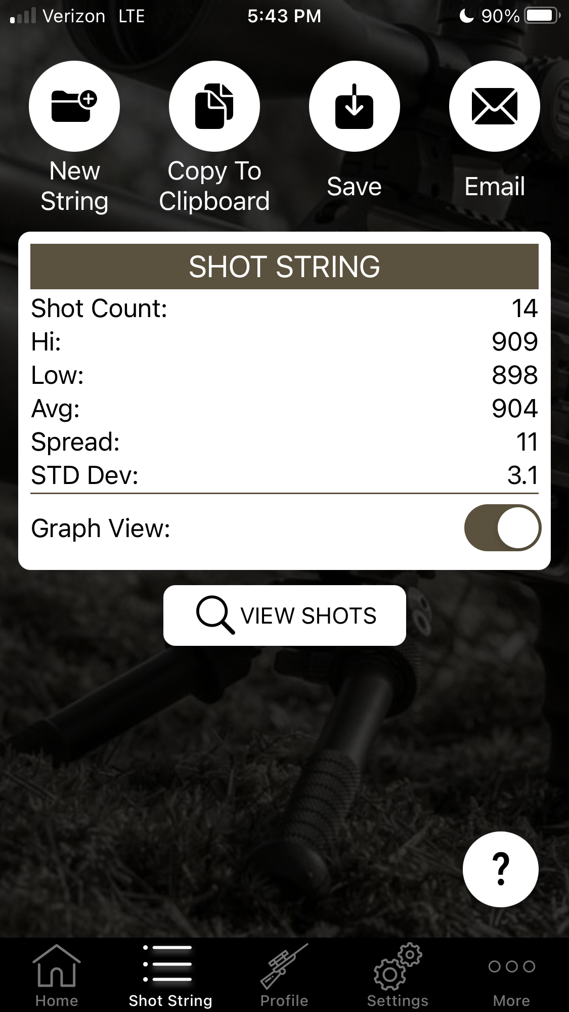

In case anyone else runs across this. I just got an m3 and threw a 5 min prelim tune on it for 25.39. Haven’t checked accuracy but speed is very consistent. First reg is somewhere 130-140 bar. Second reg is 90 bar. Macro 8, micro 2.5. This setting with valve adjuster open yielded 920 fps. I cut the gun with the adjuster to 900 and it seems very consistent. Not sure exactly where that adjuster is…between line 3-4.

My initial shot string with above settings.
The very first shot after sitting for a cpl hours was the 898. Take that shot out and the spread was under 10 fps. Can only shoot 35 yards right now so it’s tearing the bullseye out of course. Was super easy to tune only taking minutes for pellets. The second pic is another 10 shots with no sit break an superb accuracy at 35. If anyone is trying to compare the Maverick to the m3 I can clearly see where the extra 400 dollars is after just a couple shot strings on this. Worth the extra 💰.
