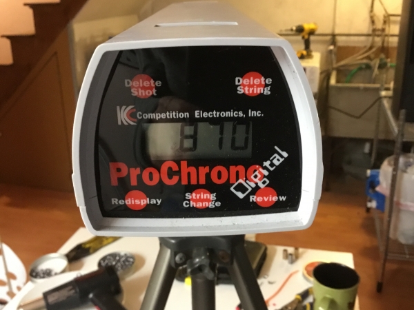

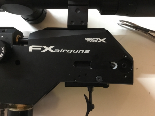

As my max FPS with a 44.75 g jsb pellet was between 825-830 FPS at 135 bar regulator pressure and increasing pressure resulted in reduced FPS, I figured there was not enough hammer spring tension to keep the valve open at higher pressures. I tried adjusting the hammer spring screw, but it would not move even when I warmed it with a heat gun (moderately, as I didn’t want to melt any o-rings.) As a temporary fix, I wedged a small piece of nylon washer over the end of the hammer spring screw to take up 1.5 mm of slack.) This resulted in 870 FPS at a regulator pressure of 149 bar. I guess I should try to get the adjuster screw loose, but as I have no plans to adjust to lower power ( unless accuracy suffers at 870 FPS) for now I’ll just shoot it like this.
