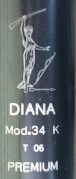

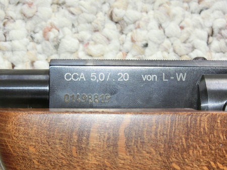

I have that kit, but as far as performance before I installed it, I can't tell you since the gun didn't come with stock internals and already had a kit in it. Hector from Connecticut Custom Airguns had an idea 15-16 years ago to build some D34's. Diana agreed, Hector supplied the parts he wanted and Diana built 30 rifles for him as Diana D34K Premiums including the laser etched marks to denote the custom builds. His parts were an L-W .20 cal barrel made to his specs and way back then, something called a Black Ops spring kit.

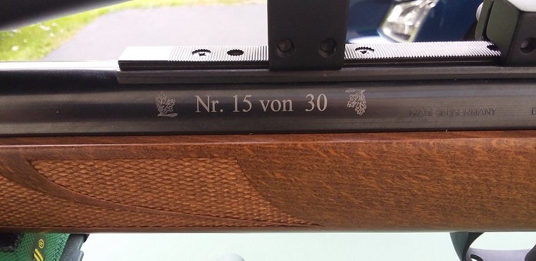

I asked a couple years back if he actually still had any since several were bought by him to fill his 30 gun agreement. He said yes, we came to terms on a deal and a couple weeks later, #15 of the 30 made got delivered to my door.

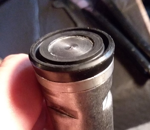

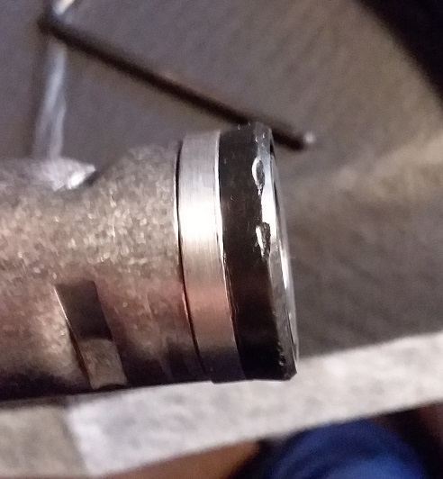

I thought it was a little underpowered at a touch over 12fpe so I got it apart to find Diana had gouged up the piston seal on install and pretty overlubed. I bought kits from both Vortek and ARH. After installing, testing and trying both, it currently has the ARH spring kit with a Vortek seal in it that raised the numbers to a touch over 14fpe while still easy to cock and buzz/twang free.

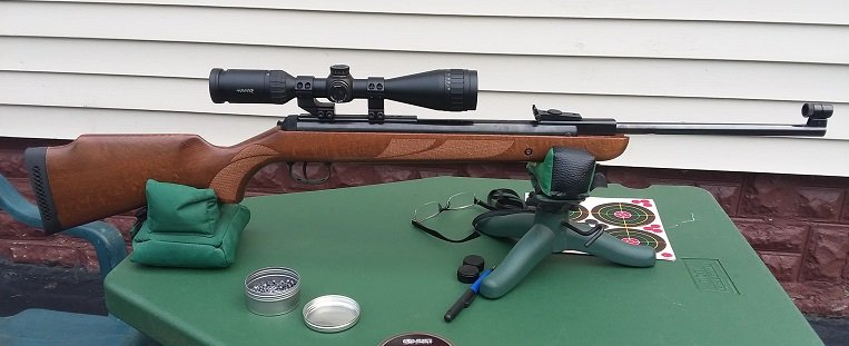

My D34K Premium .20 caliber:
Found this when I tore it down the first time.

Buyers had the choice to have custom work done before they took delivery, but I was told Mr. Quigley wanted nothing done to them, so if true then yes, that seal was installed at the Diana factory.
And yep, it's not just Hatsan. Seen any number of shooters over my 7 years on forums who bought different brands of rifles and said they got guns with banged up seals in them. Hatsan, Weihrauch and Diana are just a few of them.
