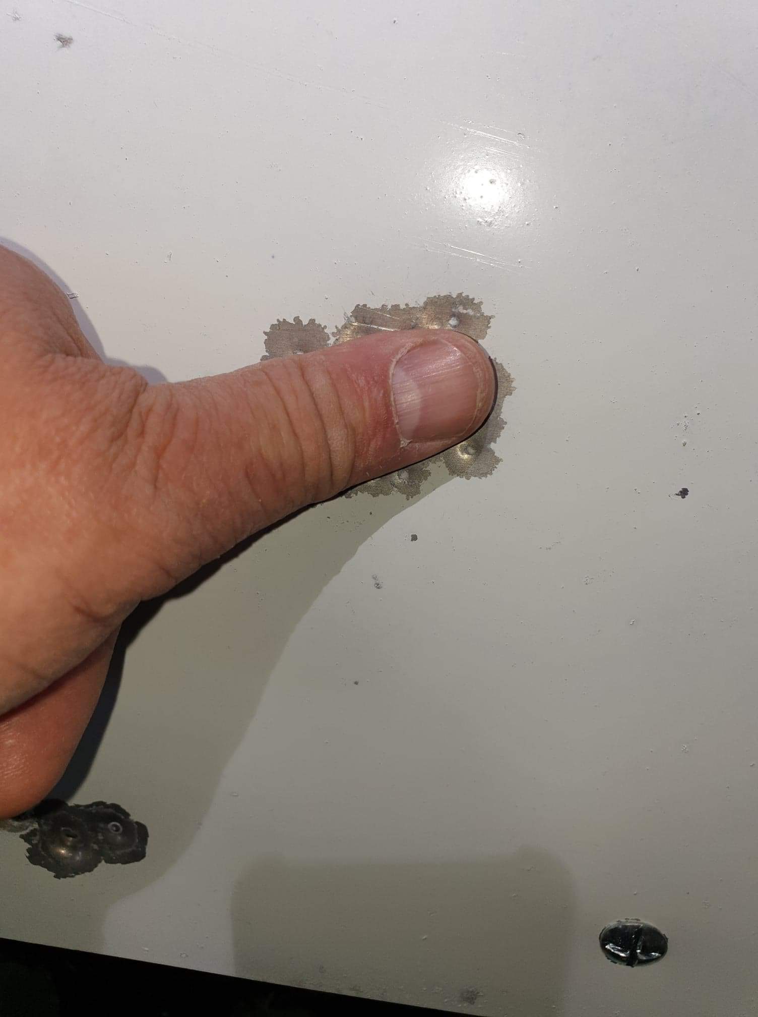

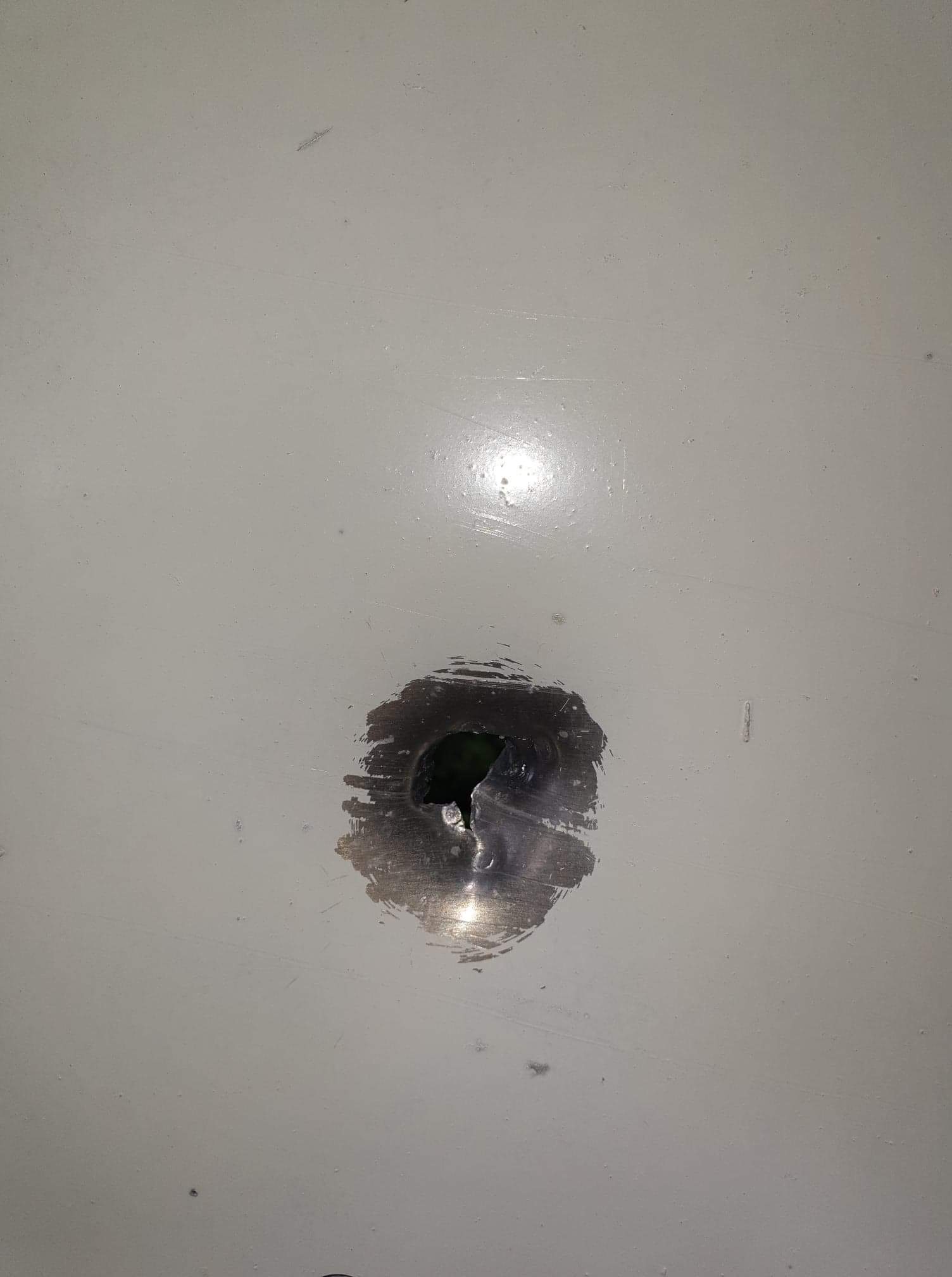

I would disagree about the raw not being tuneable I bought my Raw HM1000x as a std sub 12 uk spec rifle .The first thing I did was pull it appart .
It was always my intention to do so as I have the fac required in the uk to do so .
New valve well an older Martin valve
New polygonal 24 “ barrel 1/2 unf thread and blued
Hammer and valve spring set
Adjust the reg to 150 bar
And do some hammer work
Replace the awful pistol grip with magpul and the buttstock with an mdt lss
The gun does like the 25 grain jsb but it also likes slugs
I have a Corbin swage press so made slugs from 20 grain all the way to 30 grain and shot each at 50 and 100 yard
Unfortunately it has been windy on the days when I tried them but 25 grain at 950 to 970 fps works really well 1 1/2 group at 100 yard

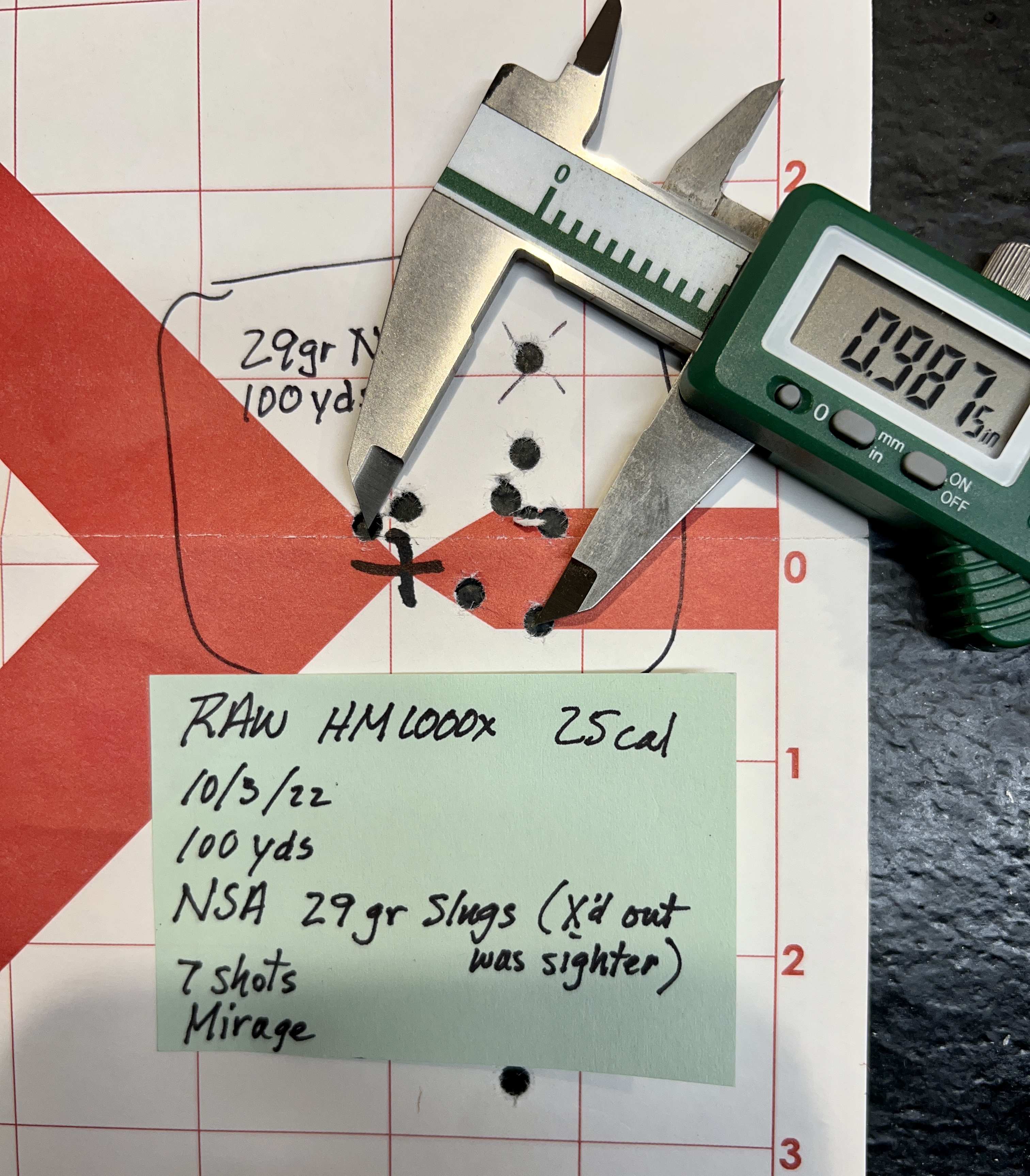

Not sure I agree with the comment on not being a slug gun. For instance, this is my 25 cal HM1000x at 100 yards with mild wind and very heavy mirage (under moa) and NO adjustments to Martin's tune for JSB Exact 34 grain MKII:
Maybe the .25 barrels are better with slugs? In the .22 the slugs are no where near that. Generally speaking a fatter and shorter slugs are a bit more tolerant to low twist rates of pellet barrel. However key to awesome accuracy especially with slugs is a very efficient tune and thanks to the heavy hammer all the factory RAWs I've seen all have the valve open too long hence how loud they are.
Regardless its takes some work to get even an easy to tune FX gun to shoot slugs under MOA. However the RAW/LW ploy barrels are known to shoot certain pellets well so I do understand why some say to leave a good shooting gun alone. It certainly is NOT EASY to tune but with know how it can be done. With out parts enabling easy tunability has in part to do with great consistency desirable in a dedicated target gun. But not sure if OP is looking for a slug gun anyways, most RAW owners I know are not looking for a slug gun.
You found a slug that shoots pretty well as the gun came which is great. But can you tune the gun to shoot the newest high BC/heavy slug? Maybe? It certainly won't be easy!
Regardless its takes some work to get even an easy to tune FX gun to shoot slugs under MOA. However the RAW/LW ploy barrels are known to shoot certain pellets well so I do understand why some say to leave a good shooting gun along. It certainly is NOT EASY to tune but with know how it can be done. With out parts enabling easy tunability has in part to do with more consistency desirable in a dedicated target gun. But not sure if OP is looking for a slug gun anyways, most RAW owners I know are not looking for a slug gun.
You found a slug that shoots pretty well as the gun is which is great. But can you tune the gun to shoot the newest high BC/heavy slug? Maybe? It certainly won't be easy!

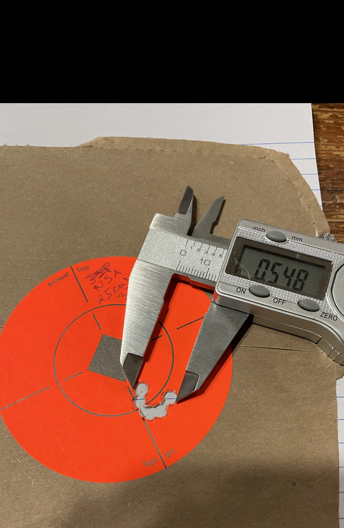

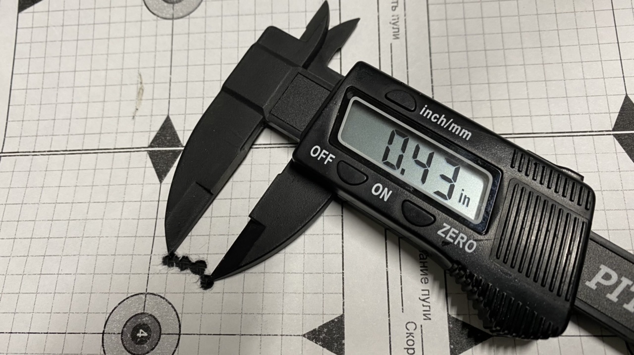

25 cal NSA Slugs 33gr. 100 yards. Haven’t been able to duplicate this results but definitely under an inch at 100 yards.
This rifle is boring accurate 🥱🥱
Reactions: qball and rsfrid
I haven't tried many slugs, so perhaps that might work in mine. I agree with your last statement.

EDIT: BTW you short changed yourself on that group, C2C is certain .5 inch or even a little under. Great shooting.
