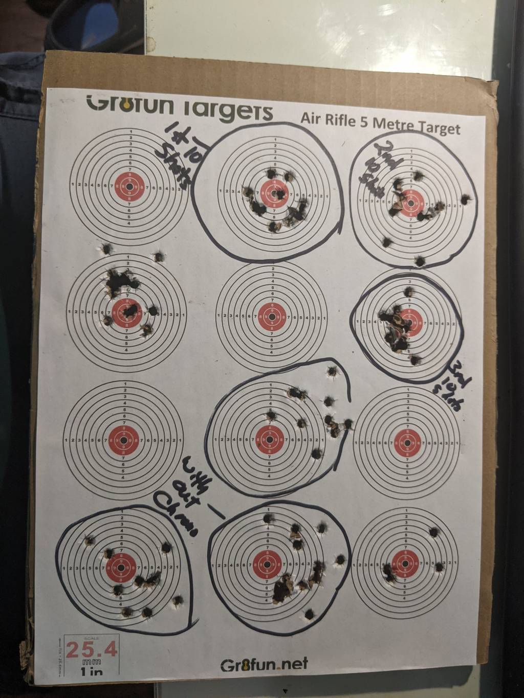

Alright, Got this Hatsan FlashPup going. Regulator at 145 JSB Exact King 25.36 @ 830FPS, ES 11 SD 5 for 20 shots. Can't say enough good things about Hatsan service. Took about a week and half of back and forth email to get the new barrel shipped even though I had installed the Huma-Air Regulator. I'm pretty happy with Hatsan and the FlashPup.
The pic is 20 shots at 20 yards
