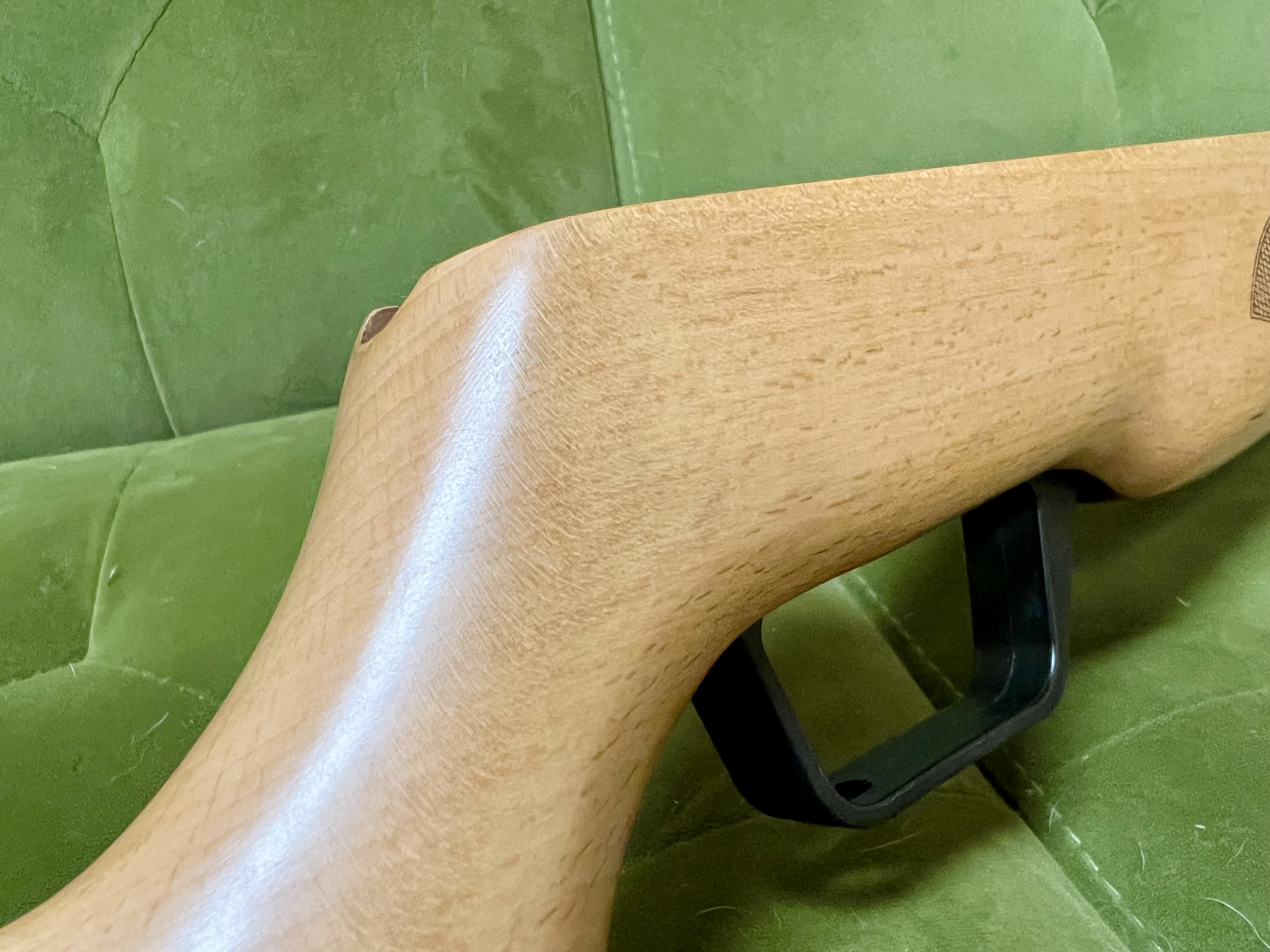

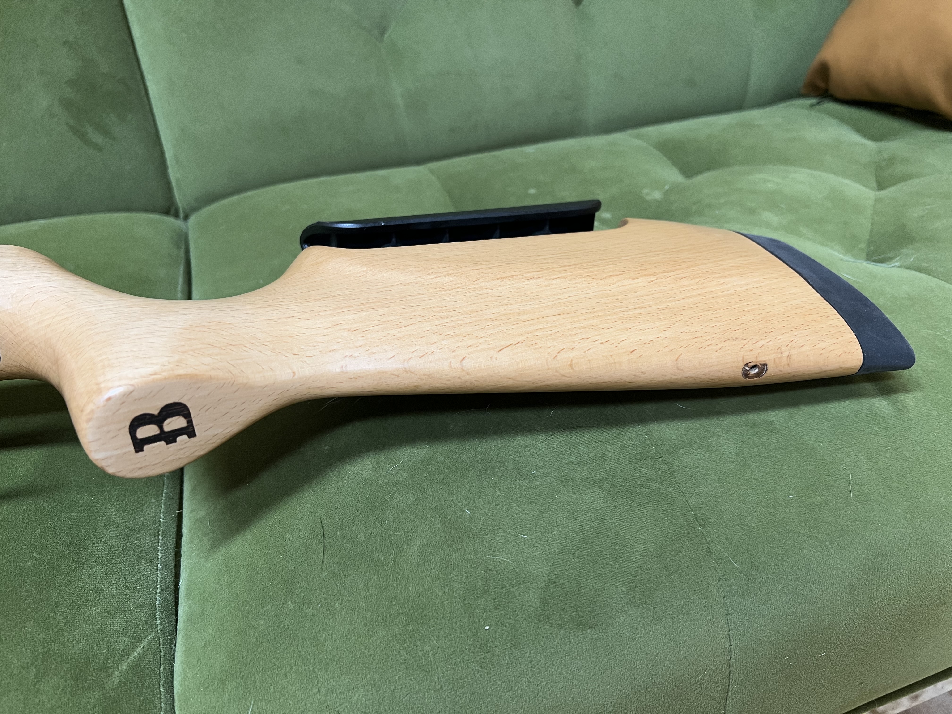

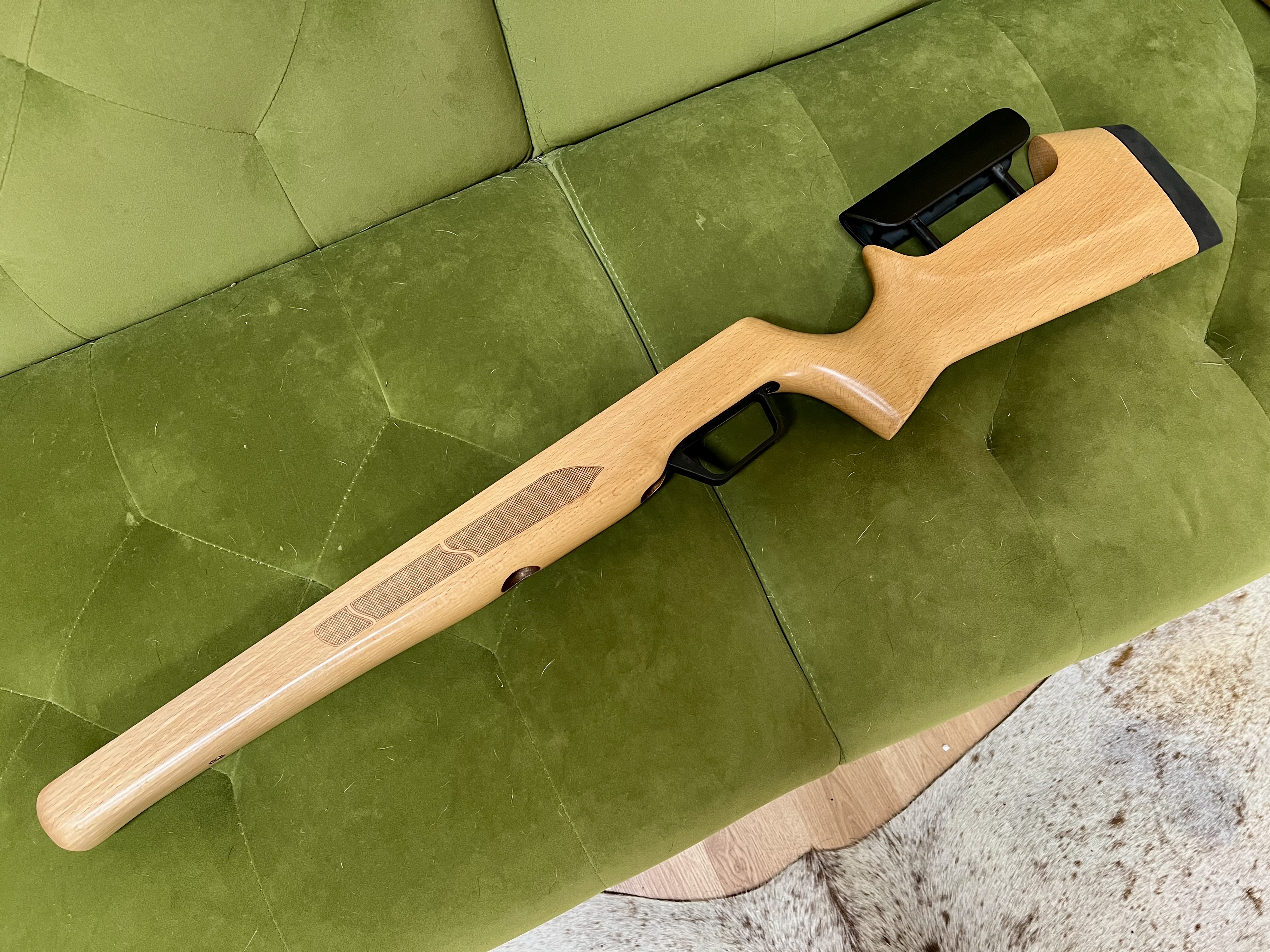

Tunged a Blonde Beech

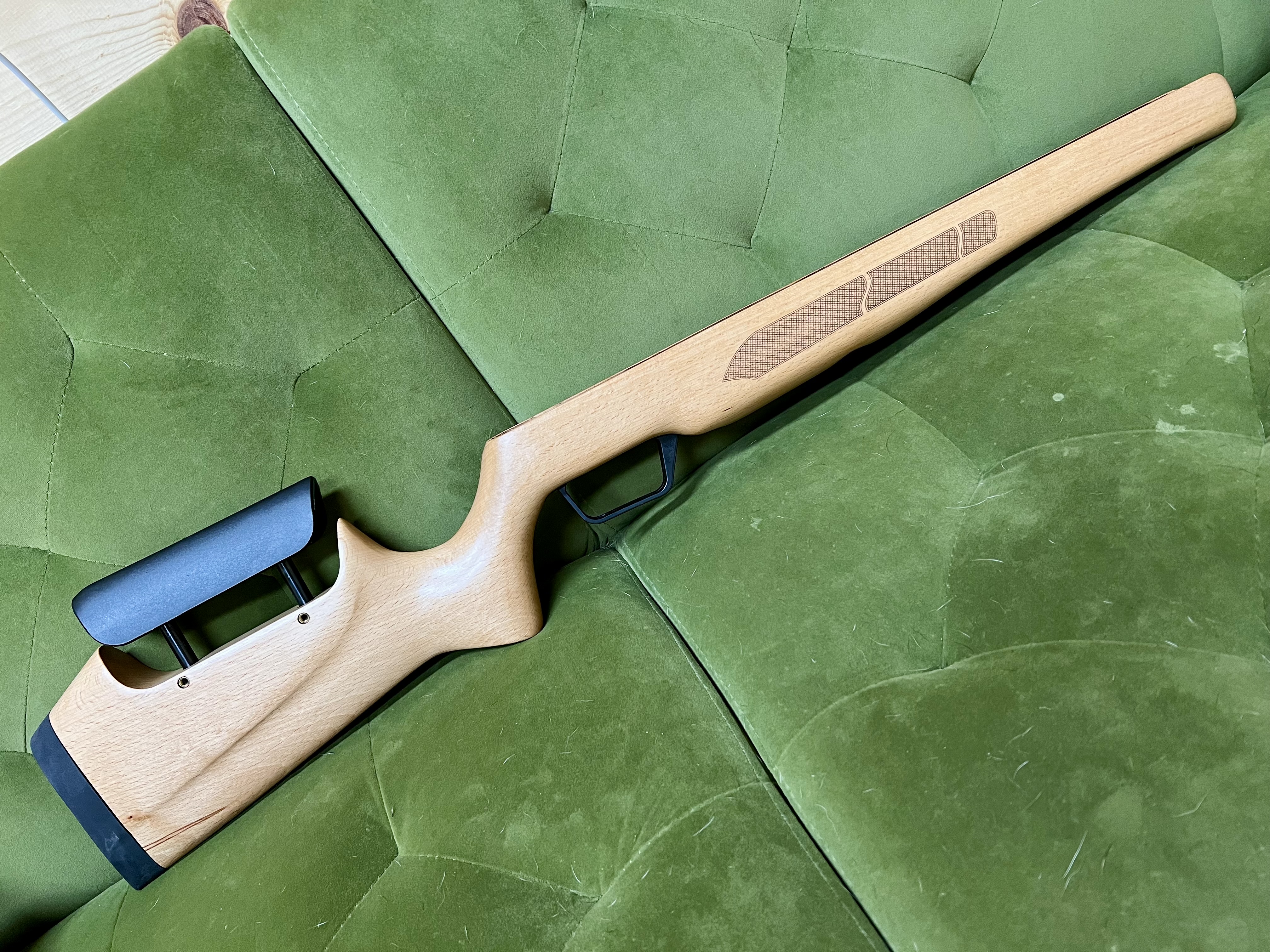

Benjamin sent me a stock with scratches. I used a razor blade to scratch off the thin & terrible looking finish and then followed up with sandpaper 180g. (It was this dry method vs Citristrip. Glad I did this dry)
This process revealed a beautiful beech wood stock with the tightest grain I’ve seen on a piece of wood. I did 3 100% Tung oil applications, doing a UV open air cure on the last thin coat of tung oil. This produces the hardest finish I’ve discovered with just a nice glow sheen.
Dang that looks amazing, nice job. What are you using for a UV source?
The Sun. lol
70-75F. afternoon when UV is higher. 45-1hr per side exposed to sunlight.
Above 80F. 30 min per side.
I discovered this with tung oil 8yrs ago when I sat some axe handles out on the back deck to dry. I noticed the side facing the sun hardened, so I rotated them and those axes have been used frequently ever since and when I clean them up, you would think I never used them! So, I did this to all my gunstocks.
Man that's a Beautiful stock great job. (y)

Thanks! It was so tight grained it looked and felt like 800g finish. I had to 180g in an attempt to open it up so the tung could get some hold. I doubt it would take stain or evenly. It didn't take the finish Benjamin used as it was blotcy and swirly and came off easy. I like the lower sheen finish on guns. Most of mine are milsurp finishes with a bit of egg shell, so this is as shiny as I want.
i think this solves making Beech look like Walnut, just let it be what it is
Feinwerkbau has had blonde stocks for years in Laminates or solids

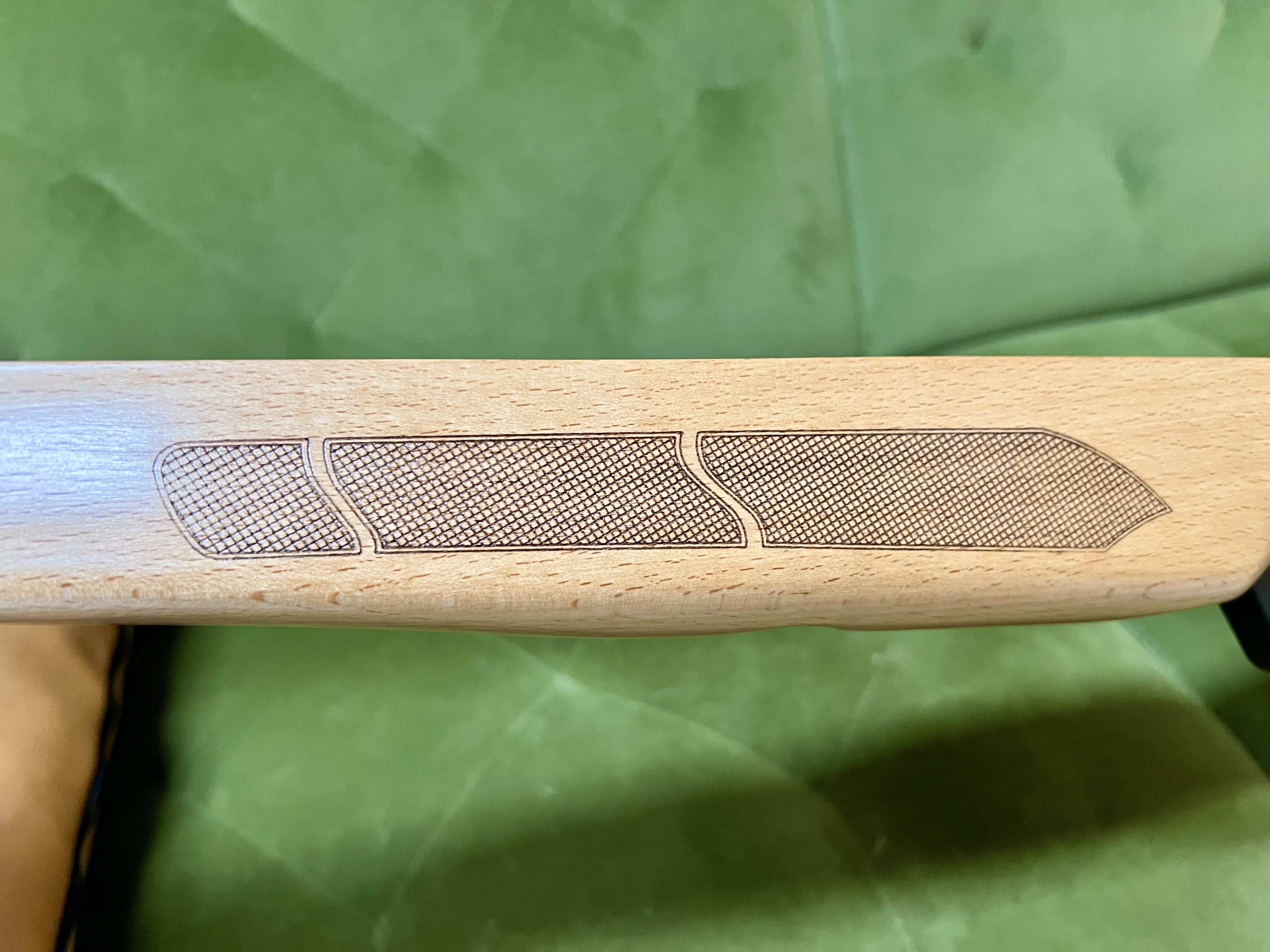

i like the way the stain left highlights the checkering
A pro for using all dry stripping technique. The citristrip would have taken everything off. I like the contrast it leaves too!
One of my old FWB 124d rifles got scratched years ago so I did similar. It was already finished with I guess a tinted lacquer over some stain. I sanded and sanded. and had to go with one of the ultra fine sandpapers to get it smooth enough to take stain and oil and not look muddy in spot. That was probably over 40 years ago, It stll looks good. Beech can be made to look good, but it does take a lot of work. I have one Swiss K31 with a beech stock, that is blond like your Benjamin, looks good also. I also have another couple of blond stocks, A Swedish Mauser and a Yugoslav Mauser, but those are both elm stocks.

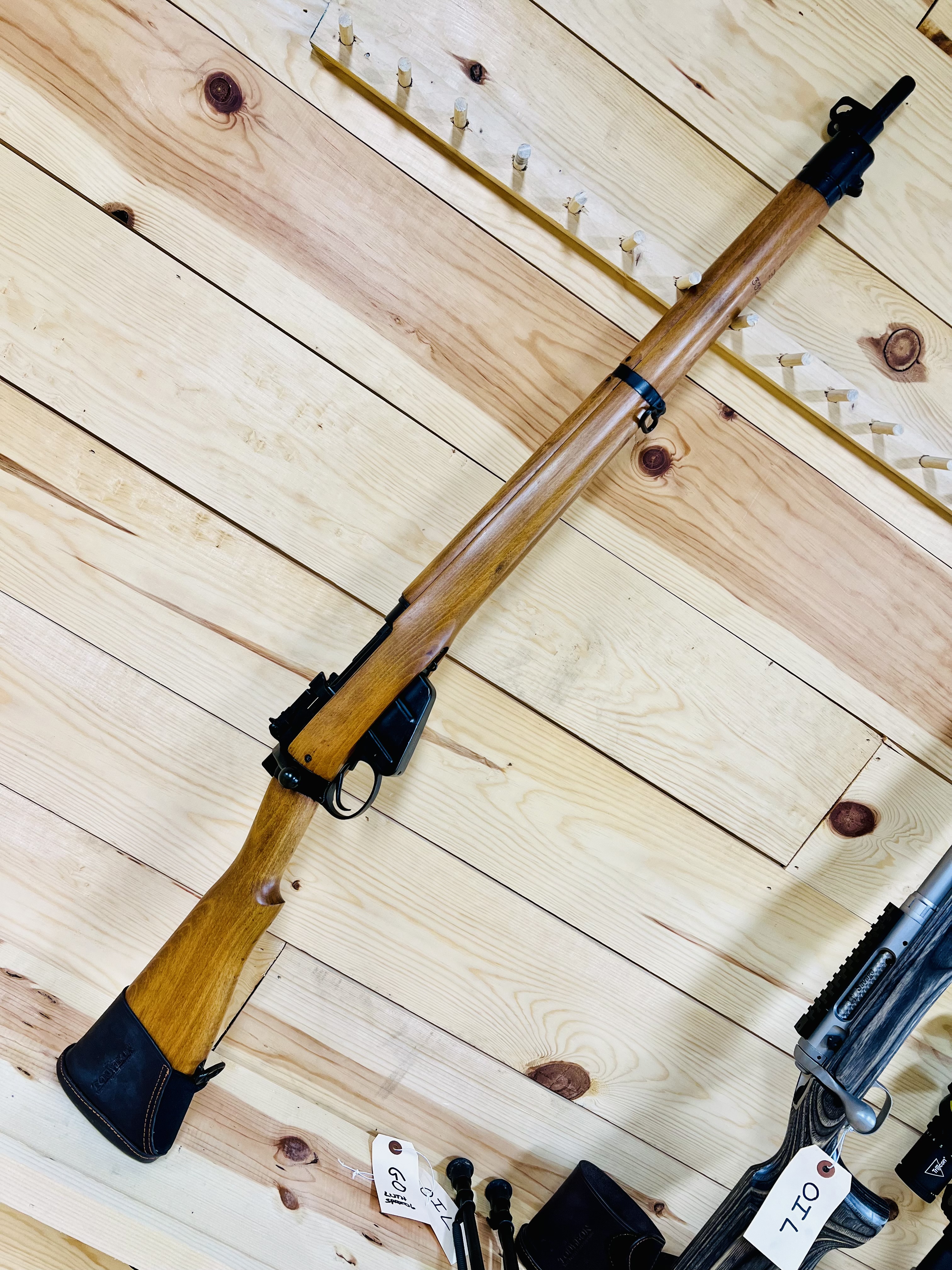

My New in wrapper & cosmo Enfield No4MK2 Irish contract blonde beech!
